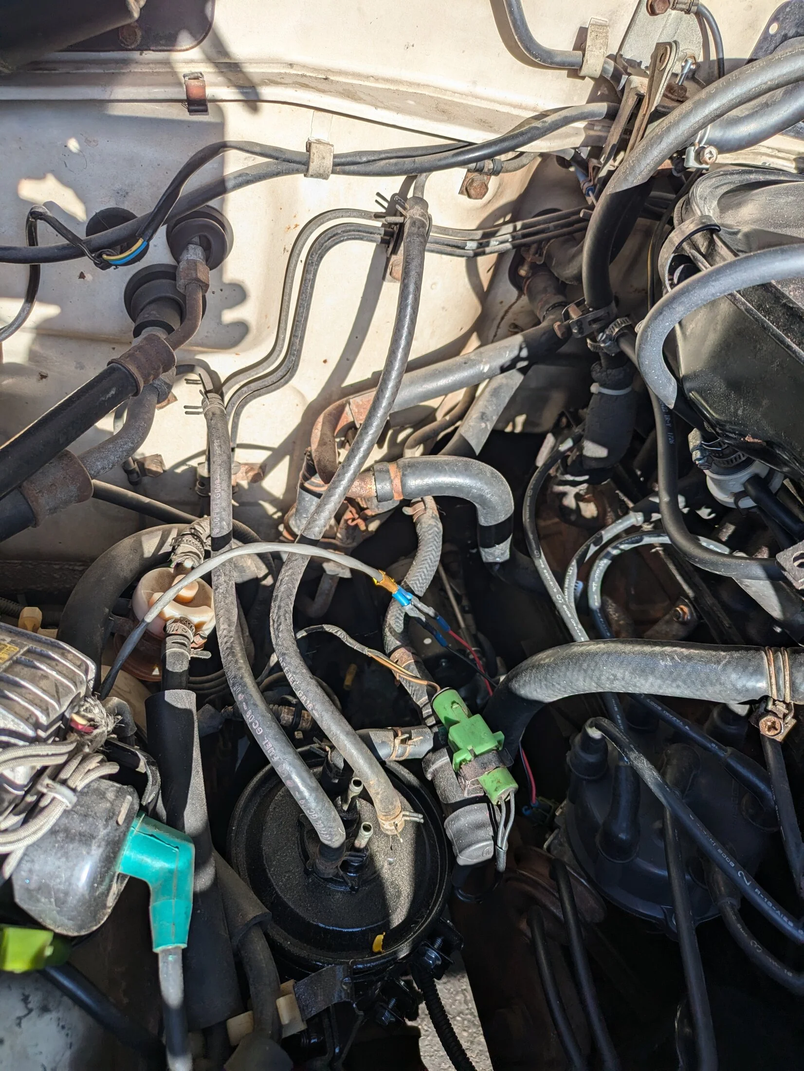

1984 FJ60 new OEM carb, rebuilt OEM distributor. Fuel starvation issue
May 10, 2024
6
68
Salt Lake City
When I disconnect the charcoal canister the fuel starvation issue ceases.
I can feel suction from the hose that's seated higher in the firewall but no suction from the lower hose.
I'm trying to figure out what my next steps are to figuring out exactly what's broken.
There shouldn’t be any suction from the ventilation hose that leads back to the carburetor from the charcoal canister when the engine is idling.
The forced EVAP system shoud only be actuated when the gas pedal is pushed down a bit while driving. Never at idle.
