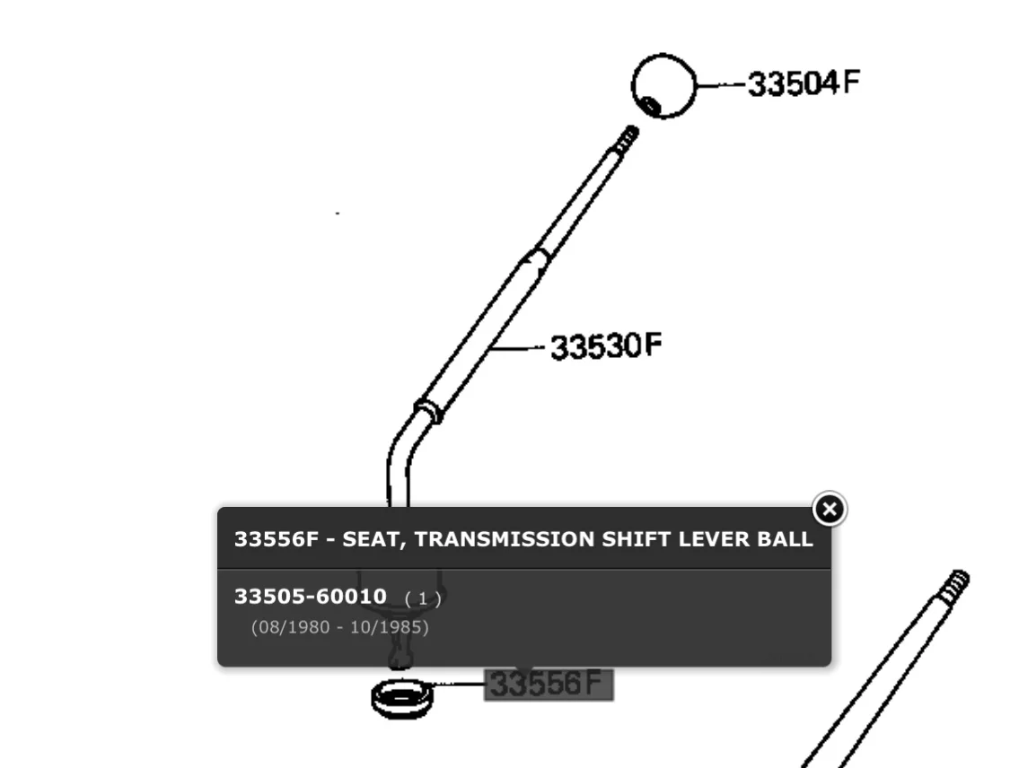

All USA FJ60s had a 4 speed transmission originally. Guys have installed the 5 speed (H55F) separately much later.
If yours is a 4 speed, you may likely only need the shift lever seat.
(Shown as 33556F in the drawing)
TRANSMISSION SHIFT LEVER BALL SEAT
33505-60010

Thanks for your responses. I've found a drawing of a 5 speed shifter as well. My friend has a 5 speed sitting out on a farm, that has a working transmission(my 5th gear is broken)

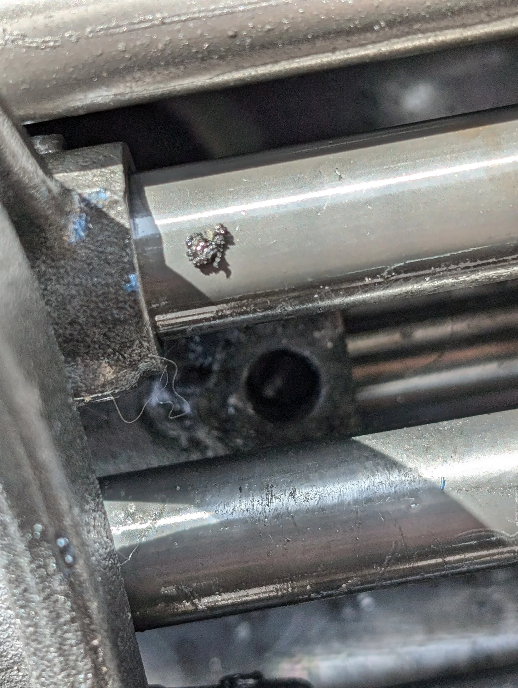

Upon further inspection i've noticed that there maybe a bolt or pin missing between the part that connects from the shifter and the rest of this gearbox, which would help make sense why the shifter is limp. would i be able to get something welded in here, or replace the bolt if this is the issue? I don't really see any threads on it.
Thanks!

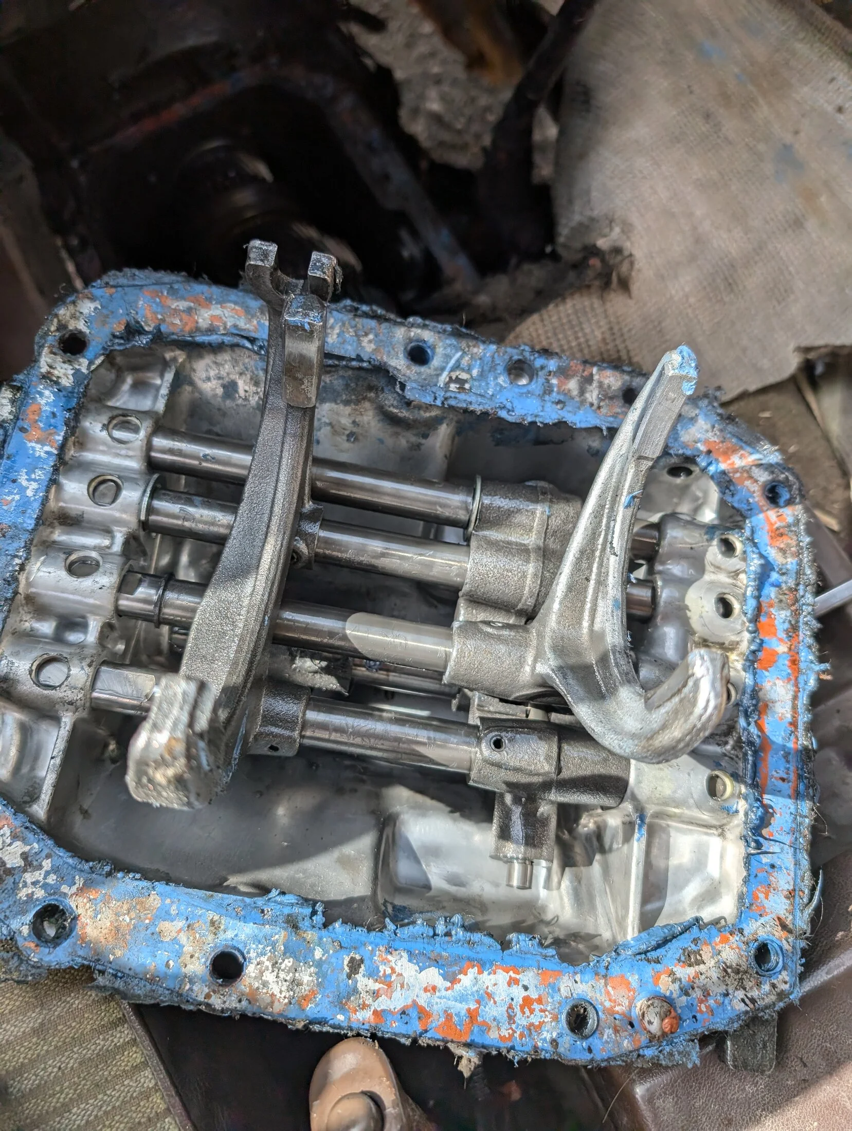

I’m not sure what you’re talking about, but the neck of the top cover of the transmission has two dowel pins in it to hold the shift lever. See picture.
The plastic ring is probably the white nylon bush on the end of the shifter - looks like it is stuck in the shift head, does not look to be broken to me.
That missing bolt will mean the shifter moves around freely without moving the shafts / forks. It's a high tensile bolt and should have a lock collar, though I would go with a threadlocking fluid when re-installing.
The rest of the cover/shifter assembly looks fine to me.
The question is if that bolt has done any damage to the rotating assemblies - you certainly want to retrieve it before putting the transmission together.
Aside from the botched sealer job on the top cover, the transmission looks clean and low mileage.
