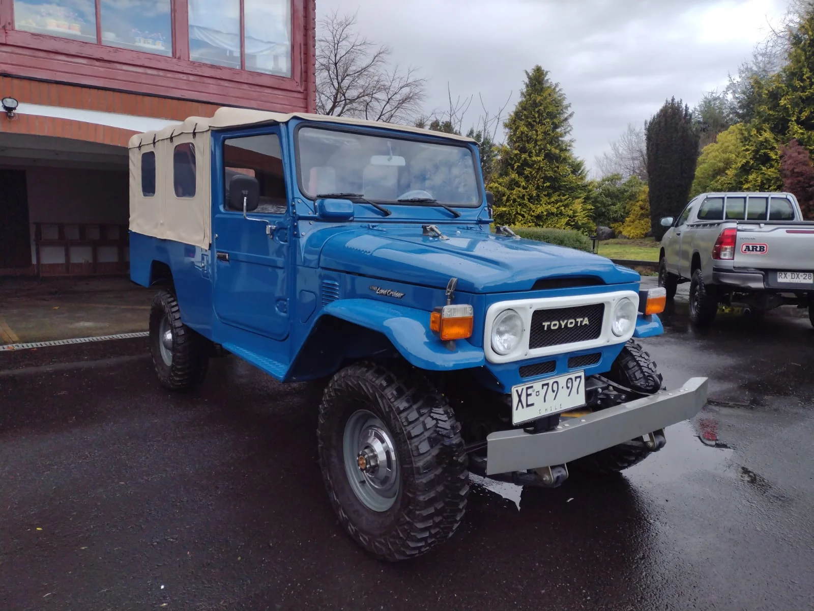

I am having a very specific issue with a nearly finished project 45. As in its finished but the temp gauge is not working properly.
The truck can be started cold and if you run if once the choke is off and give it gas and rev it up the temp gauge will rise very quickly to full hot, even tho its still very cold.
We have tried different temp sensors with the same result.
We bought a new Gauge cluster, OEM brand new Toyota cluster and the issue persist.
What am I missing? It is not overheating, the coolant system is working perfect. The gauge appears to be responding to throttle response which I'm assuming has to do with charging volts when revved - or something else that I am overlooking. I've read the gauge cluster thread and could not find any mention of this type of issue.
Any help would be appreciated, This is the 45. This is the last detail before its totally finished.
