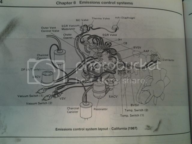

Now just need to figure out how ti adapt newer 4 wire round plug to older 2 wire
and hacked harness
One wire was manually crimped to this, which has 2 wires in new plug.
I saw a thread somewhere
Just gotta find it
4th wire (B) vents fuel vapor from bowl to cannister, and returns it later to be burnefd. Ignoring it for noe(no cannister)

Saving this Thread because it shows how to hook up the Vac lines to the Dist, which was not hooked up on my truck.
