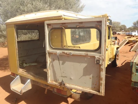

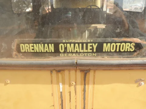

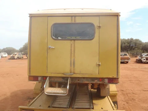

a little of the history of the aussie arkanas was written in another thread i just bumped; but in short they were made new in perth western australia on an fj45 chassis. the entire 45 tub was retained and the sturdy arkana body attached behind. mostly they were painted mustard yellow. the same company also made duel cad 45s, ambulances, police paddy wagons; that sort of thing.

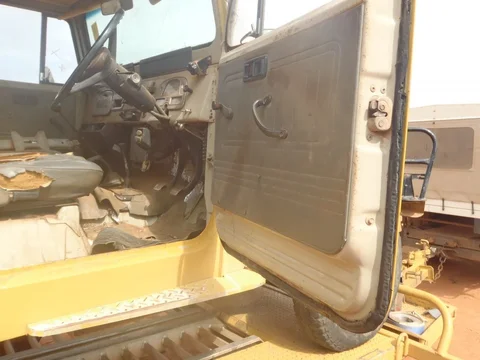

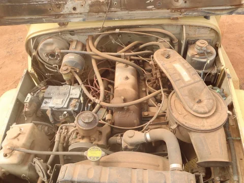

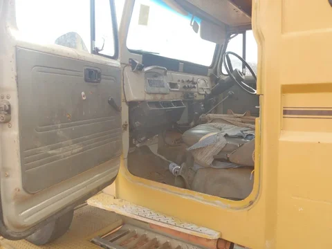

this is a really interesting landcruiser, and if we can ignore the front a while longer, is as straight as they come.
its straight as, rust free, and desirable. except for this bit. this thing has run up a stump. hard.
i spent a lot of time under this thing and am convinced the damage does not extend further back than the front crossmember. at some point (still studying this) has had power steer fitted and this removed the old steering idler arm that normally nestles into this corner. it made it a weak point; and you can see where the stump hit!
right guard, bib, bonnet and bonnet hinge are all a bit bent. spring shot of course and some the steer gear needs replace. steer wheel and windscreen have taken a shirtfront and headbut respectively. and the right front chassis horn is what you see. everything else is pure original niceness.
i think this chassis horn is repairable for someone with the right skills. otherwise a body swap onto another fj45 chassis (or even better a hj45 or hj47 and make it a period correct diesel. im sure this motor will run fine. havent tried this yet but wont be able to help myself for much longer. fan is currently touching the fan shroud. even the radiator and engine mounts seem to have survived this hit.

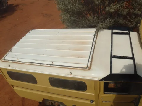

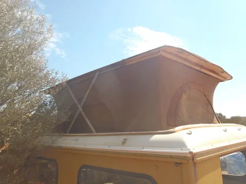

Henry old boy, be very very careful not to trap a tree branch when closeing up roof (post #5 pic2) as when you drive away you may rip the pop top right off
Why am i so worried you may wonder, was once eyewitness to such an event with some german packpackers at a hippie festival

thanks for the heads up catskinner haha. discovered my mistake hen i climbed on some 'scaffolding' to get an overall roof pic.

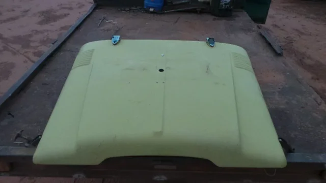

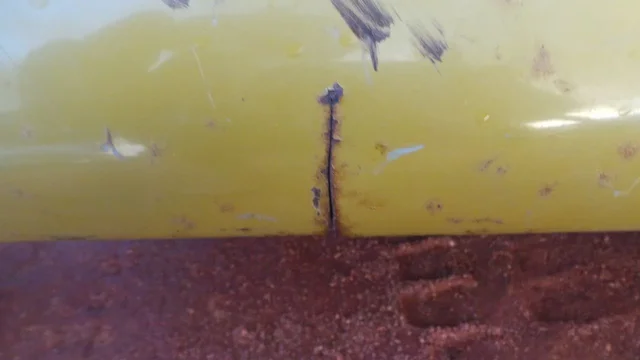

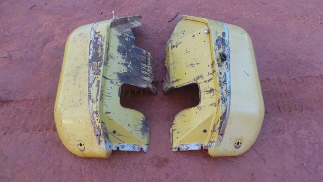

anyway still pondering this. shes stashed away but had a couple of wins. tripped over these pair guards in a coastal scapyard. these are mint; straight as, rust free and original yellow paint. a little fatigue crack on the right guard.
which begs to ask who would scrap these? he either has no idea or no cruiser mates. i presume both. anyway haggled with the scrap dealer and we settled on $5 each. i couldnt gat my money out quick enough! (rare for me!). bloody win! theyre even the right colour.

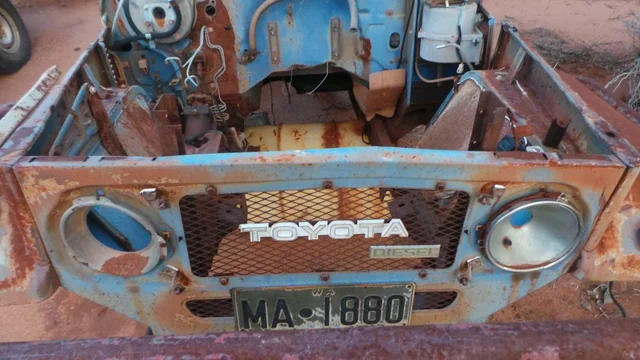

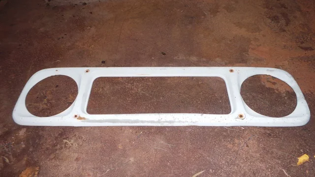

i also have this 47 bib and sidepiece to hand. bib has a top dent from a rollover (my fathers) but will straighten up and is rust free. need a bonnet now. heck i might even get excited and get a knowledgable mate to spray a bit of mustard yellow around (not the guard just the other bits)

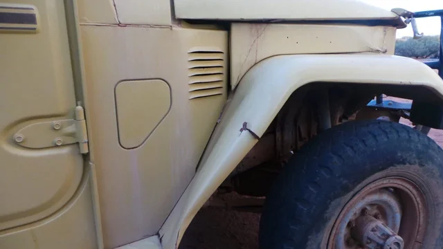

damage on the arkana

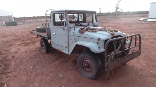

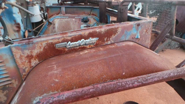

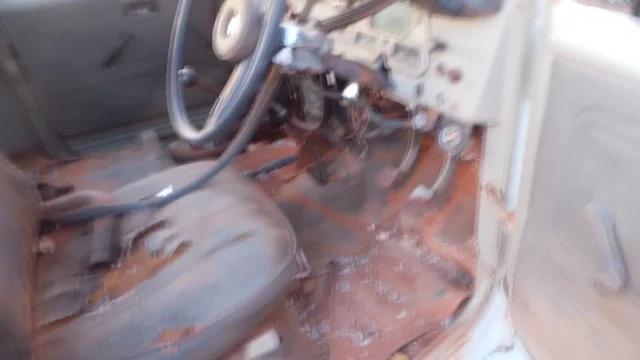

my mate also recently collected this at the right price. hj45; rustier tub than it looks in this pic.
we swap cruiser parts in good humour but dont know why he didnt unload this at my scrapyard. explained him the error in his thinking and will prob go collect this. has a good steer wheel, nice enough door skins (tho the arkana are pretty good) and best of all - a really nice floor mat. also hard to see in this pic. could be a donor chassis?
