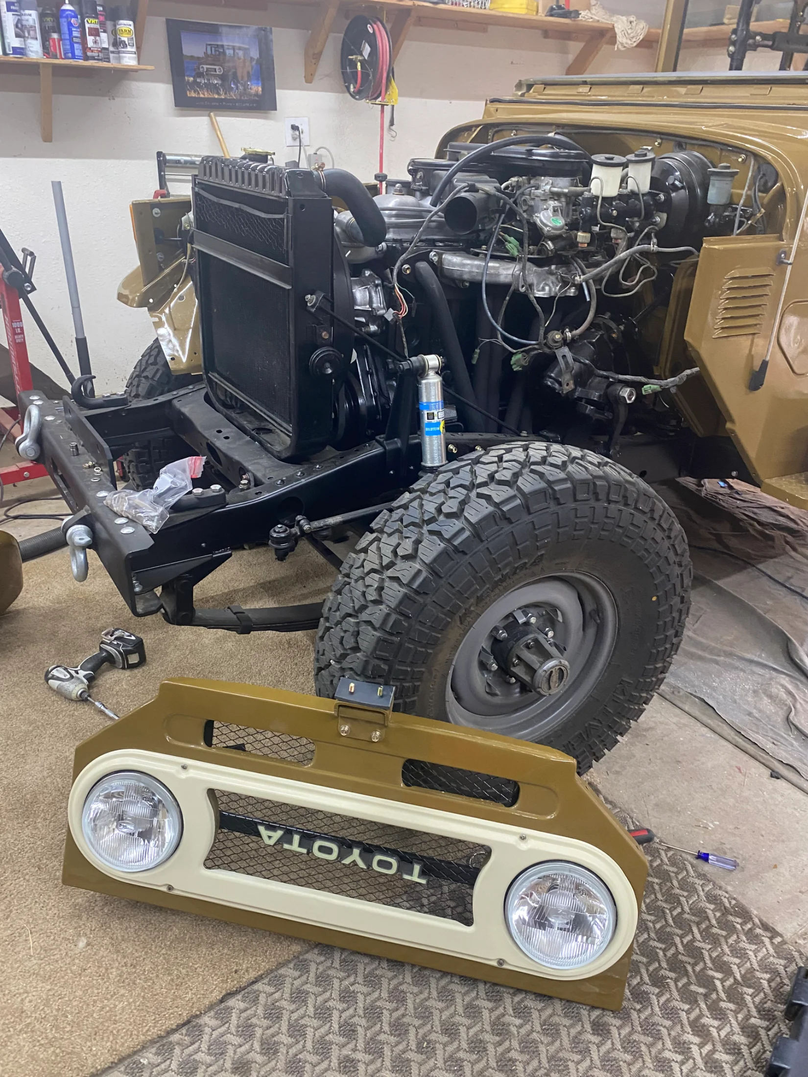

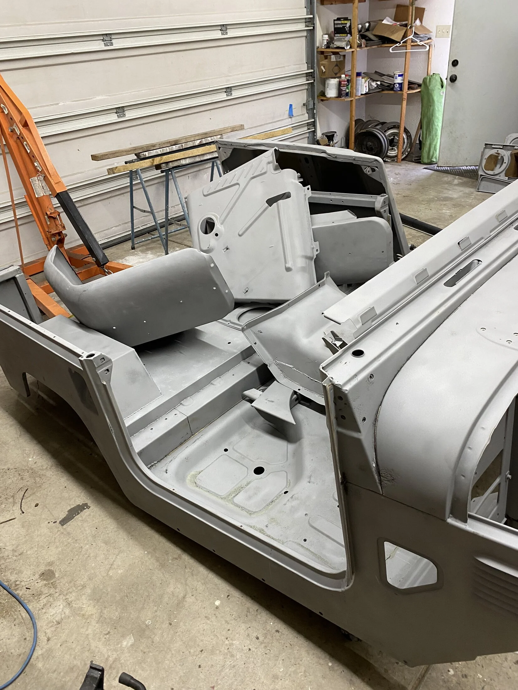

Alright, everything is reassembled. I have a handful of hoses to replace but otherwise wil be getting back to the tub.

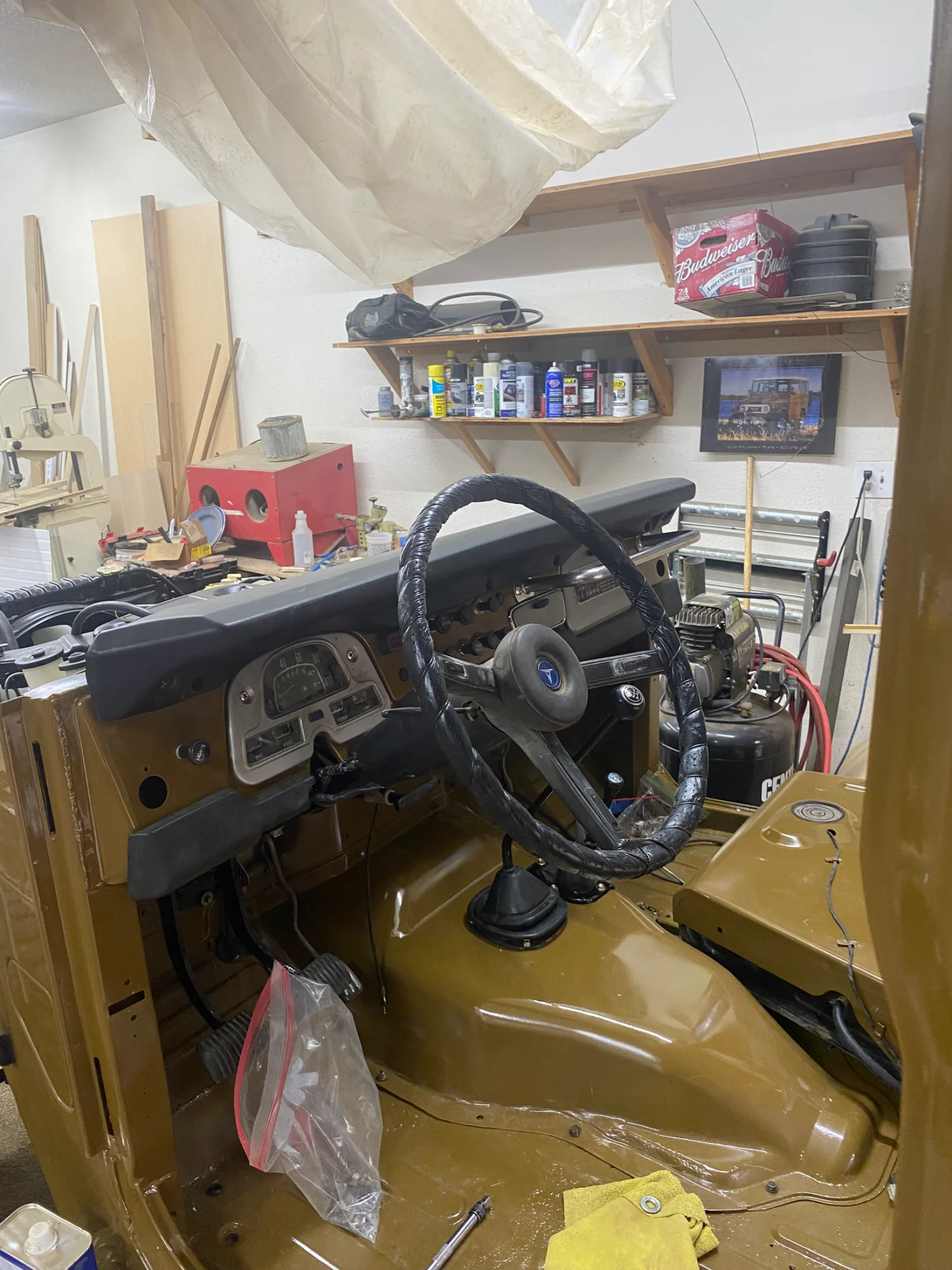

As she sits now:

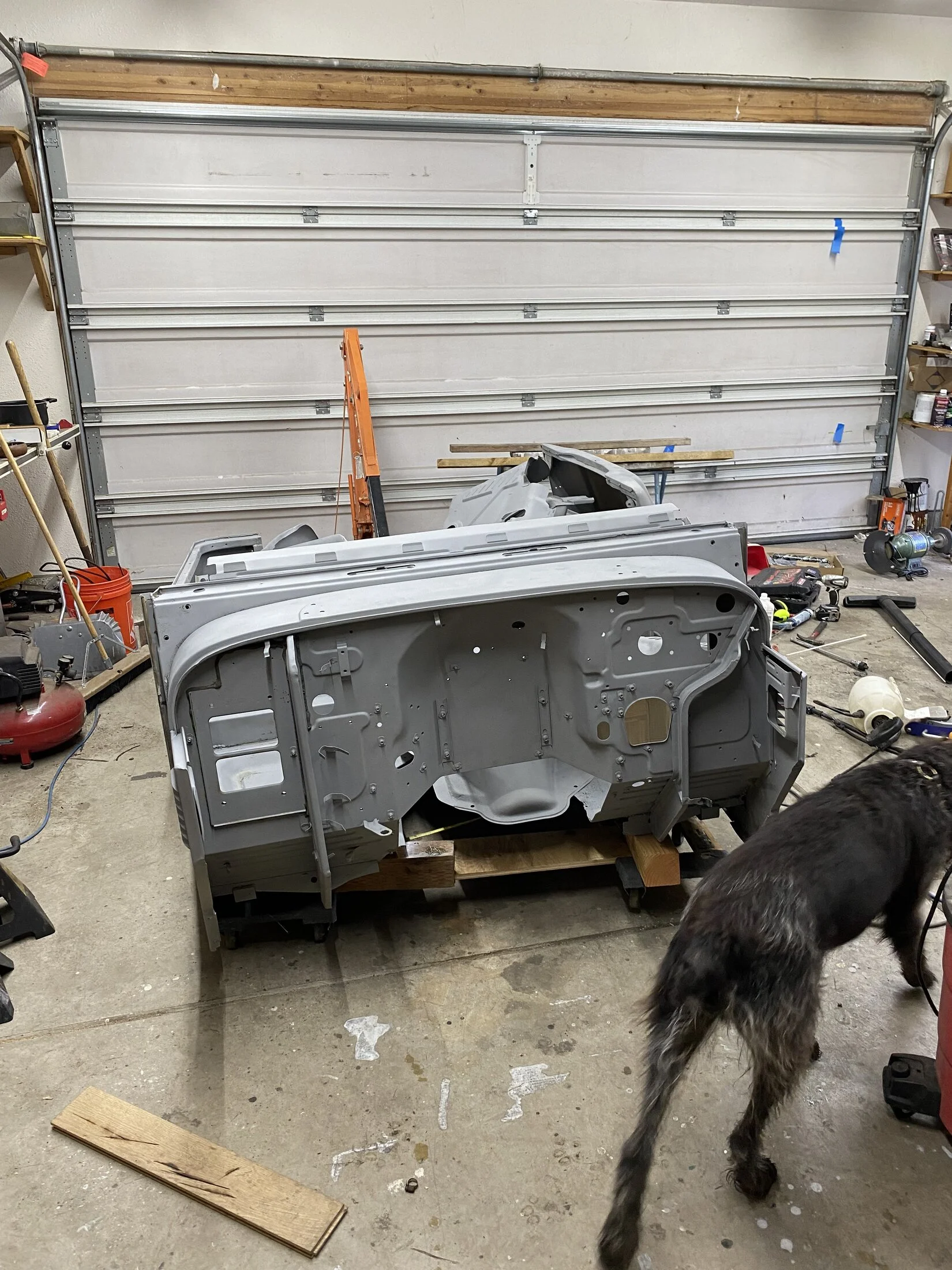

This tub was rebuilt at some point. I was rolling around under the tub a while back and noticed a gap between the rocker and the floor pan. What is this supposed to look like?
And this joint between the back and front halves will need some help.

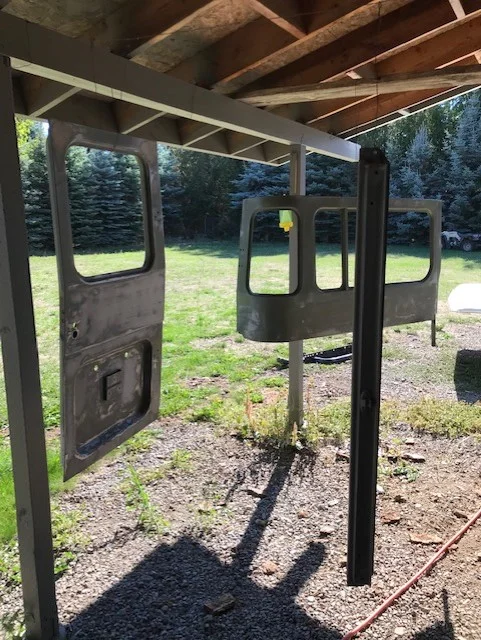

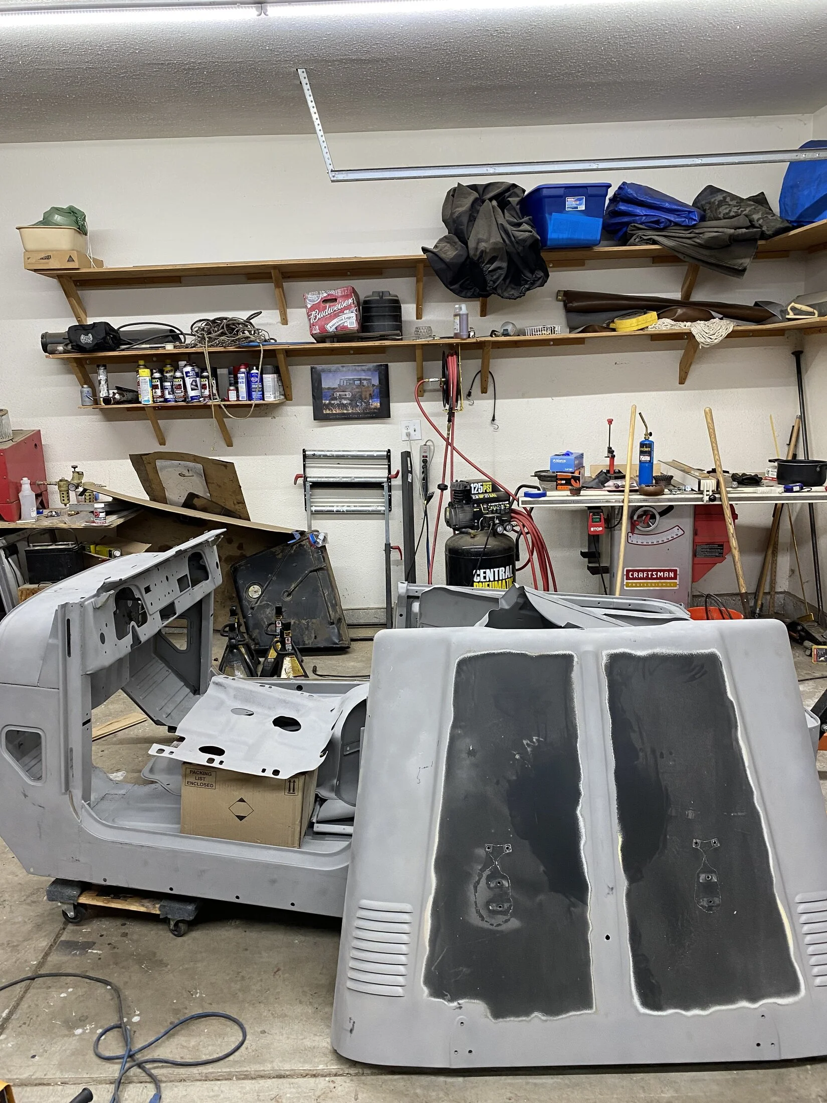

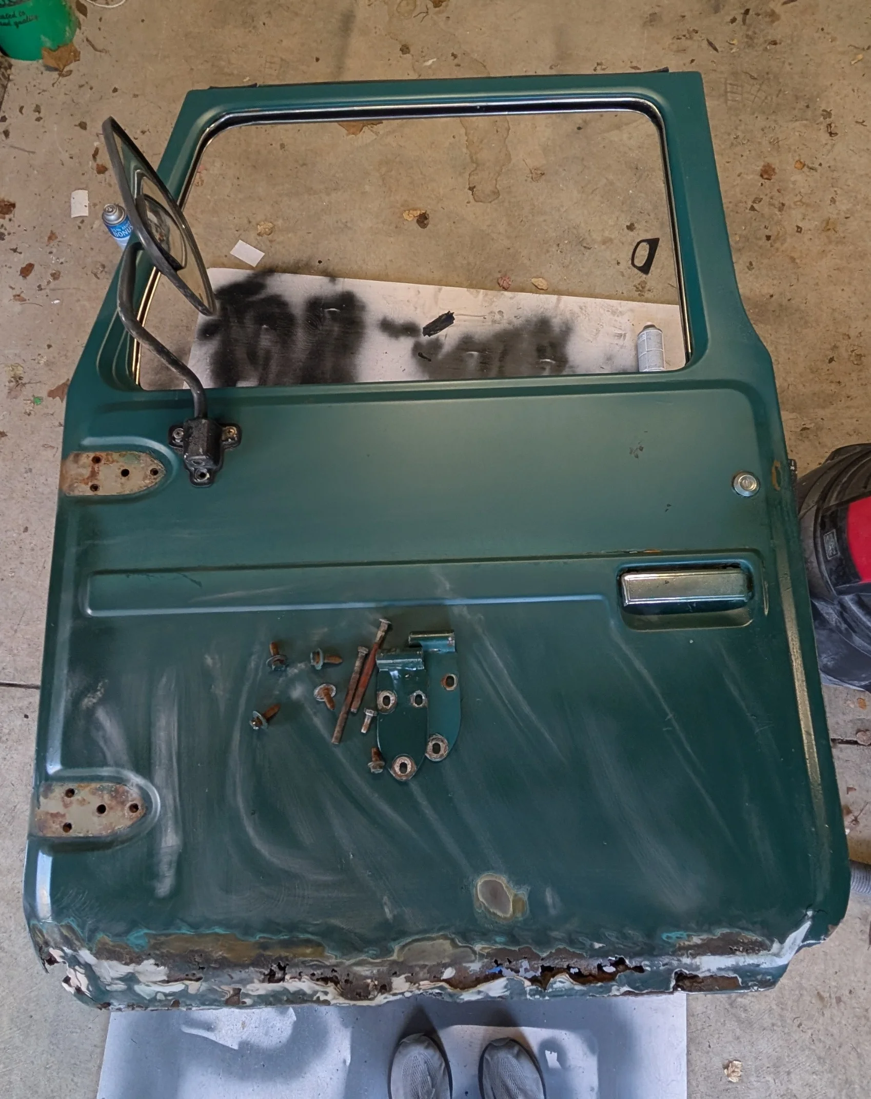

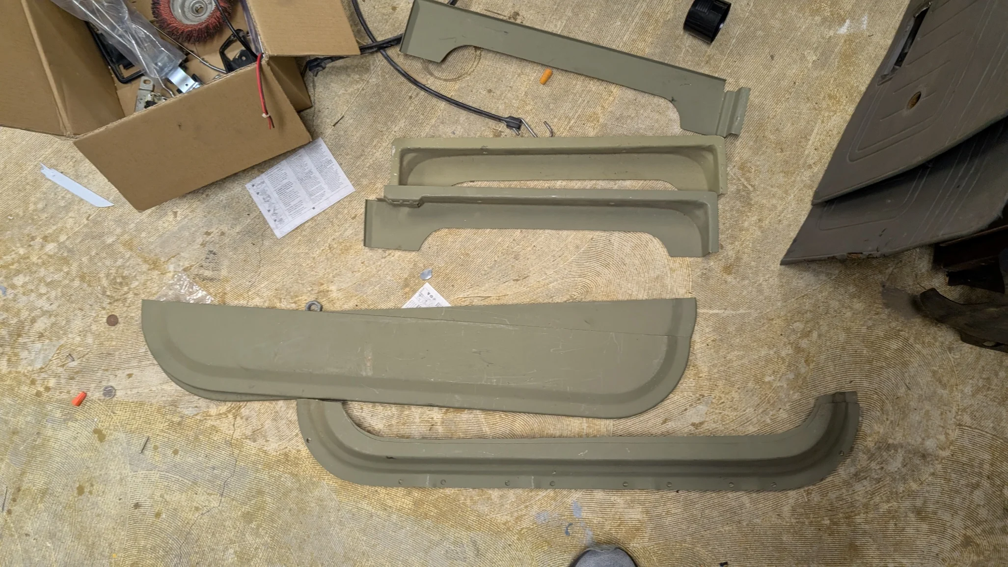

The door patches turned out pretty decent. The patches weren't exact fits but a few blows with a BFH made them fit better. Mind you, I am not a welder, but with enough time and patience it can be done.

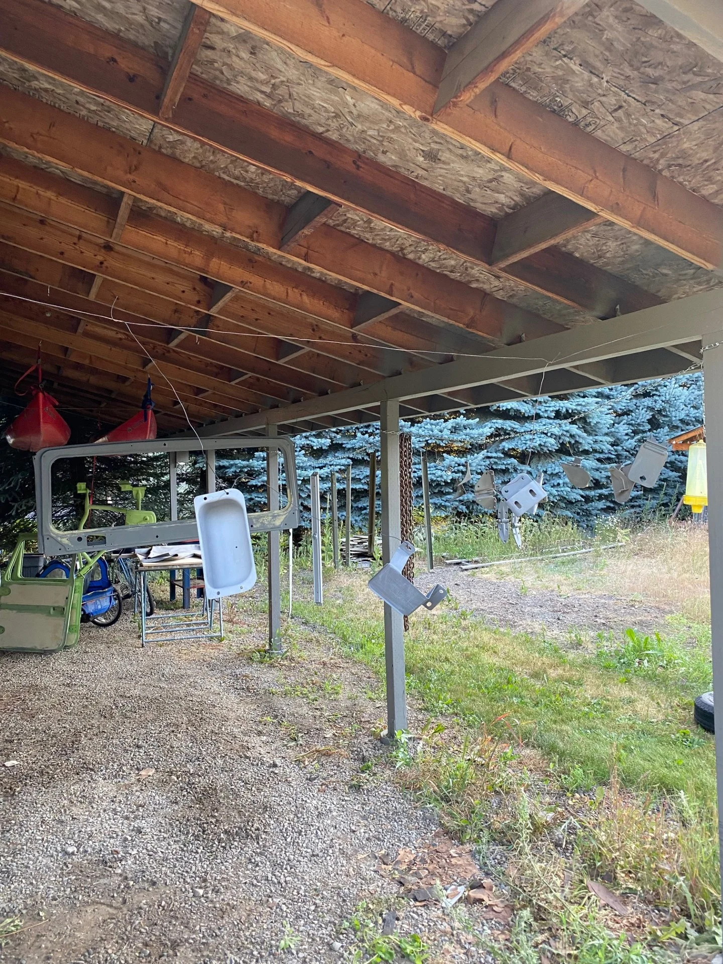

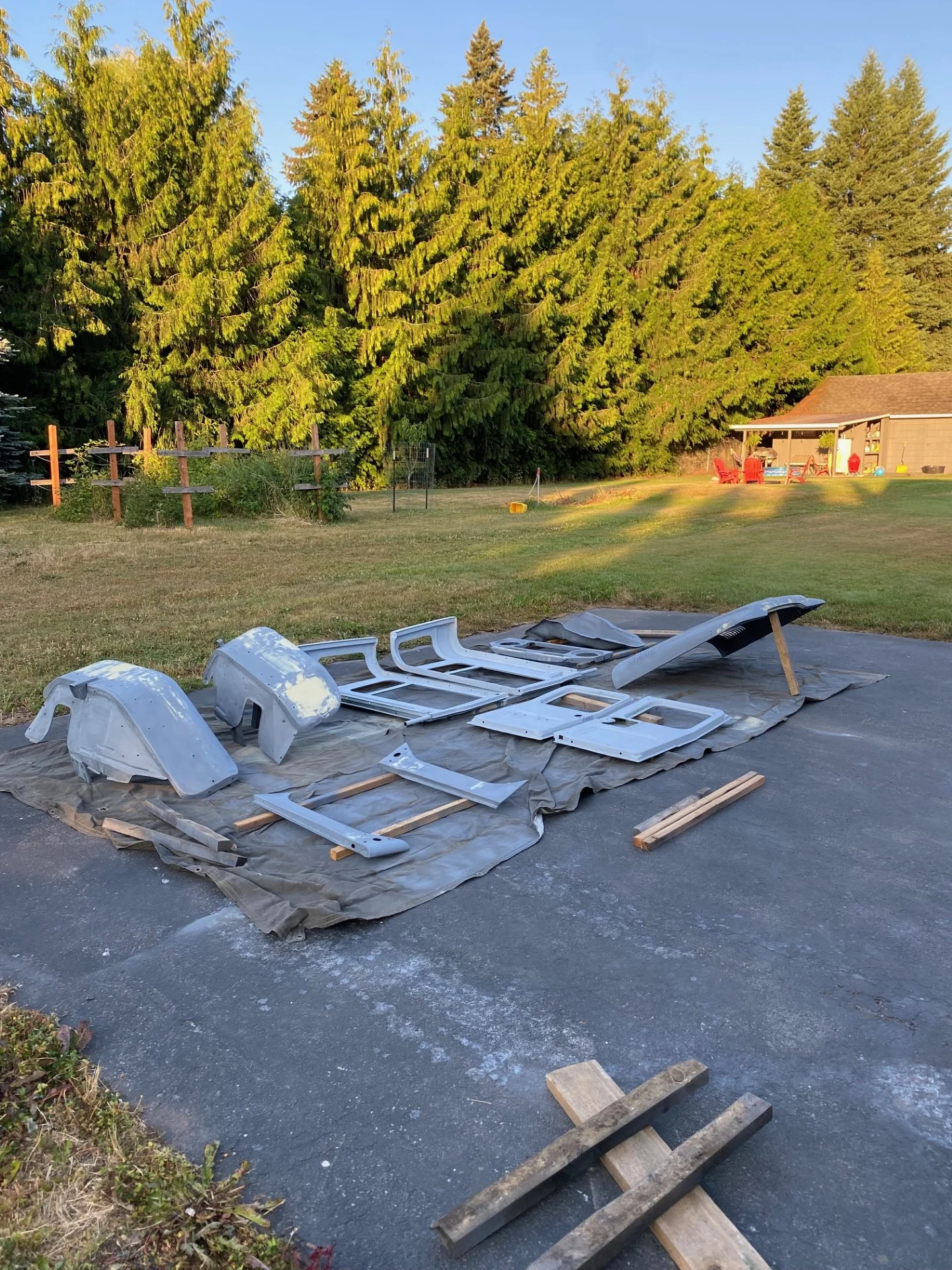

I didnt get photos of the 2k primer but will pick up finish painting those parts when the temps increase.

I'm working on door patches now and am a bit concerned about welding the patches on and the finding they don't fit well when the doors close. Did you have them on the truck, place the patches in the approximate location, mark and then cut.. or did you just go off the existing bottom of the doors?
Also, my welding skills are quite poor and I only own a stick, what type of welder did you use and do you think its easier?
My patches seemed to line up great so I just patched them in where they lined up. There’s a bunch of good info on mud for doing these patches. The most useful hi t was angling your cutoff wheel at a 45 right where the new metal meets the old and you end up with a perfect fit.
My welder is a Harbor freight POS. I wish I would have got a nicer one when I started but it’s what I had. Just practice and you’ll figure it out.

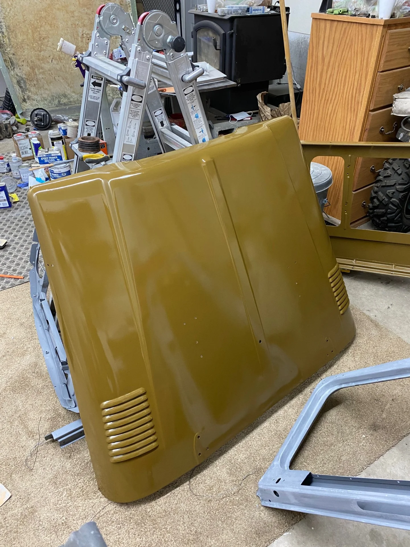

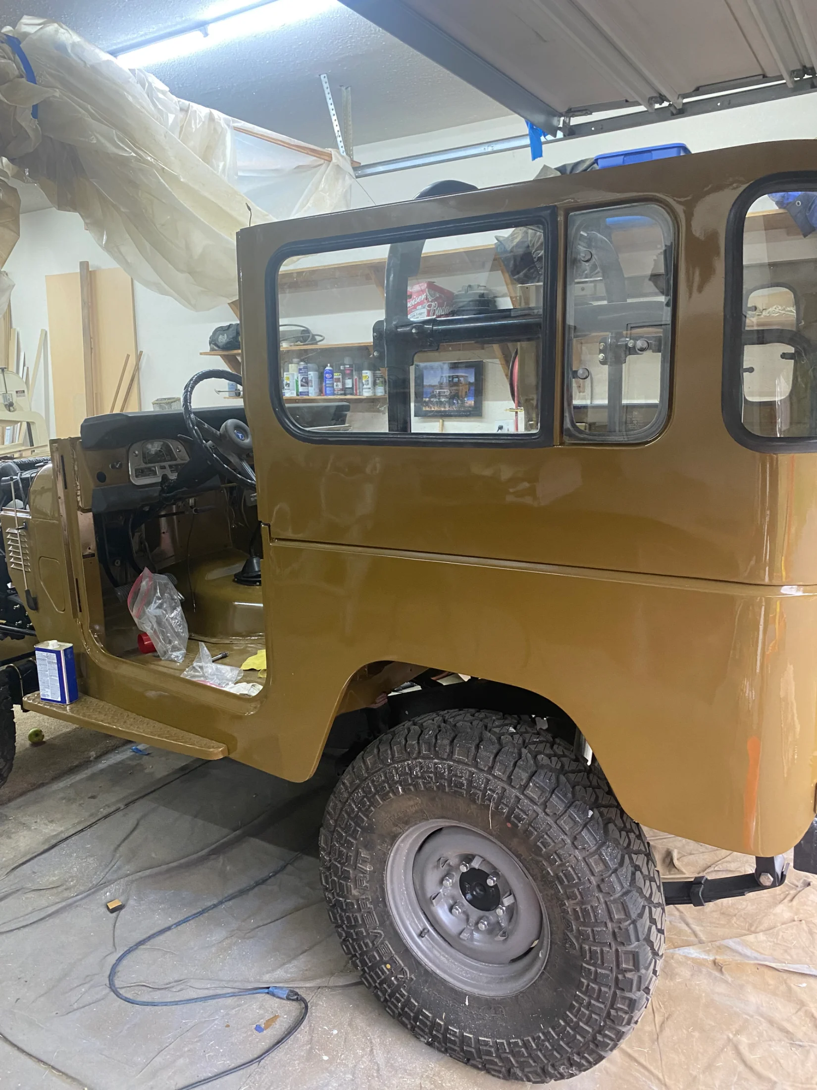

Just about there! Just need final paint on the fiberglass top and a few items here and there. I’m headed to the exhaust shop on Thursday.
