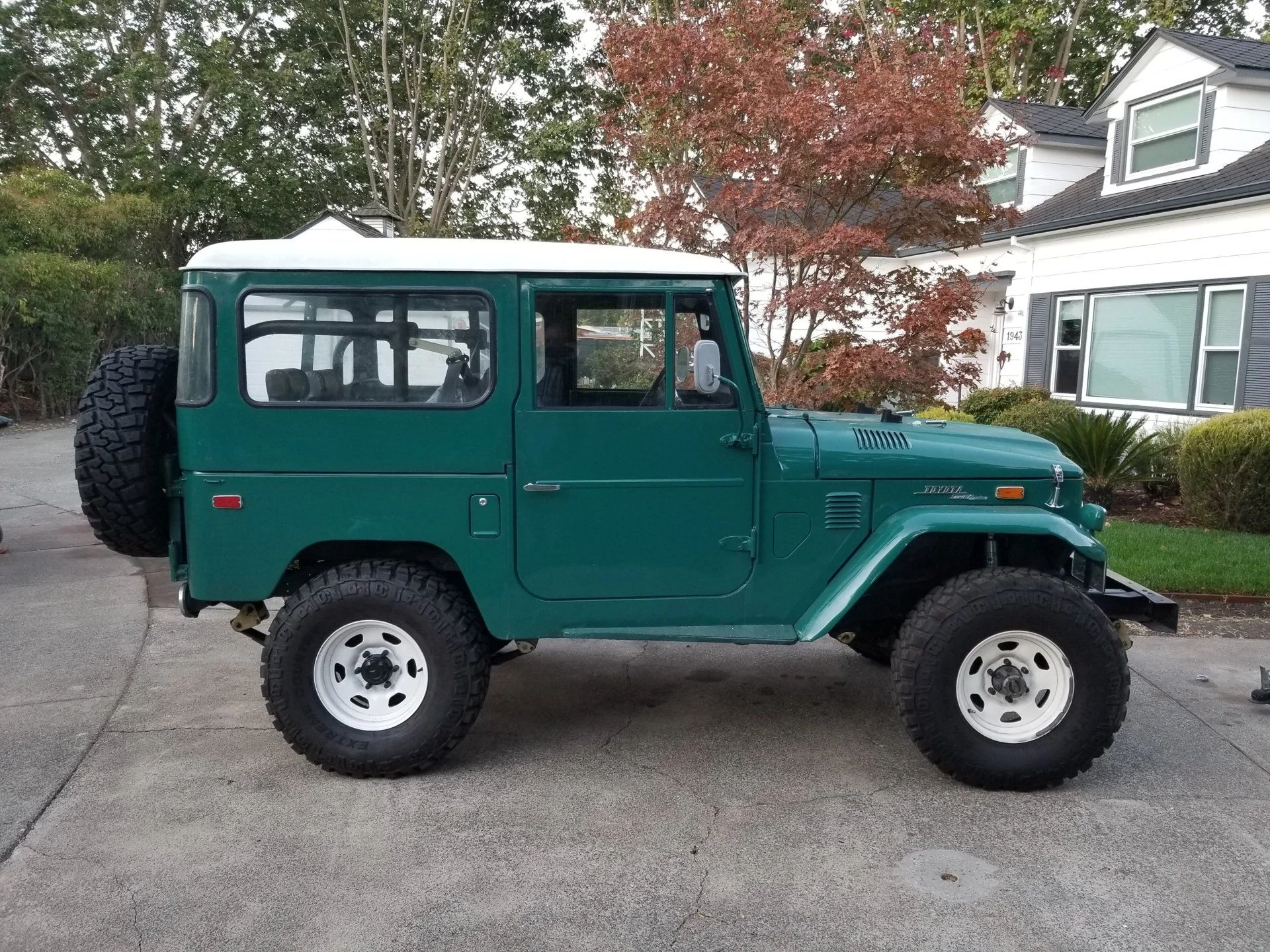

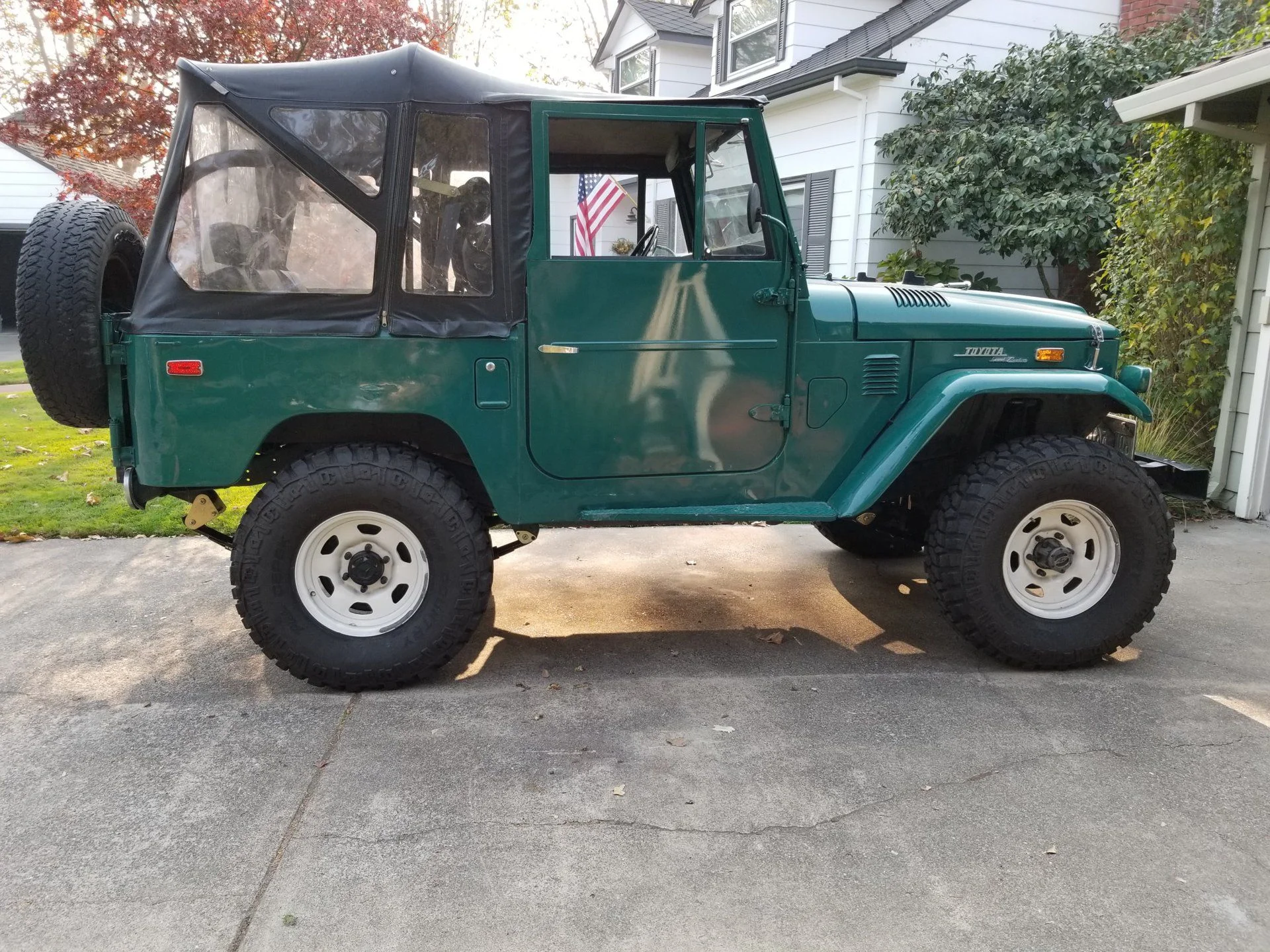

I have the Pro Comp 2.5" springs- Man a Fre Anti Inversion Shackles ( 3 1/4" center pin to pin) stock shackles are 2 3/4" I believe and Bilstein Shocks. First photo is about a year after instillation with hard top- you can see the shackle angle has changed. 2nd photo is day of install with soft top. I also have a full size spare on the back now. 33x10.5 Dick Cepek on 15x6 rims.
