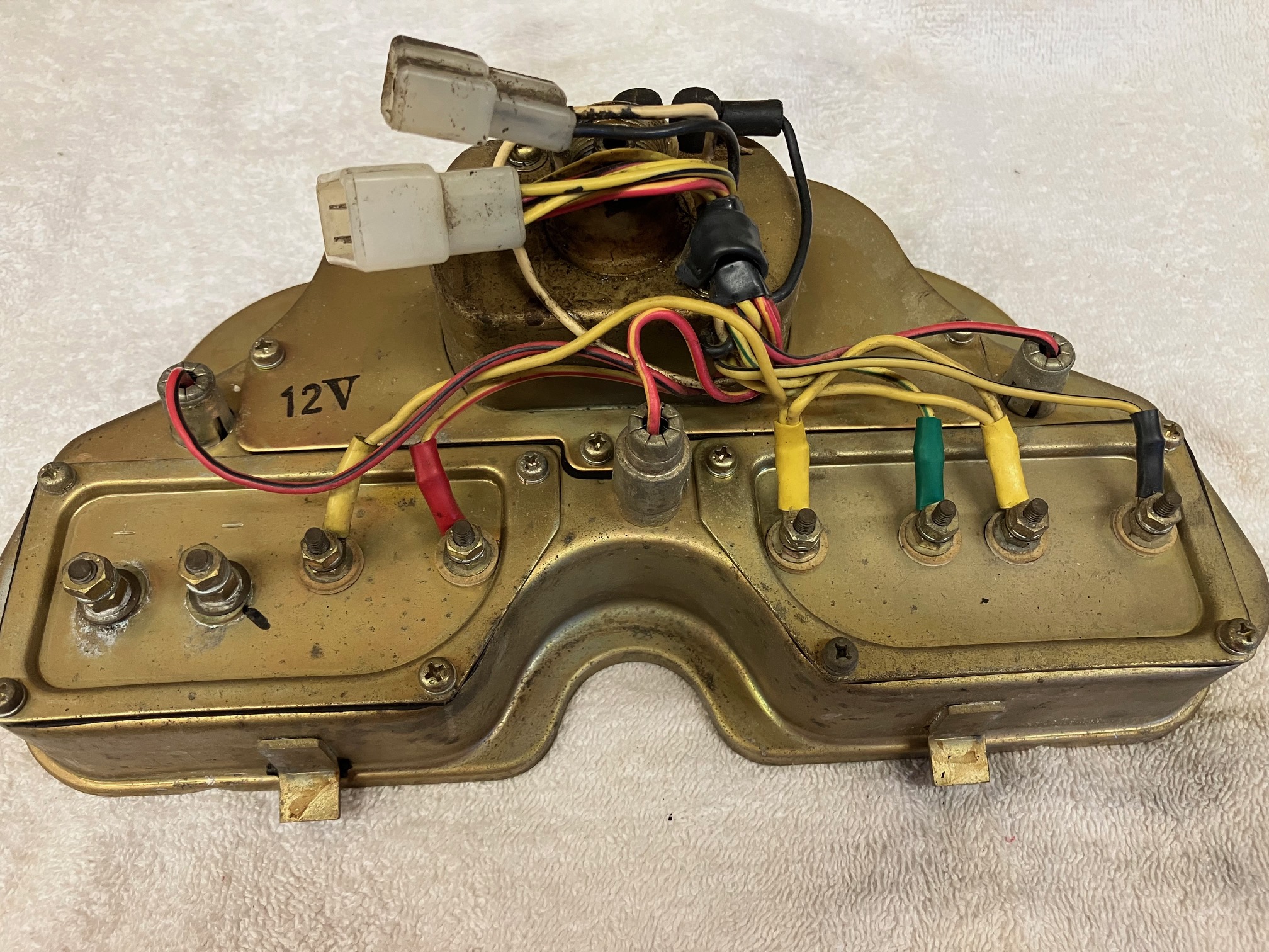

I just finished refurbishing the instrument cluster in my ‘72 FJ40. Upon reassembly and reinstallation, I have noticed a couple of issues.
The fuel gauge reads backwards. I verified this by adding fuel. It also settles to right (F) side when the switch is off.
The temperature gauge also reads backwards when the engine warms up. It was settling to the right (H) side with switch off, but is now settles to the left (C) side with switch off.
The leads were reconnected to the same posts as they were before disassembly.
Any ideas?
Here’s a pic of the instrument cluster after the rig was shut down and rested for a few minutes.

What exactly could be connected backwards? I took this pic before disassembly, and matched it during reassembly. Unless I swapped two gauges inadvertently before adding the faceplates to them.
It can happen when you take the gauge apart.
That does sound like a real possibility if you took the face plates off
