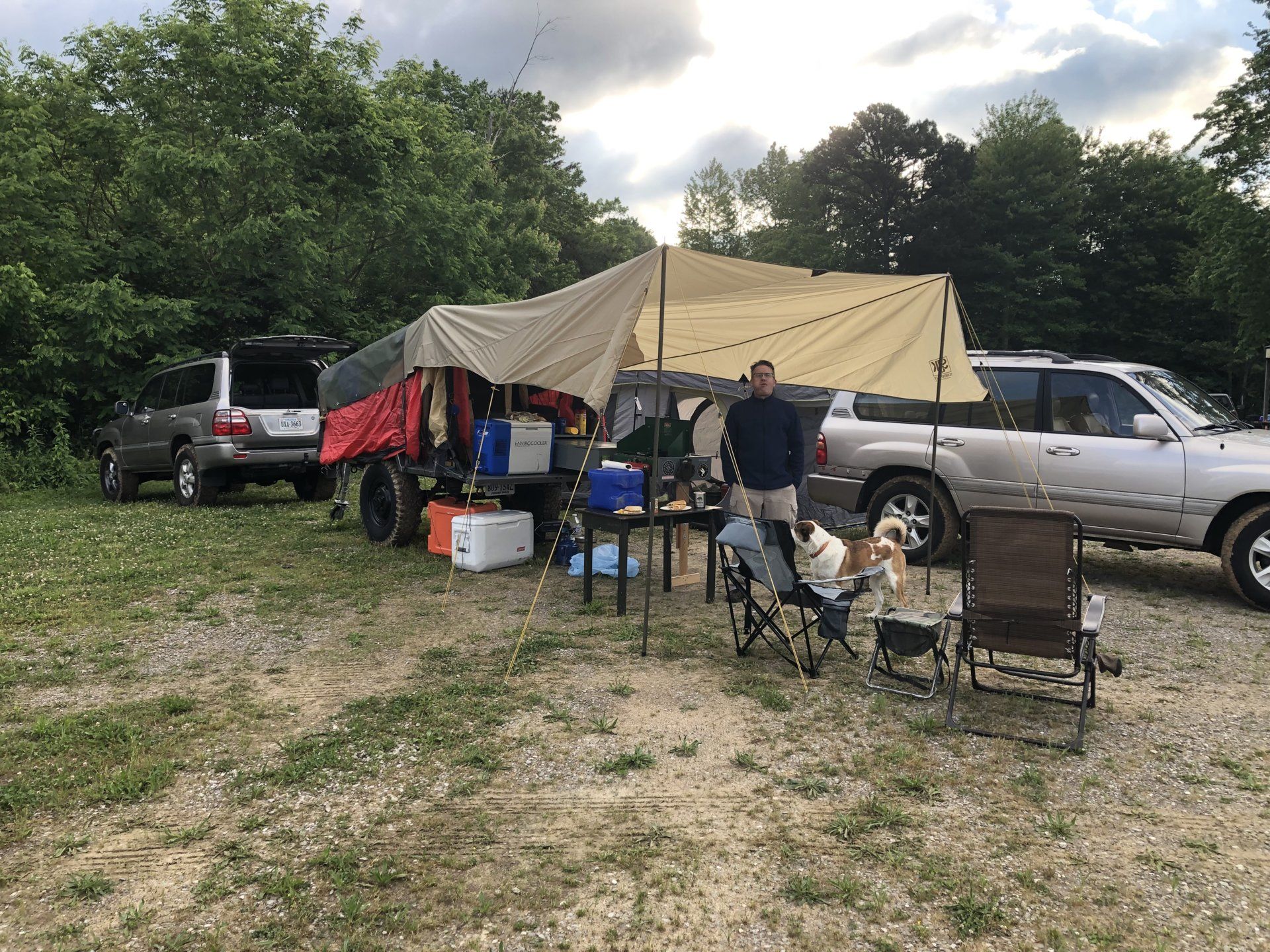

So here is my 1968 M101A1 trailer overlanding trailer. Took about 3 months, still not done, I would like to swap the axle and tires but not a high priority at the moment.

Pics cover most aspects of the build, clean up, getting a handle on the rust, paint, all new wiring, pull out kitchen, sleeping platform, hi-lift jack mounted, front storage and other features. The tongue was extended, harbour freight tongue box with a 12 volt battery setup and 100 watt solar. Jerry can holders now have plenty of room. The set up allows for a standard ball or switch to an off road set up. New lighting includes interior with hi and low settings, marker lights and a 12v fan.
Still lots of bugs to work out and need to take it on the first trip with my sons but for the most part done.
Click on the link, will get you a 100+ pictures that may give some ideas that I had. Pic is the most current trip to the Great Smokey Mountain Trail Ride for a week of off roading, use the slumberjack canopy, very easy set up and only $100. Fridge is a 12 v medical cooler that was bought thru Olde North State Cruisers (ONSC).
M101A1 Trailer build
