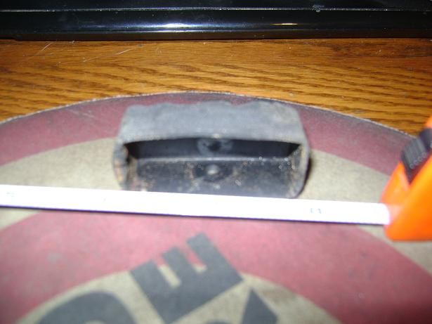

I do have a question you. Did you ever tackle making the small plastic cover on the windshield wiper motor? I know many here could use one or two. I have that is 95% that with go in my 70 (the one pictured in my avatar) but could use a few more if have or make any more. The seat release handles you made from just the pictures looked great. I know you would be up to the task of making the wiper cover.

Not sure what cover you are talking about? Motor covers that are stamped metal, the rubber piece that slides over the terminals?

That would be 61 to 67 models for the wipers. 68 model was the first one with a single motor.
Did you make a cover the contacts on the wiper motor. It would have been black plastic and very thin plastic.
you mean this??

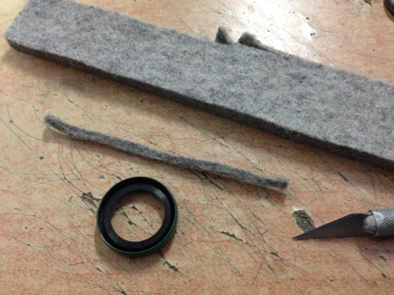

I find the steering box oil retainer and check te play of the worm and shaft I sand with 2000 sandpaper and it get so good , Im working on the steering tube and the linkage suport
it came with a felt grace retainer , I just can get a oil ratainer and I will mix with felt to put together
I cut a felt line and add in to the retainer, fill with grease , powder paint , send to zinc plate
I didnt find a new retainer , and the one that I have was just craked a bit. so I add a plasi dip wich is a rubber paint and get very well!! so now get paked and is ready to run!!
