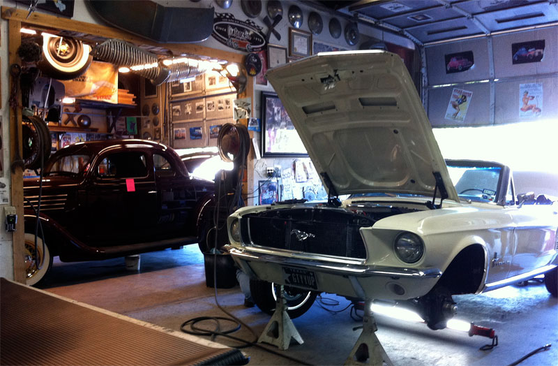

Well, I thought I would start a build tread on the 1967 convertible. On a whim, I sold my 1977 Toyota FJ40, and decided after years of doing the LandCruiser thing, I needed a muscle car in the stable.

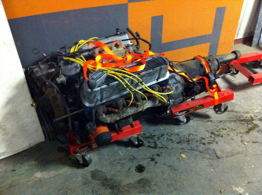

My brother found this car for me (he is the Mustang nut in the family), and it was super clean, and had been sitting for 10 years. The PO was a young man, and this was his first car in hight school. He had dropped in a 302 with a C6, but the install was not very clean. No stall converter, kick-down cable, and wires where just twisted together with electrical tape.

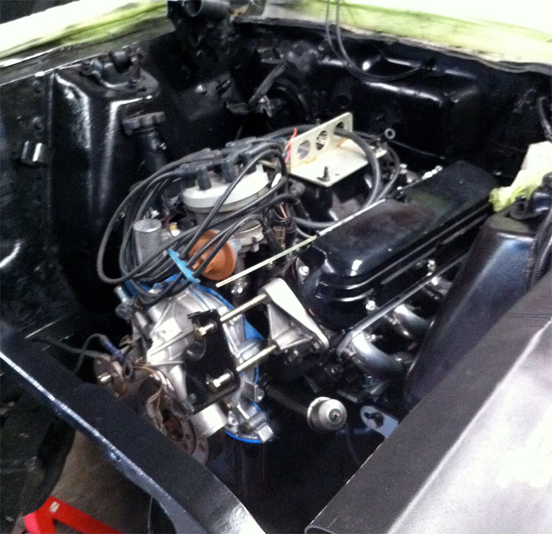

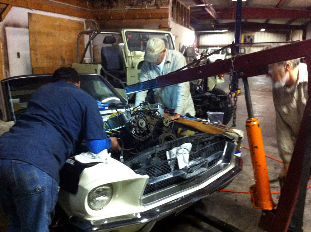

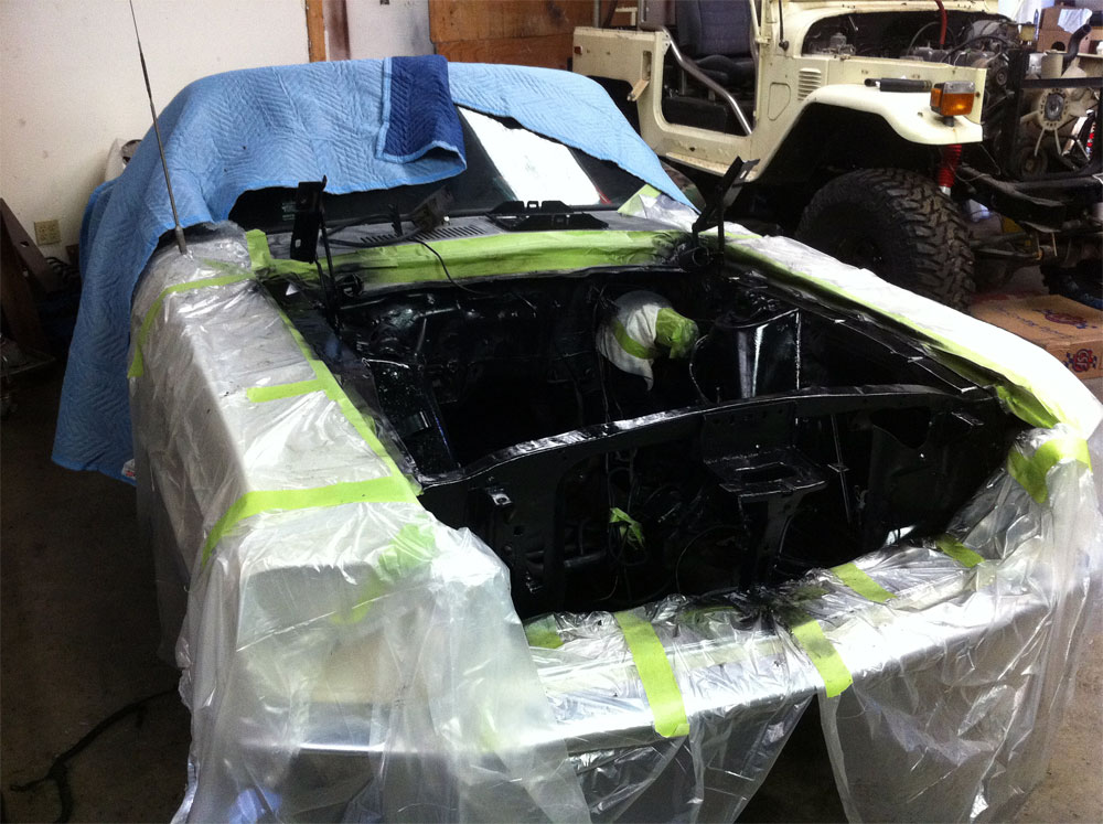

I just planed to do a few minor things to it, but once I dug into it, I realized what a mess the PO had made of things I decided to give the car a little TLC. First thing was to pull the engine and transplant a DSS Racing engine with a T5. I scored both off Craigslist!!

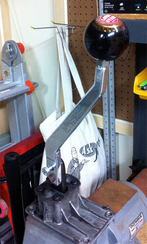

First thing I did was have had the T5 rebuild. Then moved on to cleaning things up and begin the rebuild. We Started this back in November of last year.

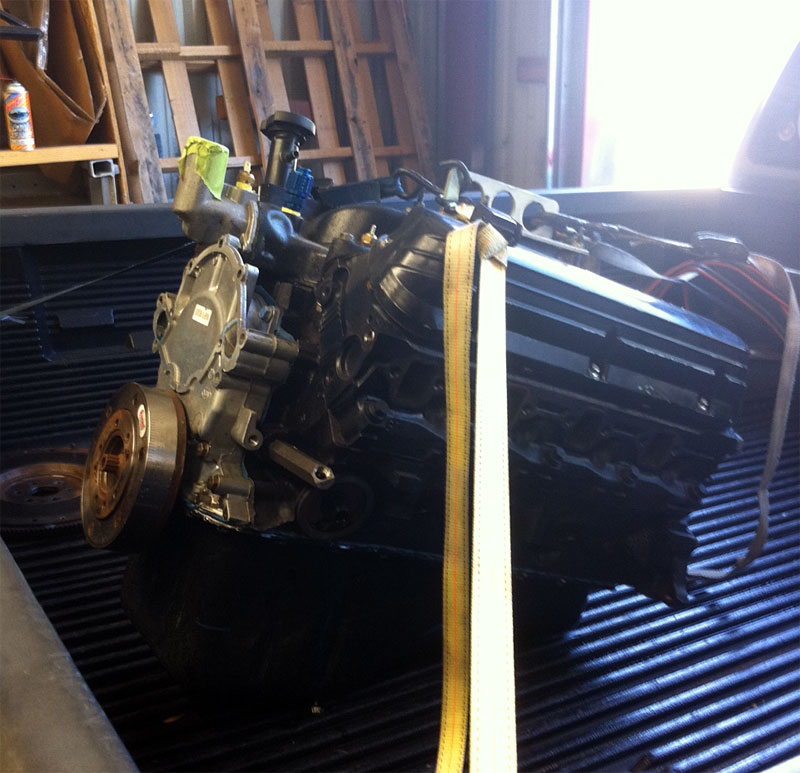

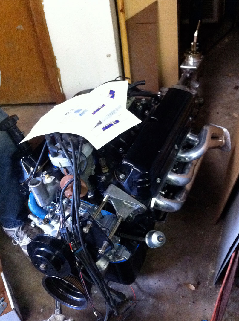

Engine Specs:
DSS Level 10 CNC block.
DSS pistons
Stock rods and polished crank
Comp Cams 270HR roller cam
Ford GT40 heads
Comp Cams pedestal mount roller rockers
Edelbrock Performer RPM Carbed Intake
Melling High Volume oil pump with hardened shaft
Summit Racing SFI balancer

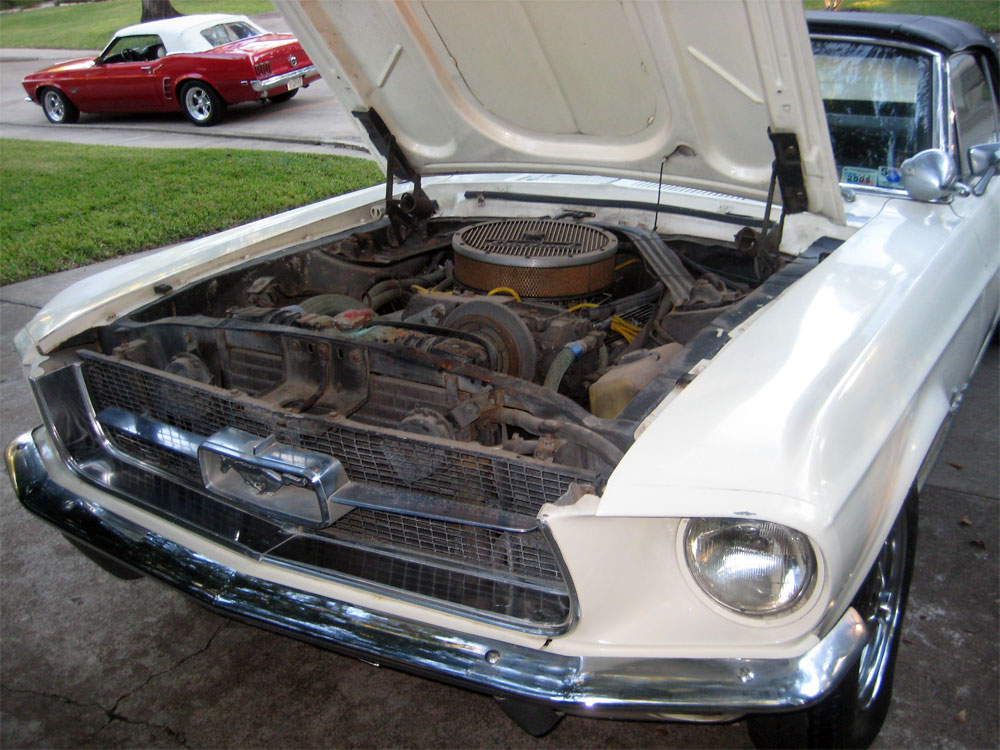

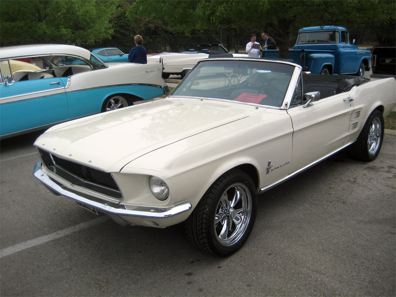

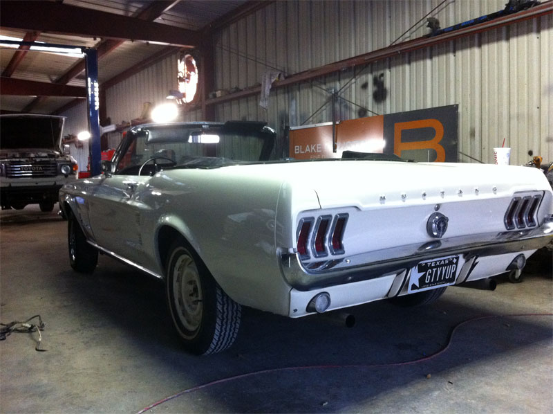

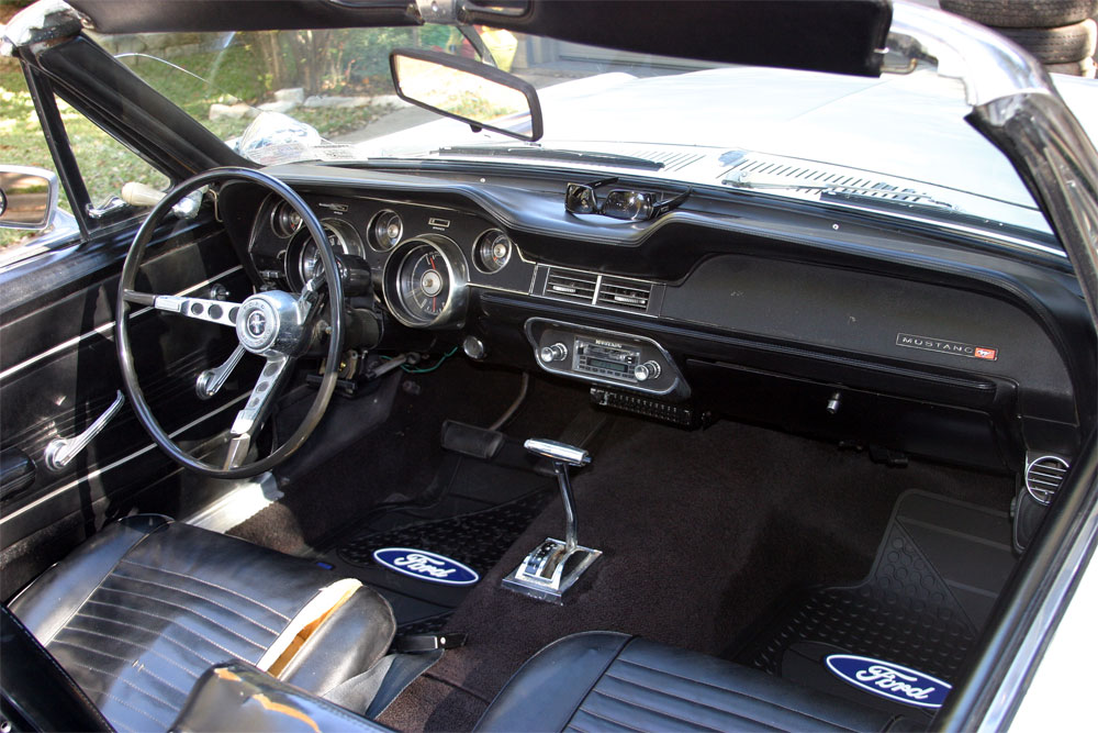

Here is a shot of the day we bought it.
Very nice...I went the other way....67 Coupe, 65 Convertible, 66GT Fastback, and THEN a cruiser.
