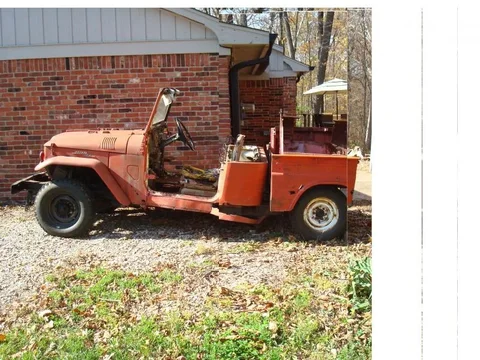

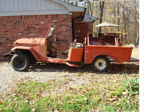

I did a few measurements and the 80 wheel base is very close to the FJ45 wheel base so I just did some kind of messy photo work on what I think this truck will look like cut up and what I'm thinking.
Today
The cab should be stretched about 8 inches so I cut 8 inches out of the bed in front of the wheel well. I then cut about 24 inches out of the bed after the wheel well. This is what I thought would work the best for wheeling and keeping as much truck bed.

Now as an engineer I like the golden ratio and the rule of Phi and tried to use that as I stretched and cut the truck. This is what it came up with. As you can see the body line run pretty close on the horizontal and vertical lines and also with lines of the truck. The problem I'm coming up with is that the red phi lines want me to cut almost all of the bed off to make everything else line up. See the red line just past the rear wheel. If I stretch the phi grid to the end of the bed in the first picture it doesn't line up with any of the other vertical lines of the truck. http://en.wikipedia.org/wiki/Golden_ratio

Looks like phi isn't going to work for you bud. I liked the first cut in post 30 best.
Yea looks that way, it may help me stretch the cab, but the bed just doesn't fit. My first guess with just my eyes looks the best. It is kind of interesting that the door openings and the rear of the cab/begining of the bed do all fall on the ratio lines
Any way you do it, besides some hack inbreed job is going to be killer.

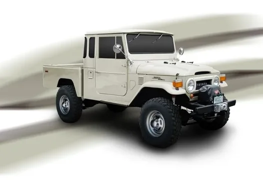

How much extra cab has anyone added or how much do you think the gray cab has been stretched?
Cruiser Concepts said theirs is extended 8". Lee, the typical stretch is about 8 inches. That's enough to insert the windwing from a later model hardtop behind the door pillar.
http://cruiser-concepts.com/CRUISER_CONCEPTS/ExtendedCabFJ45Shortbed.html
Aqualu has said they can stretch their 6" to 8" or 10" no problem.
Yes we would be able to build a custom #4502 - 1978+ older FJ45 cab that is 8-10" longer than stock, would be approx. $300 additional on top of the cost of the cab ($2,273.00). Lead time would be around 6-8 weeks and we would need a deposit to get the build going for you.
