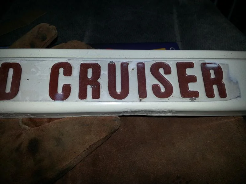

Here is my 1962 bezel. I taped off the letters before I rattle canned the rest with Ford Wimbeldon White. It matched the color of the rear of the bezel a lot closer then the front. As for the letters in the bezel that is the factory paint, I rubbed them down real good with rubbing compound to try and remove some of the oxidation. No clue if that will help you or not. There is not good documentation on the colors they used in 1962. You can search and or post in the fj25 section if you really want this to go back to 1962 correct colors, but most of those guys watch this forum as well. I still need to re sand blast parts of this fix the pitting then re rattle can, not sure what I will do with the letters, I wanted to keep the original paint in them.

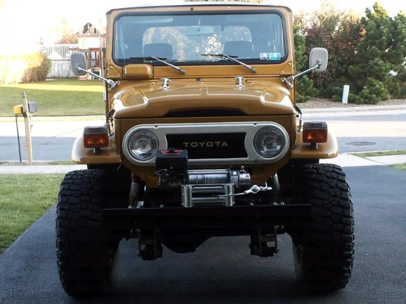

I painted my 78 bezel 012 cygnus white and a 62 bezel the same same color and this is what it looks like . The painted chip looks very muddy but it looks much whiter on the rig. I sell PPG paint, and of all the whites this looked the best to me.
Hello Land Cruiser Kid,,,,,,,,,,,Thanks for the info and yes your right, the cygnus in my picture of samples does look a bit muddy and as you know photo's of these paints, depending on lighting can look really diffrent. What I want to point out to viewers is just the compare and contrast between many of these options that I hear about on MUD. I just decided to get samples of them all. The one on the top left side of my sample sheet that says ''60's roof white fj40'' is the one I decided on for my roof and my bezel and this one was taken from the roof of an early 60's fj40 in pretty decent shape. Thanks again for your input and that is one beautiful cruiser you have there man!! FJFJFJ
