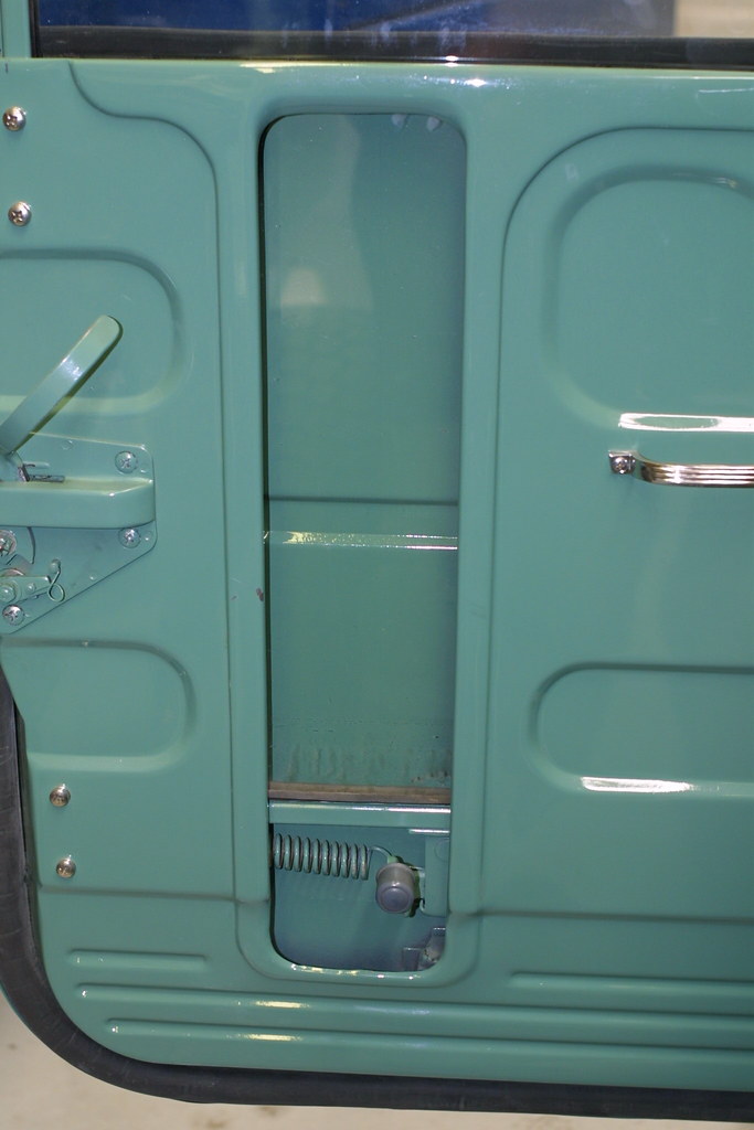

I'll see what I can do. Its difficult to get much of a photo with the window installed in the door as much of the parts are hidden behind the steel panel. I'll see what I can get at.

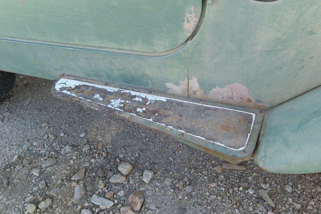

Here is the photo of the Pyramid Matting I used.
Hi I just got thr withe piramid vinyl is awsome
I decide to put that on my fj40 68 , cause I see here in mexico around 1994 one OLD FJ40 with that withe color tipe ON RUNING BOSRDS
I asume is the original color one , is that correct??

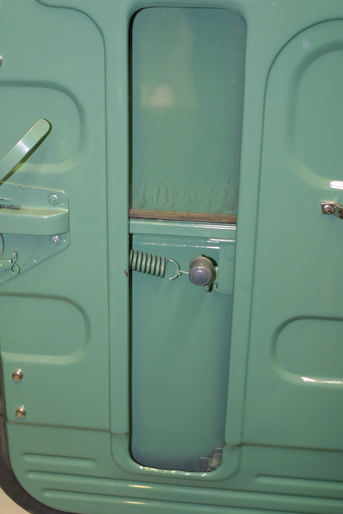

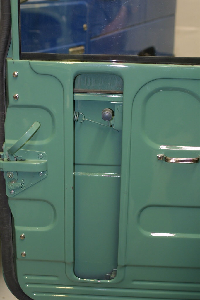

Ok, here are a few door photos with the window in different positions

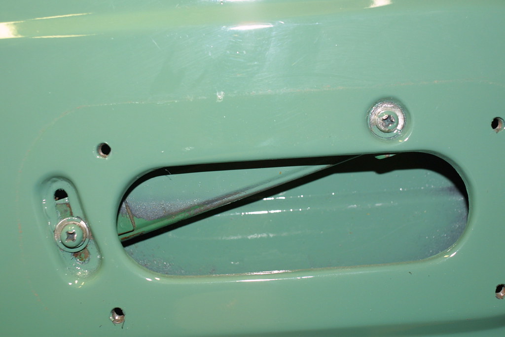

Parts from my FJ25
Its tough to get much of a photo of the insides. I'll dig a little deeper looking for the complete set of parts not installed in a door.
I believe that it was original on my FJ40. When we started the restoration, there were fragments of the white color pyramid vinyl under the top frame of the running board. I have also seen photos of early FJ45LV wagons with the same white vinyl floor covering fresh from the factory.

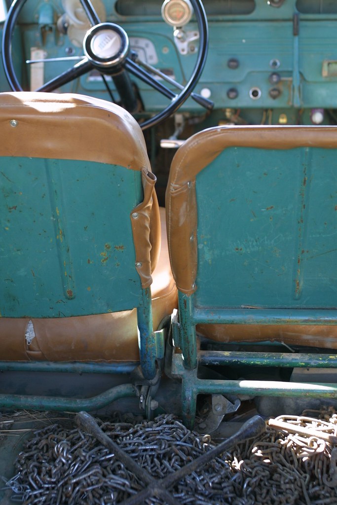

... What seat covers did you use? are they stock?
I will post some before photos tomorrow. The seats were done in a local upholstery shop to try and match the original ones.
Thanks, Mike

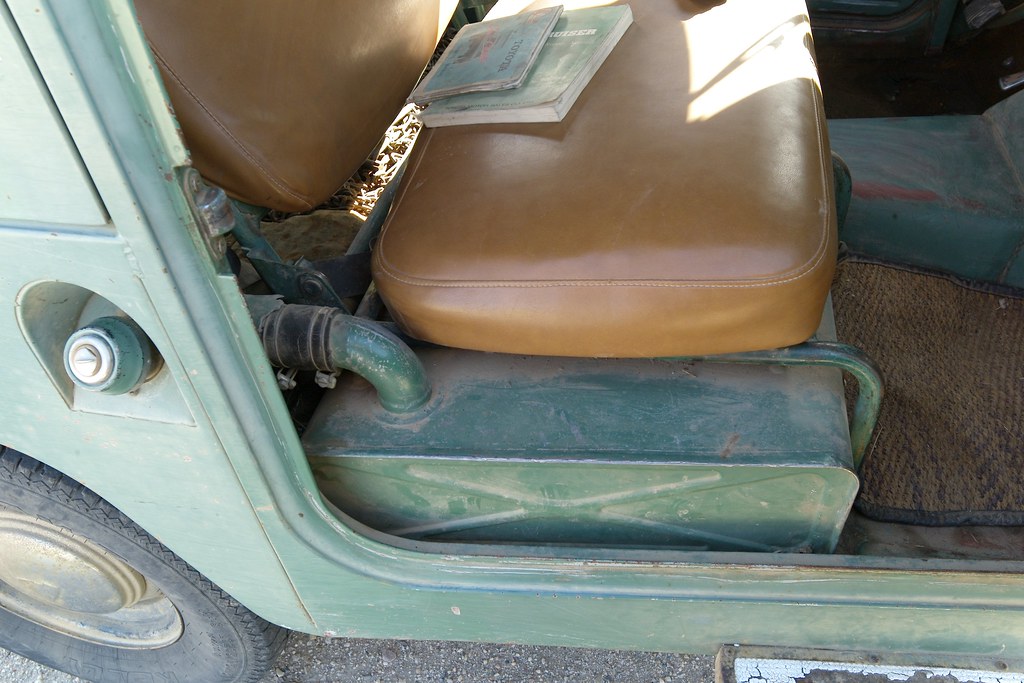

After looking through my pre-restoration photos, I don't think that these seats were stock and must have been replaced at some time prior to my involvement.
Here is the original material on the running boards. I have the same remnants on my 1960 FJ25.

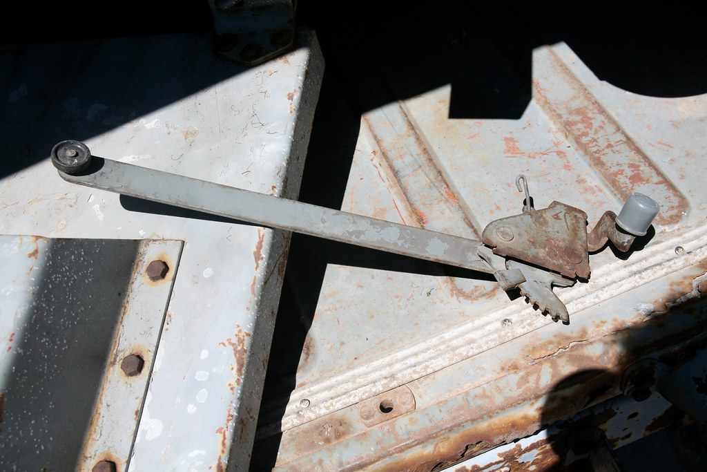

thanks for posting those pics up. that's a really interesting set up. i have a set of those doors but they are missing all the regulator stuff.

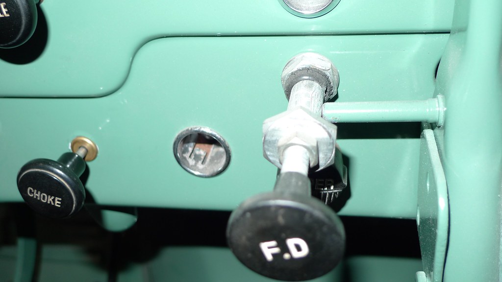

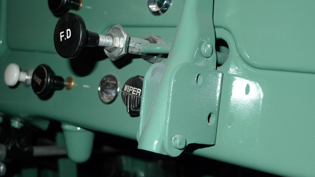

Phenomenal job on your 1962. I just started mine. I have a question - do you have a close up of the piece that connects your T/C handle with the FD pull switch? It just donned on me that I will have the FD switch in a couple days, but don't have the piece that links the two. Also - did you blast & prep your tub, and if so did you use sandblaster/stripper combo., or how did you prep it so nicely?
...do you have a close up of the piece that connects your T/C handle with the FD pull switch? It just donned on me that I will have the FD switch in a couple days, but don't have the piece that links the two. Also - did you blast & prep your tub, and if so did you use sandblaster/stripper combo., or how did you prep it so nicely?
Looks like I am missing a retaining pin on the bottom there. I outsourced the tub prep to a person that soda blasted the body. Not sure if they used any other methods in addition. Hope this helps. Mike
