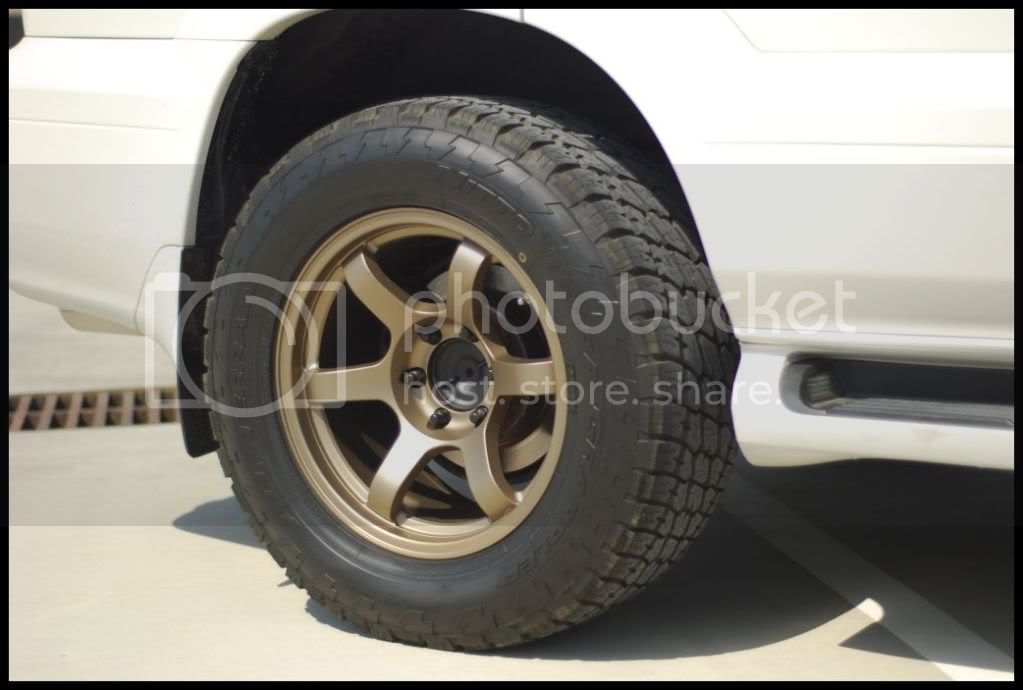

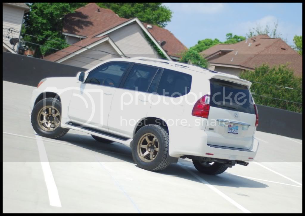

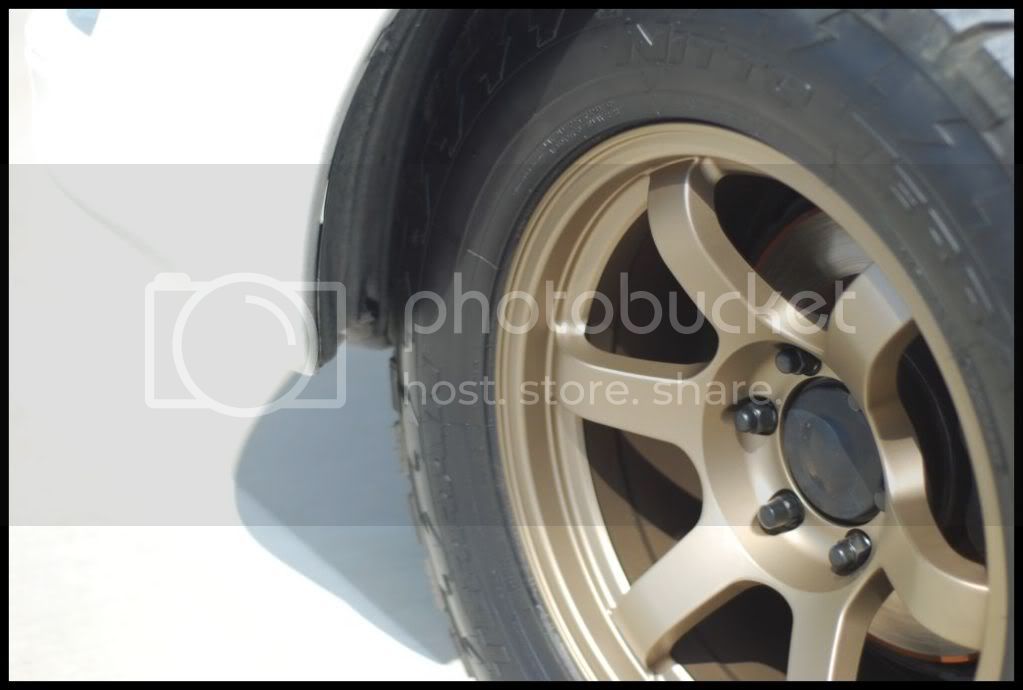

I bought my GX back in March 2012 and I knew I needed new wheels. I dont like chrome wheels at all so I bought a set of 18" BFD wheels last week from fnwheels.com (big thanks to Dustin!) and had them installed this past Friday. Before I bought them I photochopped my GX to see how they looked and the amber tails didnt go with them so I bought a set of sport tails too.

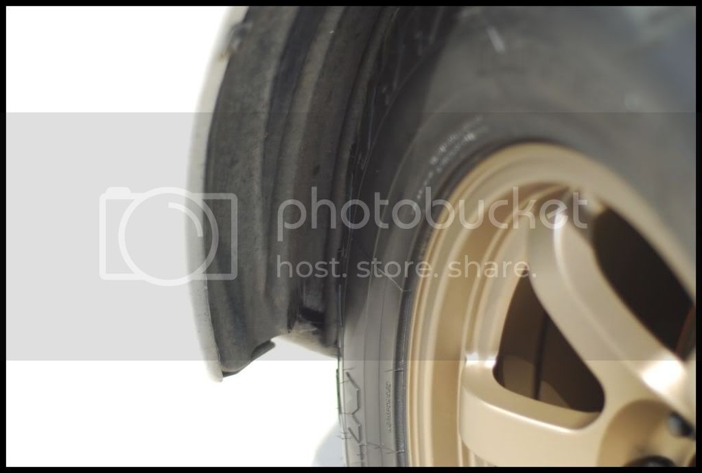

The wheels and tires look much better in person than in the pictures. I had a little rubbing at full lock on the front mudflap area and the front of the front fender liners. I cut about an 1" of material off of the mudflap area and I used a heat gun to push the front fender liners in. Problem solved, no more rubbing.
Specs and pictures below......
WHEELS
Matte bronze BFD wheels
- 18” x 9”
- 22lbs. (stock chrome wheel: 26.4lbs)
- 0mm offset
- 5” backspace
TIRES
Nitto Terra Grapplers
- 285/60/18
- 47lbs. / 31.5" (old tire: 38lbs. / 30.6")
WHEEL LUGS & LOCKS
Gorilla black chrome lug nuts
- part # 91137BCB
Gorilla black chrome wheel locks
- part # 71631NBC

MUDFLAP TRIMMED
http://i140.photobucket.com/albums/r34/rrcompton/Lexus GX470/BFD wheels and NTG tires/DSC_2360.jpg
FRONT FENDER LINER
http://i140.photobucket.com/albums/r34/rrcompton/Lexus GX470/BFD wheels and NTG tires/DSC_2362.jpg
http://i140.photobucket.com/albums/r34/rrcompton/Lexus GX470/BFD wheels and NTG tires/DSC_2361.jpg

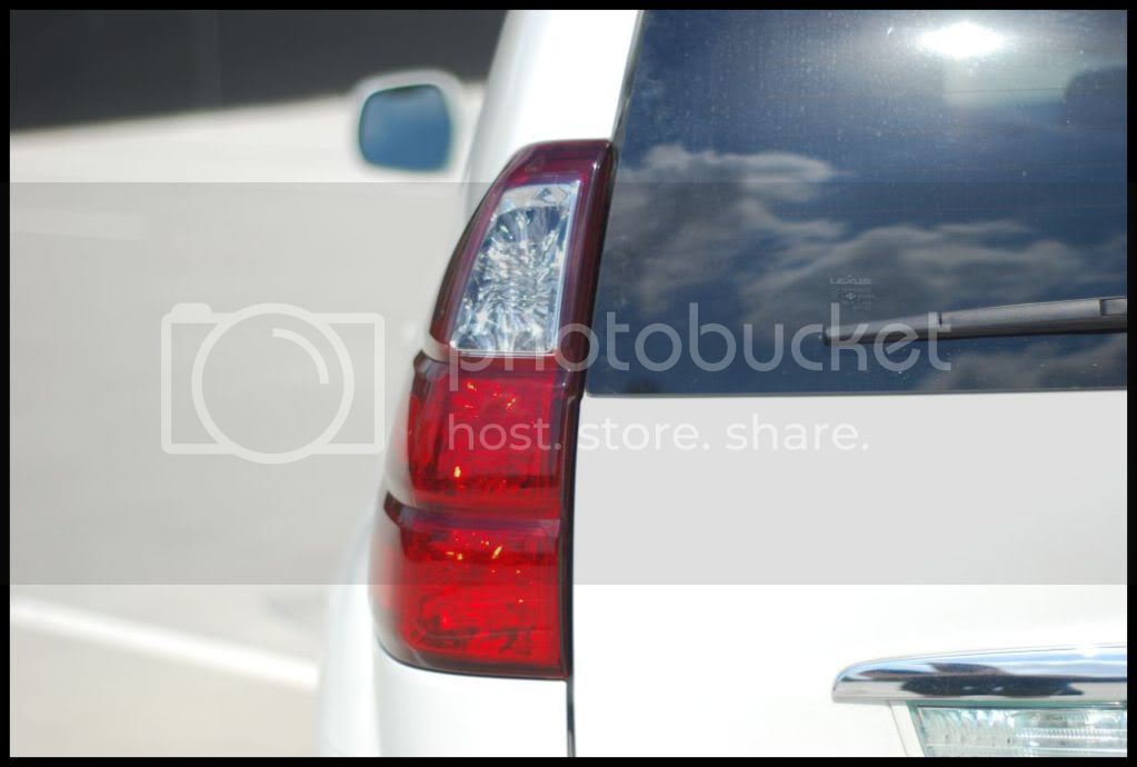

SPORT TAIL LIGHTS
- chrome 7440 bulbs
http://i140.photobucket.com/albums/r34/rrcompton/Lexus GX470/BFD wheels and NTG tires/DSC_2322.jpg
http://i140.photobucket.com/albums/r34/rrcompton/Lexus GX470/BFD wheels and NTG tires/DSC_2324.jpg
http://i140.photobucket.com/albums/r34/rrcompton/Lexus GX470/BFD wheels and NTG tires/DSC_2329.jpg
http://i140.photobucket.com/albums/r34/rrcompton/Lexus GX470/BFD wheels and NTG tires/DSC_2320.jpg

1) does the setup rub at all or is it free lock to lock?
2) did you add wheel spacers or is that a no-spacer fit?
3) where did you source the clear (sport?) tails?
It originally rubbed at full lock but I trimmed the front mud flap area and used a heat gun to press in the front of the front fender liner. No more rubbing.
No, no wheel spacers were used.
Sewell <--- click

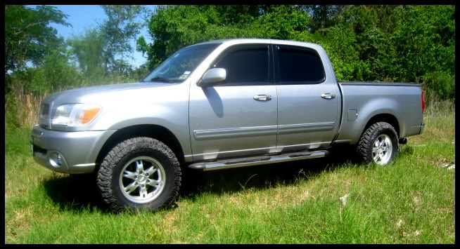

that's one tame looking $15k tundra, bud. but i do like the BBS wheels. i'm a huge BBS fan and had multiple sets of their LMs which are my fav all time wheel on sports cars.
ok i'll keep playing
looks like your GX has this confused knock-off volk TE37 look matched to balloonish stock looking tires and then you actually cut off parts of the running to board to make them fit for very little gain along both the functional and aesthetic fronts. to others looking to get AT tires... don't replicate his setup. do what i did prior to going with my MTs.
