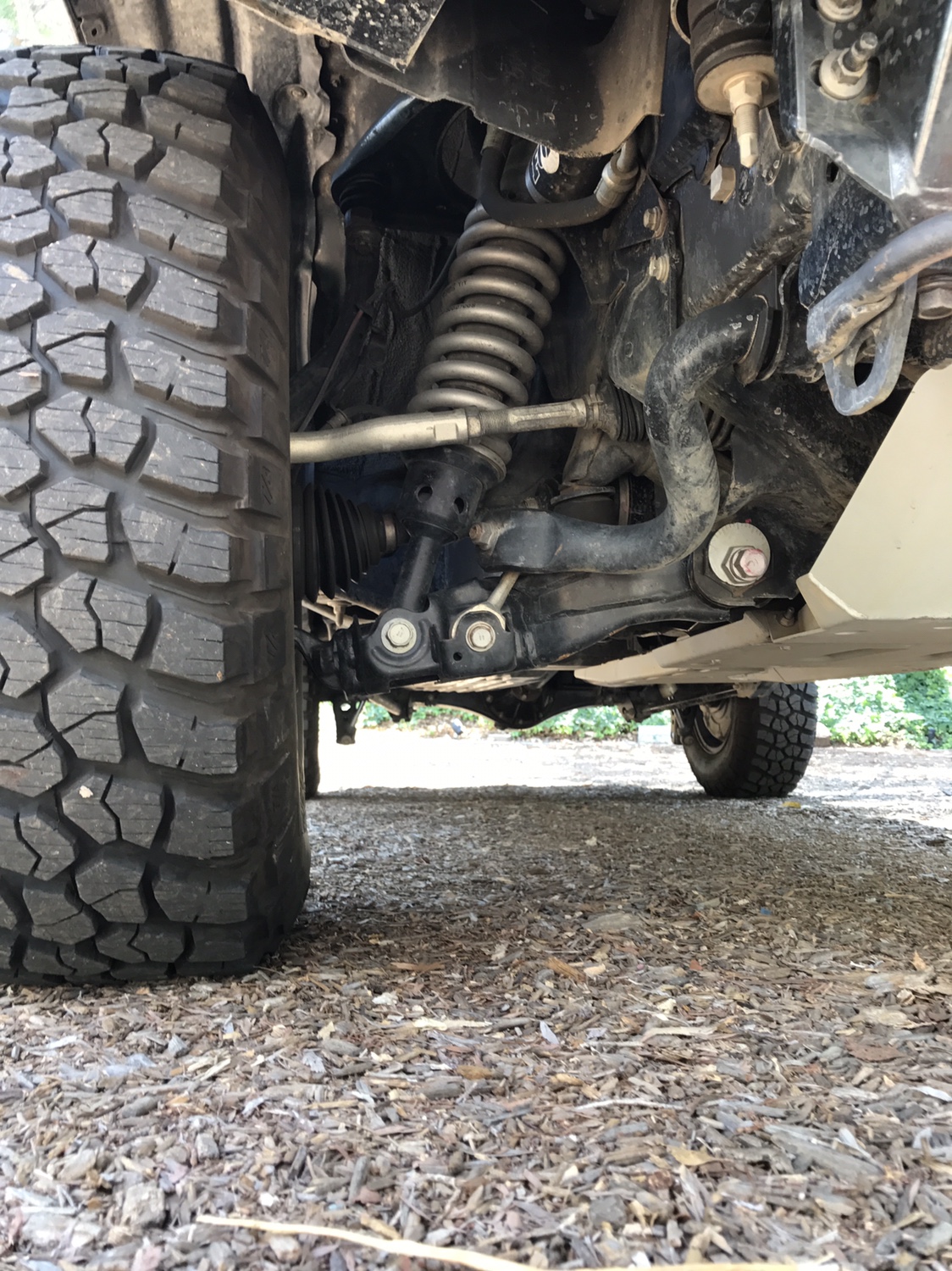

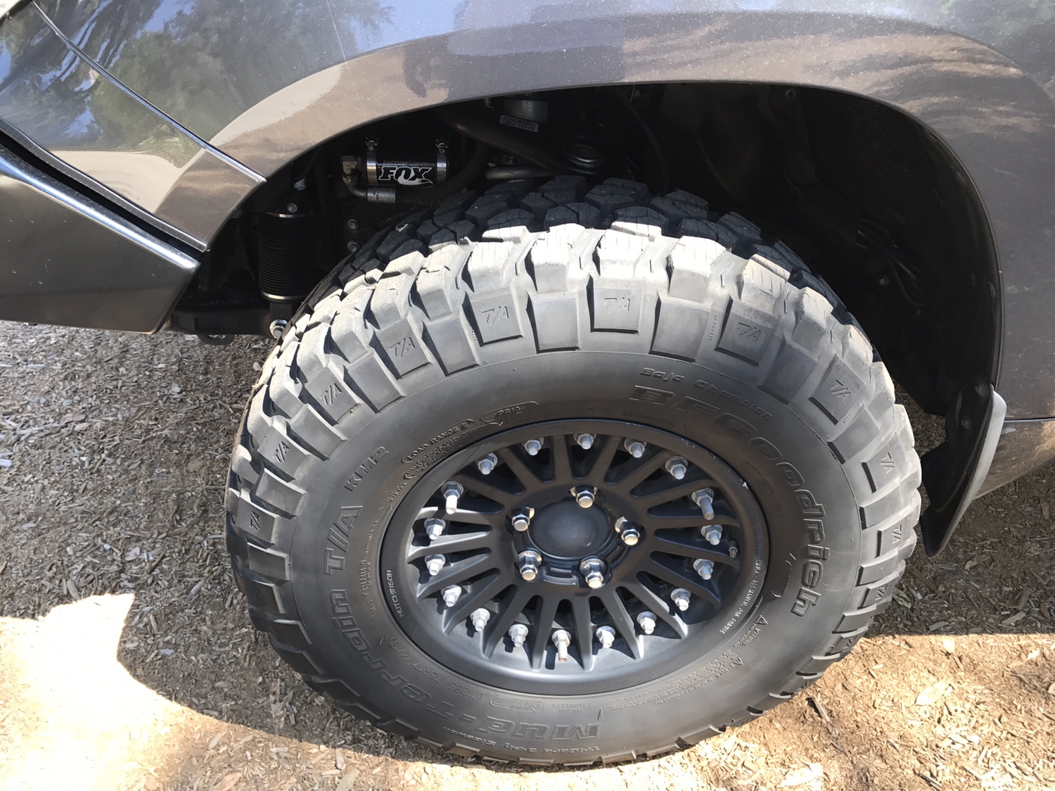

I really like the stance on this rig with Tundra A-arms and 5.81 backspace, so I guess thats around 28mm offset......

- Tundra front end conversion (upper & lower arms, tie rods, axles, linkage, etc.)
- Fox 2.5 coil-over reservoir front suspension

- (5) Hutchinson Rock Monster bead locks with spare parts
- (5) BFG KM2 285/75/17 tires
