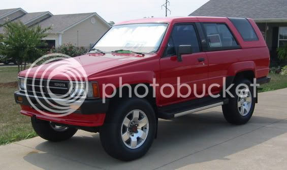

They are a spare set for the LX450, when they get moved over the 37" tires will be installed. The "problem" with some of the later rims is the flat face, if their wheeled the rim faces get torn up quickly from rubbing on rock, etc. The Tundras on mine already have a bunch of rock rash (that's why I have the spares), a some of the local FJC owners have already replaced their rims for this reason.
My mini is a very straight copy, so will be staying relatively stock, the stock rims will be going back on, probably with some A/T's. Those are the stock Tundra tires that were on the cheap Craig's list rims, so using them up.:hillbilly:
day-ummm:eek:

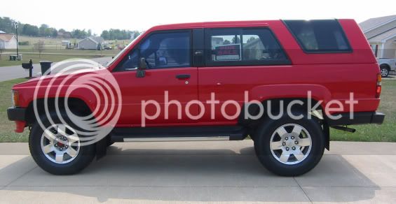

thank you for posting pics. is there any lift to accommodate the new rims/ tires?
edit: I gotcha. do you think the red one has a lift on it?
i have 2.5" rear springs and crank ola on the torsions. 1" body.
the tires are 265 75 r17 bridgestone dueler ht's they measure right at 32" and they are about half way through their tread life.
i was runnin 285 75 r16 yokohamas and they measure a hair over 33" on tundra steelies.
the weight savings was what i was after for daily drivin.
old set up 88lbs a corner
new set up 50lbs a corner
drives totally different.
i don't have ant specs on the red runner.
