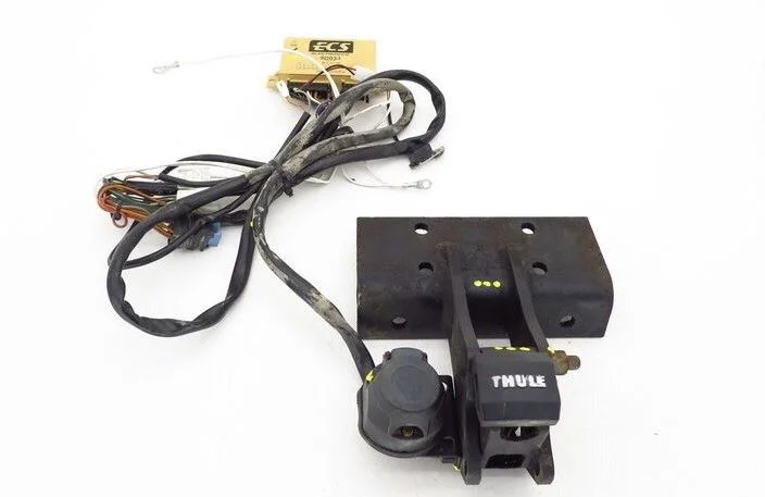

Hey, thanks a million for grttin back to me. I appreciate your input. I ended up buying this set on german ebay. It is in transit... i hope it works... i really don’t need the trailer hitch on daily basis... i just like the idea of having it and being able to hook a trailer up when I need it.

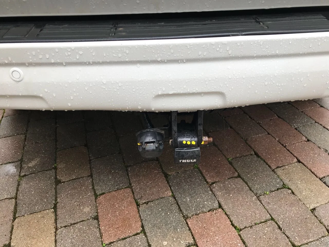

Hi guys, just in case someone ends up needing info on the update and installation. I did it all by myself in about 45 mins. It was quite easy. The one thing I love about Yota is, not only did they leave the mounting holes (threaded, M12 1.25 x6) they left a master plug so I just routed the cables and plugged it all in, it worked without any other mods.
Here is a pic of the finished install.
