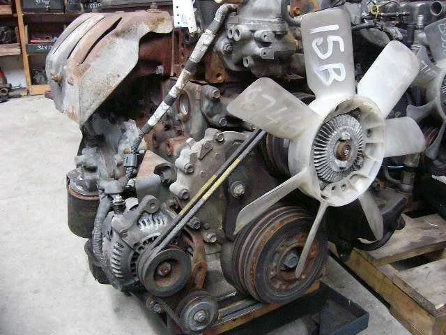

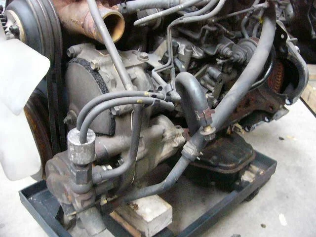

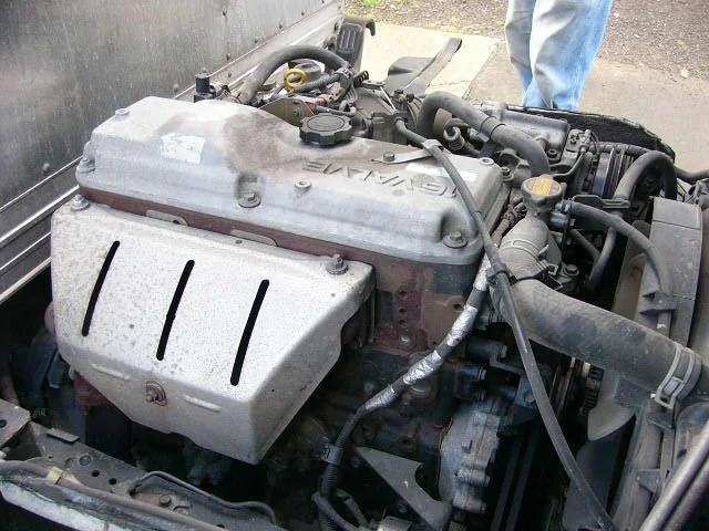

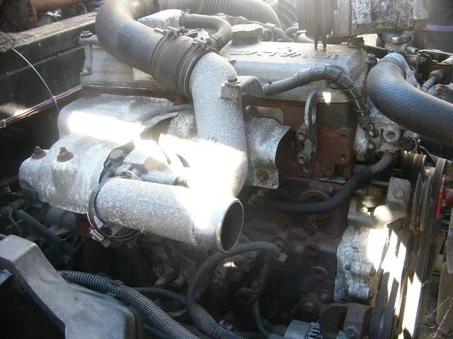

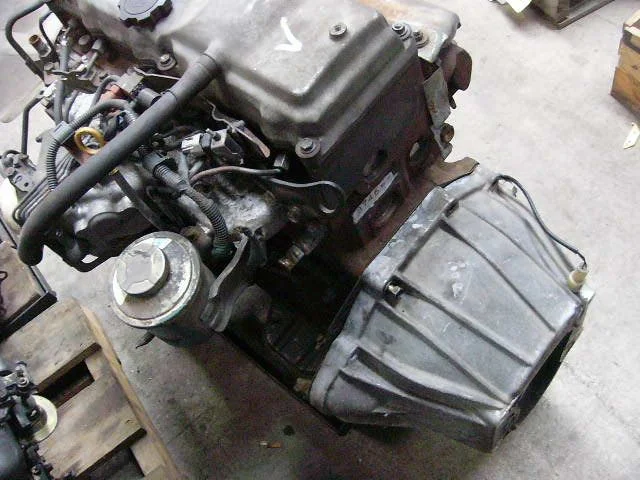

Some pics
Heres a few of the 15BF. The middle photo shows a BJ74 bellhousing (13BT) mounted to it.
Youve got to love the wording on the valve cover huh:D

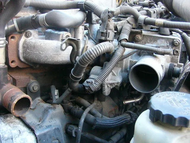

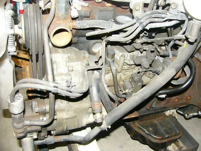

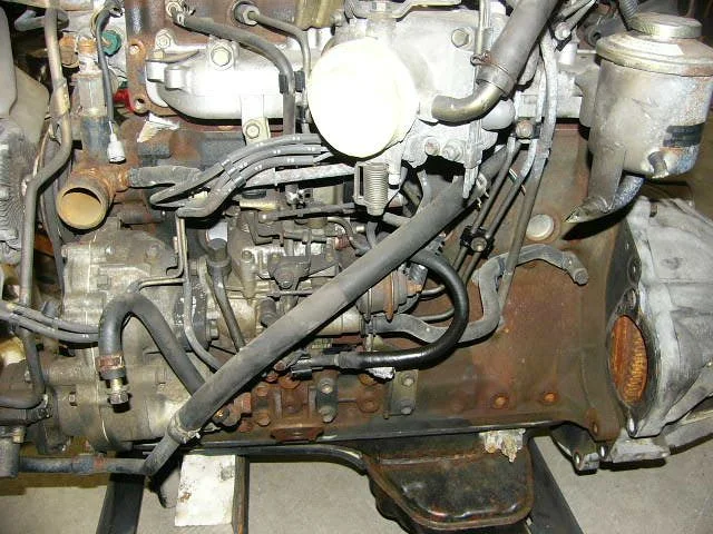

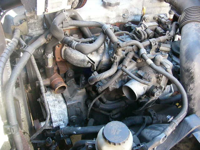

And a few of the FTE
Notice the shield covering the electronic injector pump, and the stepper motor for the fly by wire throttle body.

As far as i can tell the production dates are -
15BF 05/95-06/99
15BFT 05/95-05/99
15BFTE 08/99-08/04
(or thereabouts)

Not exactly, but close. Those top hoses all look different than my 13BT. The top hose exits off the thermostat to the other side, but the bottom looks about the same. Bet that turbo 15 would make a 40 fly though!
It depends what chassis the engine came out of as some have the top hose pointing to the left as per landcruiser applications. So it would just be a matter of swapping the top thermostat housing. Some even have an additional oil cooler between the oil filter and alloy housing (oil to water type).
The bottom hose will definately line up.

Some engines also have a steel 'downpipe' mounted to extend the lower radiator hose (which could be taken off) as on this 14B. It just depends which truck the engine you end up with came out of.
The last pic is a close up the power steering and vacuum pumps, plus associated plumbing.
