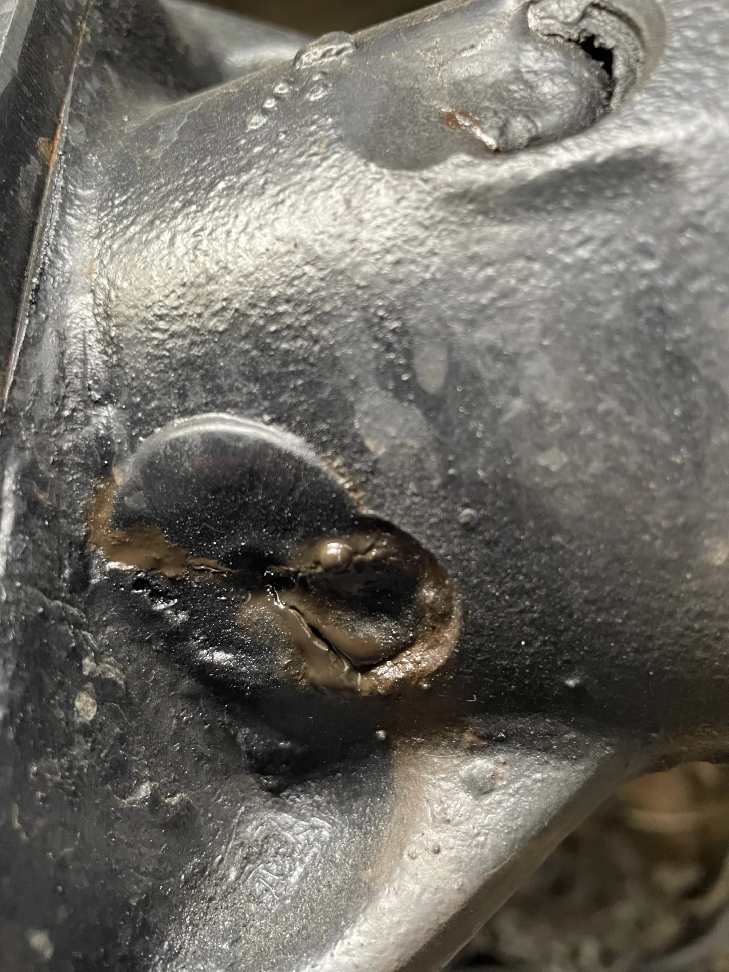

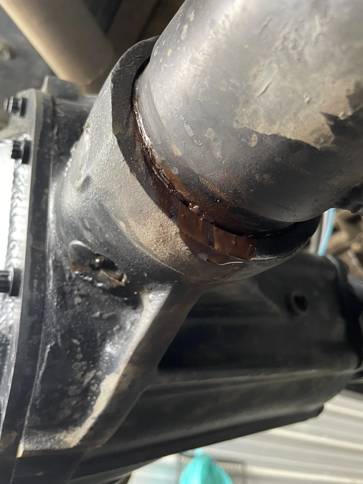

Have you guys ever had this issue? It looks like the plug welds are cracked and the tubes are loose in the pumpkin. Leaking oil.

Pics tell the story. Gotta take it out, drill/gouge the plug welds and reweld, then I'd also seam weld the tubes to the center section. Have an alignment bar with pucs in the spindles+carrier bearings to make sure it doesn't warp.
