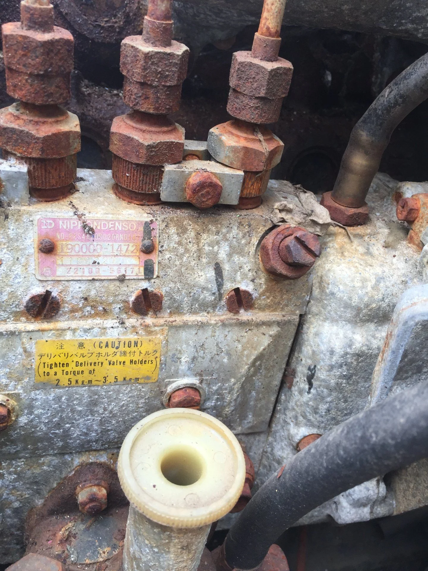

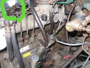

To bleed the air out of the injection system Crack the bleeder screw (circled in yellow) then untwist the pump (circled in red) till it springs up and pump till no more air comes out. Push the pump down and twist closed before closing the bleeder screw. Try that if it's still having problems you are going to have to crack the injector line top nuts all four (circled in green). crank the motor till diesel spills out of all of them, shouldent take long.

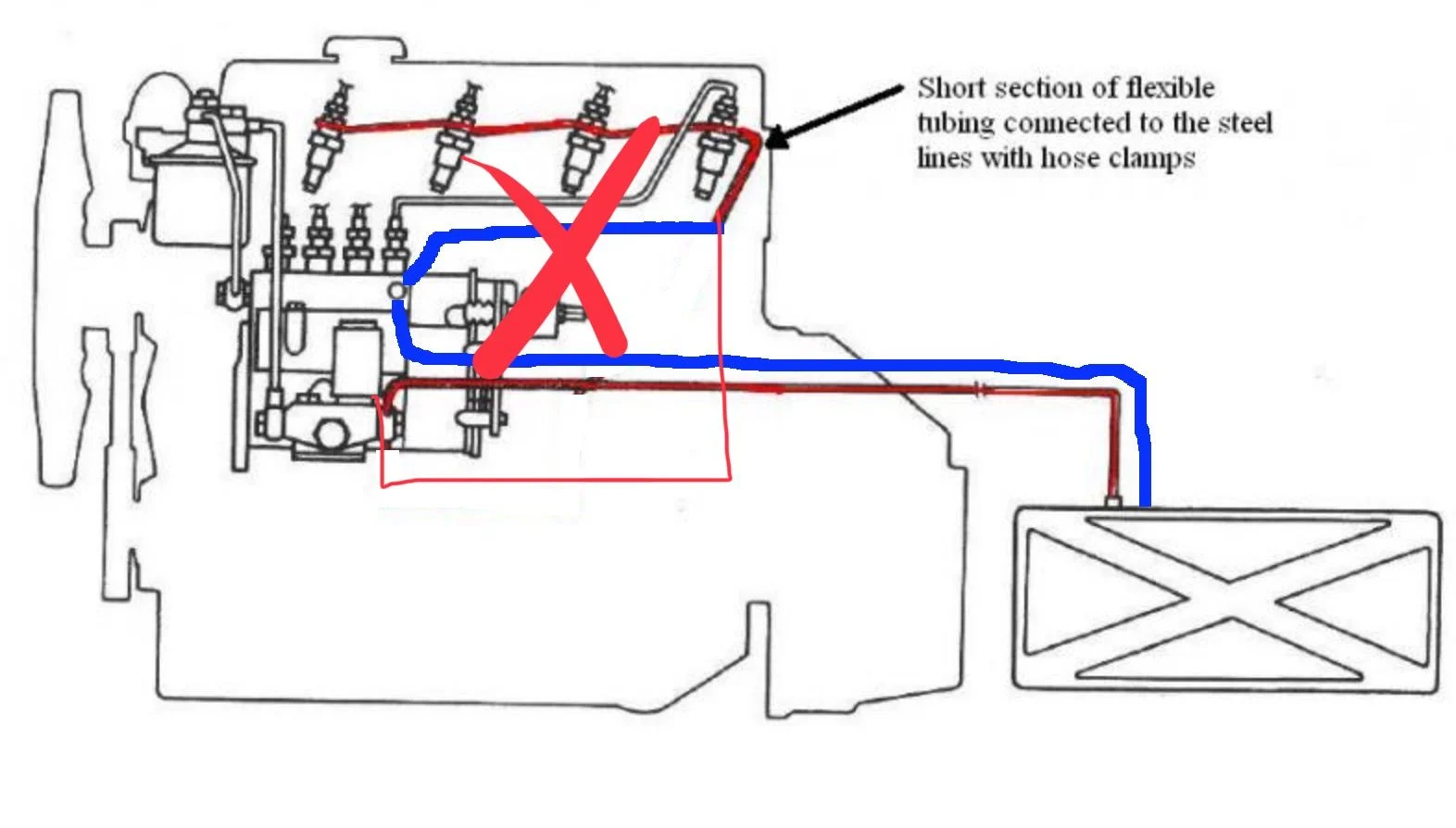

In the meantime, I took a look at the plumbing, and the return line seems to be plumbed into the same input in the injector pump that the injector return line is plumbed into. It's hard to describe so I modified this diagram. It looks like so..

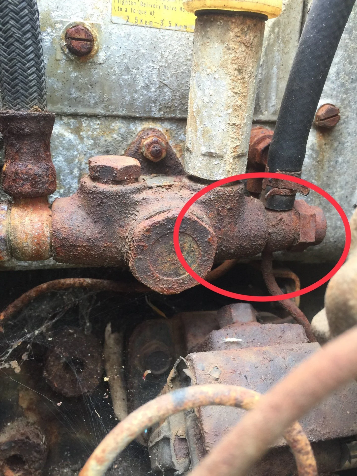

I took some pics of the return lines so you can see it IRL:
the new looking rubber line with the screw clamp is the return line to the tank. The metal line coming over the top of the pump is what the 3" rubber hose connected to the injector common line connects to. You can also see the larger input line from the tank running down into that port thingy that the hand-pump is mounted into .
Here's a closeup of the side of the returns port (does it look like it might be leaking to yall?) ..
The excess fuel should not go to that port on the pump. That might be your issue right there your getting air into that line from the tank return. The return fuel should tie into the same banjo bolt the new fuel does on the primer pump. At least that’s how it is on the 42 and 60 series.

That port your returning the fuel to does...?
It might be sucking air into that part of the pump from your return line to the tank. This system doesn’t need a return to the tank.

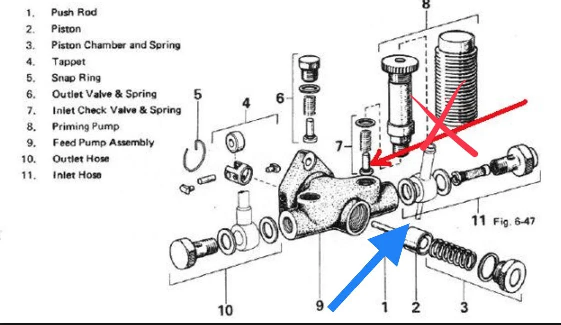

Thanks. Your photo and diagram don't quite match, but I assume your photo is authoritative. The fuel line and return line both terminate at the "inlet hose" side of this part
Is your tank line coming in from the bottom and the return line from the top? What do yall think I should do with my tank return line? just cap it off? Is the pump port my lines are connected to now active in some way? or is just connecting those two hoses together?
Close but it should go here.
Yes pinch off your tank return line and take it for a drive.
This is where a 40 and 60 series return the excess fuel to.
This is what I thought. I think its mainly the rotary pumps that return the fuel to the tank and I think its because this helps to cool the fuel.
Awesome thanks, I ran out of "personal time" today, but I'll see what I can do tomorrow. I have a feeling the banjo bolt down below only has one port on it though. Maybe I can swap the two-ported-bolt up top with the 1-port bolt that's currently down on the inlet thing?
