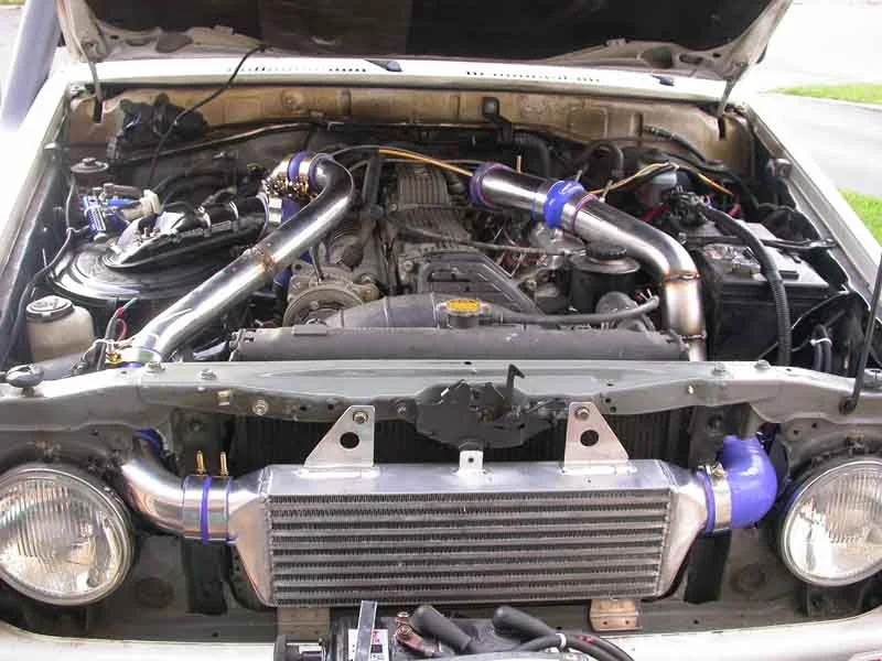

78 2LTE intercooler
Not a 13b-t but same theory. Home made and works great. Been testing for a few months and have had great results.
From outlet of turbo through cooler to inlet of intake there is a 125- 150 deg f drop in temp after a 20 min up hill climb with the hand held laser temp gauge.
Should have done this as soon as I bought the rig. If your not running high boost there is no point. I run 13- 14 pounds of boost. EGT's down and also engine temps.
People seem to be worried about the EGT probe melting off and destroying the engine. With a cooler it will never reach the engine could only destroy the turbo that probably needs a rebuild to begin with.
Only thing was is that the a/c had to go(that didn't work anyways).

The cooler I used was a Vibrant 12800. Check them out online.
520 CFM 26 inches long 6.5 wide by 3.25 thick. this is more than enough for my ct20 turbo and i didn't block off the whole rad.
Not to much turbo lag and efficiency is what i was after.
I have taken my air/air intercooler out of my HZJ79, I replaced it with a water/air type. The air/air did a great job but I wanted to experiment with the water/air type. The air/air made about a 150 degree difference, by that I mean that instead to the EGT's hitting 1200 at a certain speed they would only hit about 1000-1050 and sustain for a while. It worked very well. You could really notice how well it worked when at highway speeds.
It should just bolt in to your truck as the fronts are the same.
If interested in it let me know and we can work something out.
here is the pic: https://forum.ih8mud.com/attachment.php?attachmentid=184280&stc=1&d=1193823774
