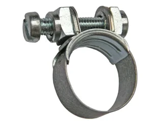

Alternatively you can use two good quality hose clamps like this:
Thanks!! Solid advice. Now, I found replacement metric banjos for making up my own fuel line. Does anyone know the metric banjo size?? Ryan
I think that they are 14mm but I could be wrong and they are 12mm. It's cold and dark outside so I do not want to go and have a look.
As I said before you can easily cut those old crimped tin caps and reuse the original banjo fittings.
