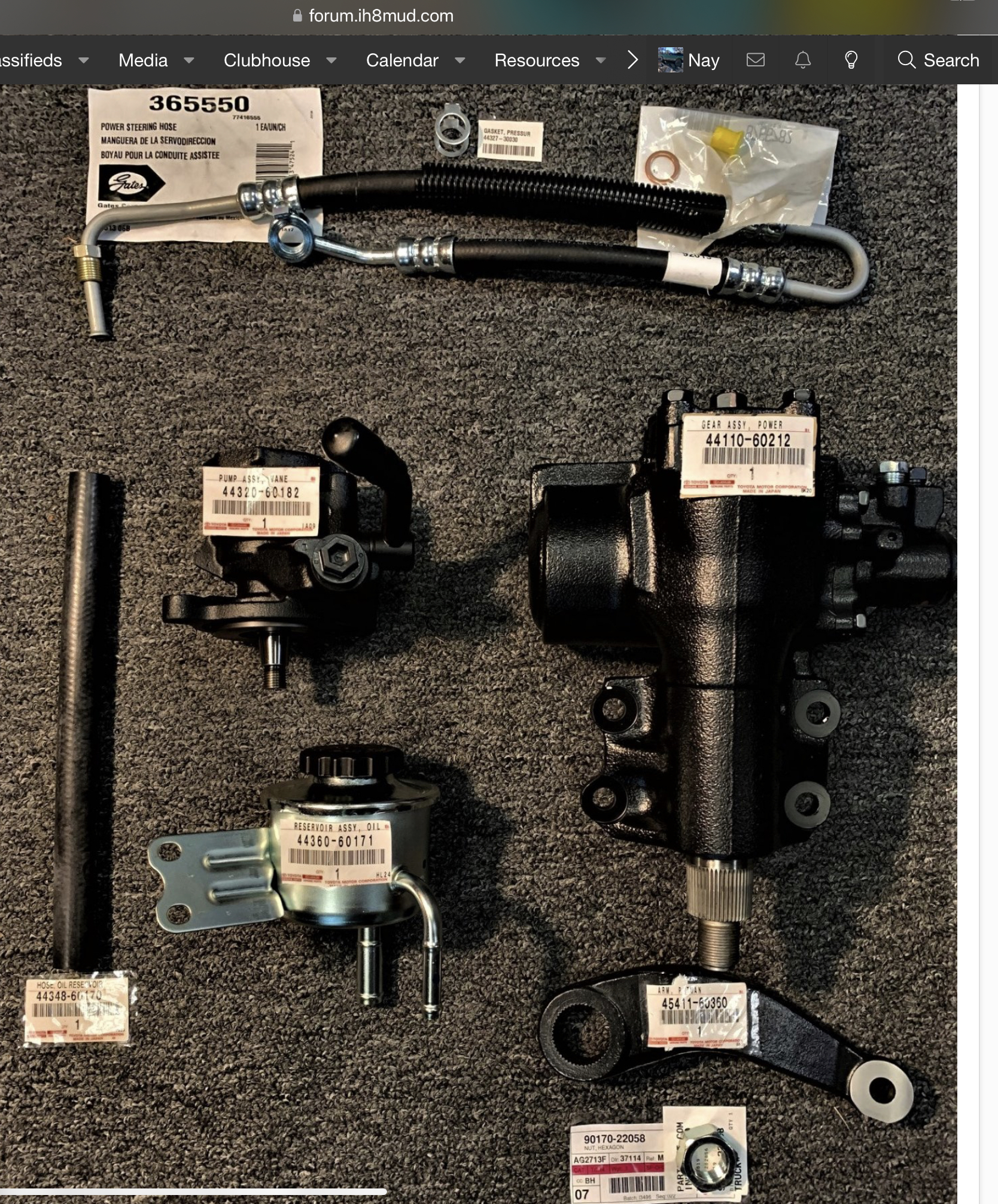

Evening gents, I've been searching for a while but have found part numbers scattered here and there and just trying to confirm the part numbers needed for the 105 steering upgrade. This is what I have so far:
105 series Sector Shaft 44111-60060
105 series Pitman arm 45411-60360
80 series Reseal kit 04445-60050
If these are correct, what would the part number be for the bolts that hold the box to the frame and the castle nut at the bottom of the pitman? Also any other part number that I should tackle while im in there? Getting ready to do a rebuild. Thanks

You'll need the larger nut and lock washer that hold the pitman arm onto the sector shaft as well.
It's called a castle nut in the EPC, but it's just a regular hex nut- no provision for a cotter pin.
Nut, Castle (For Pitman Arm) 90170-22058
Washer, Spring 94511-02200
you should be able to re-use the bolts that hold the steering box to the frame.

45230-60010 is the complete flex coupling assembly. Don’t believe there is a “rag joint” and “coupler” separate from this?
I just bought the 105 box from Impex. $1,178 shipped from Japan at a four decade USD to Yen strength. No brainer.
Impex just uses Toyota OEM part numbers.
