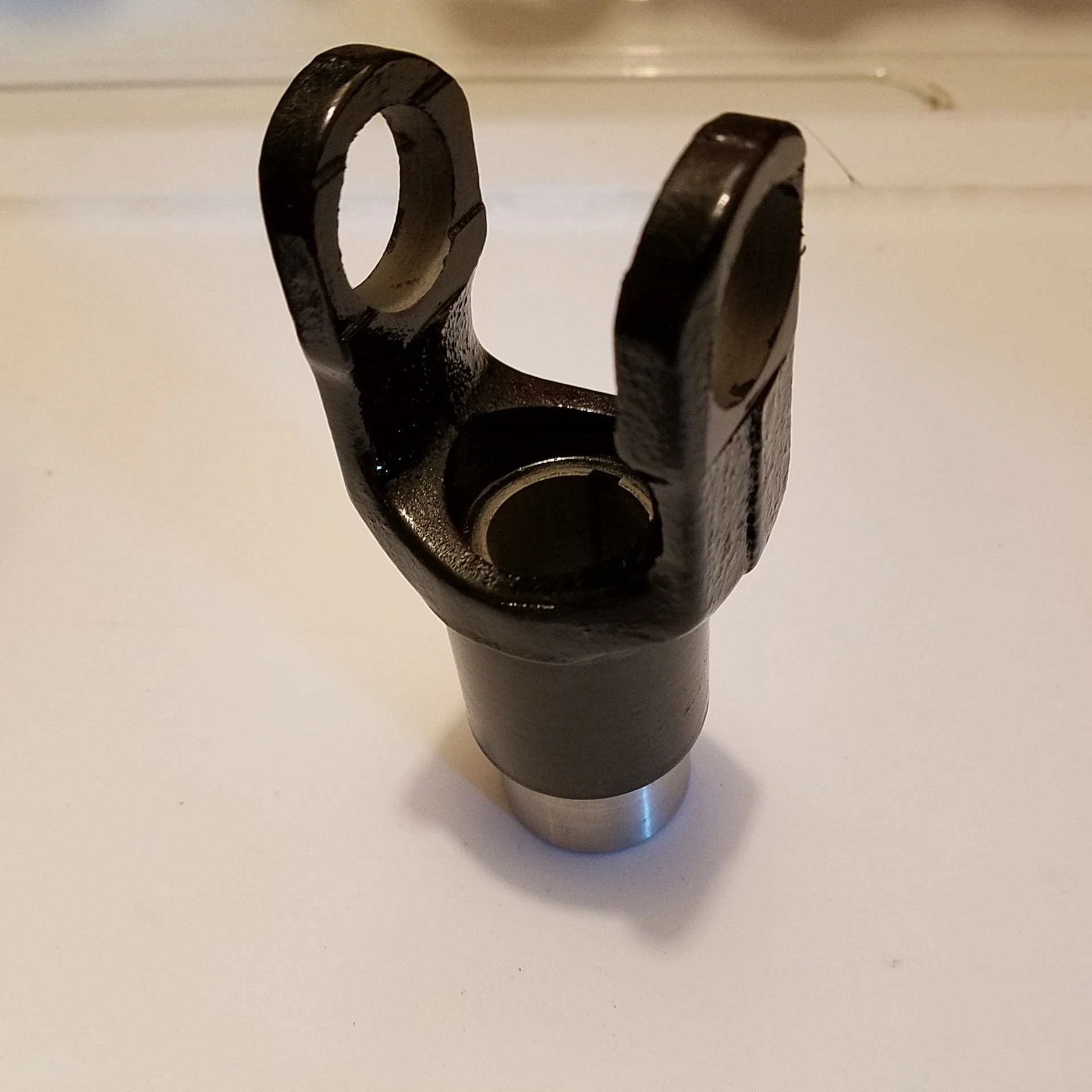

Couldn't find a 1000 series flange yoke to fit Bj60 pto so I came up with this. Shortened 1000 series slip yoke, reamed bore to fit pto shaft, turned down for seal fitted with a 35mm sleeve for the seal.
