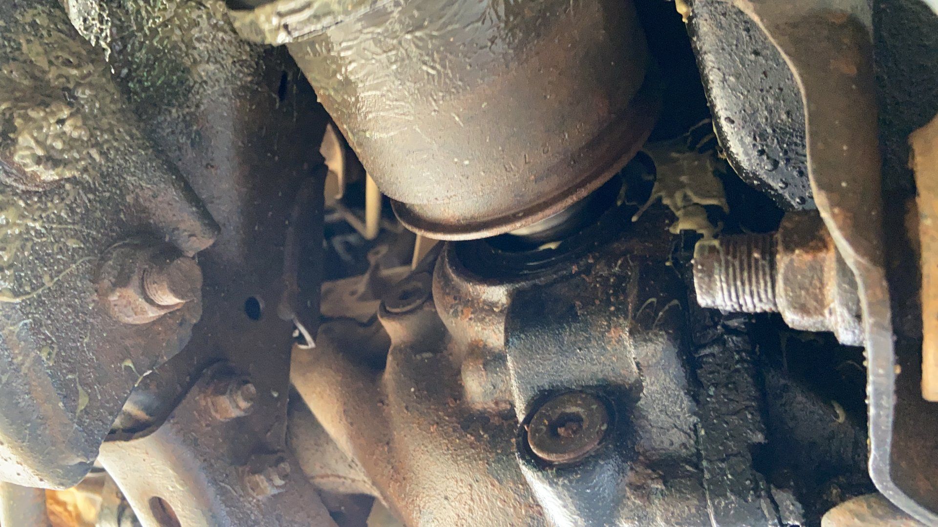

I have a driveline issue which I think is caused by the transfer case. Yesterday 75 miles into a 100 mile journey I was coming down a small hill on paved road. I started to give the vehicle gas but noticed the RPM gauge going all the way high. At the bottom of the hill I gave it gas again but nothing. I came to a stop and couldn’t move again. The car does not move in reverse, drive, 2 nor L not even in 4high or 4low it works. I looked under the vehicle and notice that in drive the front drive shaft spins and in reverse it changes directions so I’m thinking I can rule out the transmission as it is giving power to the front drive shaft. I’m also wondering how the front drive shaft is spinning freely even when I give it gas. That’s puzzling to me. Im suspecting something is disengaged in the transfer case but I am just looking for some opinions. I didn’t hear any “expensive” sound, clunks or anything I just lost power and it never came back.

Thanks for your reply.
The issue is the rear drive shaft isn’t spinning at all in any gear so I was unable to move. But while in drive or reverse the front drive shaft spins freely but I get no movement from the rear drive shaft. I’m so confused as to what the problem could be. It’s as if something is not engaging in the transfer case.

I press it on and off repeatedly but nothing happens. From the time I owned the vehicle the diff lock light did not work so I’m unaware if it engages or not. I will continue to try and see if I have any luck.

These awd systems can be funny if you don't fully understand how they work. Your t case when not locked is a 3rd open differential. And open differentials send power to the tire with least resistance. If you broke a front cv that's where the power is going. It would be why your front drive shaft spins and why the read dose not.
Try locking the center diff. I don't know these well so I may need help. But I expect you may need to be in 4low? If your lucky it will work in 4 high.

I had the vehicle towed to my house. I am trying with the diff as we speak. Another thing I am noticing is that I can push the vehicle while it is in park. Not good if you ask me
All your symptoms are consistent with a failed front outboard CV joint spline.

This statement led me to the problem. I check my CV and sure enough it slipped out. Had it removed and inserted a new spring clip and it’s good to go now. Thanks you all for the help.
