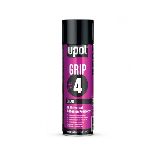

This is what i've used with great success, works really well in situations where sanding is near impossible.
We use a lot of Upol products in the shop. Has great spray characteristics, probably the best of any aerosols.
Raptor has their own branded adhesion promoter too.
