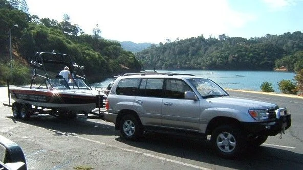

My trailer is at 4000 pounds and feels right. 6500 might be OK if your staying on the flatland, but I would not do any substantial elevation climbs with that weight. Also I would order some springs right away if you do start towing something that heavy. With the tongue of 650 your going to need OME 863's or call Slee off Road and ask their advice. This is my fourth trailer and fifth tow vehicle, and by far the most matched pair I've owned. Pictures here
I tow boats also and 4500 to 5000 feels different from the 4000 of the camp trailer. Ask the seller if you can test tow the trailer to see how it does.

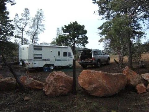

Oooooo, trailer (caravan!) pictures - yummy...
Here's one of mine:
No big air con box on the roof like you though - d'oh!
My 100 is stock - you reckon it needs springs to pull this? How's that gonna sit with the AHC?
Sword
Edit: ps - for any of you UK Caravan geeks, its a 2006 Swift Conqueror 650 Lux with the extra bunk fitted. Got it from a stock broker who bought it new and tried it for 2 nights before selling at a huge loss cos he couldn't stand the fuss! Turns out that there were a few bugs that he probably didn't pick up on (eg water pump switch incorrectly labelled between internal and external tanks, lol). All sorted under warrantee now :-)
