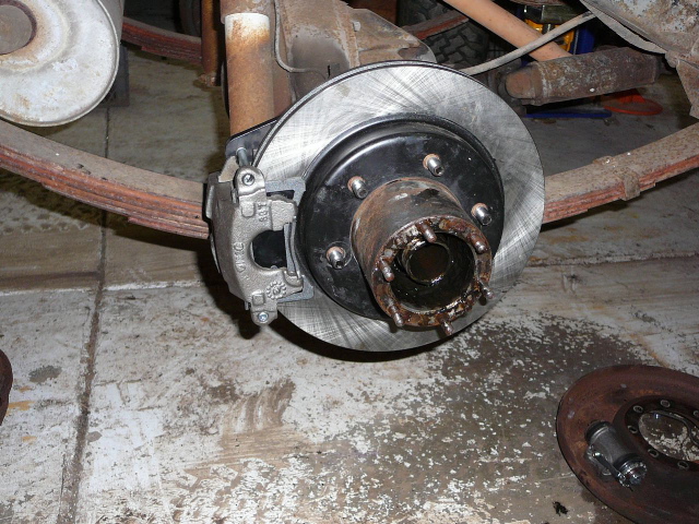

1ton will likely be a full-floater. the hub will protrude out of the wheel and have a cap with nuts and cone-washers. like you see on a dually.
like so:
Did they ever make it without being a dualie? I got the 1 ton brakes on the front and I am trying to find out if they made the 1 tons without being a dualie or if someone had just done a brake swap. Done slot of reading and stuff but cant find much, church I'd check here you know lol
