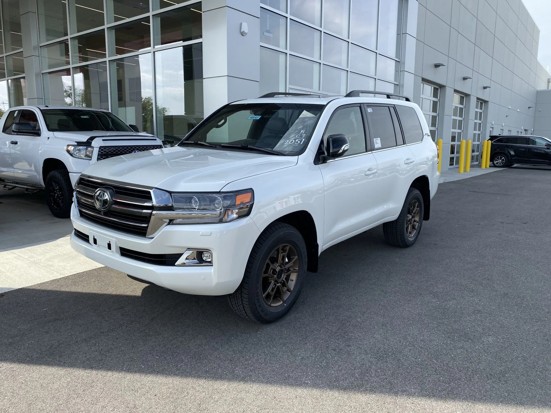

I have spent the better part of the past 5-months thinking about this build, my “halo” project. I had every intention of keeping it for myself, but as the price kept growing and growing, it’s made me reconsider if it’s a little out of my league. In any event, the build will continue, as I see it it should be, whether I buy it or not.
I knew that I wanted to go “all-out” and make a truly one-of-a-kind 200 (hence the decision to use a Heritage). I wanted to make something that would be a “top 5” of the coolest builds I’ve seen on Mud or elsewhere. Of course, that is subjective, as each of us have our own ideas of what is the proper way of doing things and I respect that... We each have our own applications for use.. and we each have our own personal styles. This just happens to be “my style”. The name/title of this truck/build thread is “+1” in subtle reference to “one-upping” someone. Not humble, but again, it’s my Halo project ;)

Info: 2020 Toyota Land Cruiser 200 Heritage Edition (model code 6157)
Tribute to 60-plus years of off-road heritage (third row delete, cool box delete, lower door molding delete, bronze-colored BBS forged 18” TRD wheels, Heritage grille, vintage Land Cruiser badge (D-pillars), bronze contrast stitched perforated leather, blackened headlamps, blackened chrome accents (tribute description copied from Toyota and slightly modified by me).
Blizzard Pearl (070) / Black leather (25)
VIN: JTMCY7AJ4L4086402
Miles: 2
Port Installed Accessories: First aid kit (3Z), 7 pin to 4 pin adapter (4P), Cargo net (GN), Universal tablet holder (U7), Glass break sensor (V2)

Before
Looking forward to the after pics.
