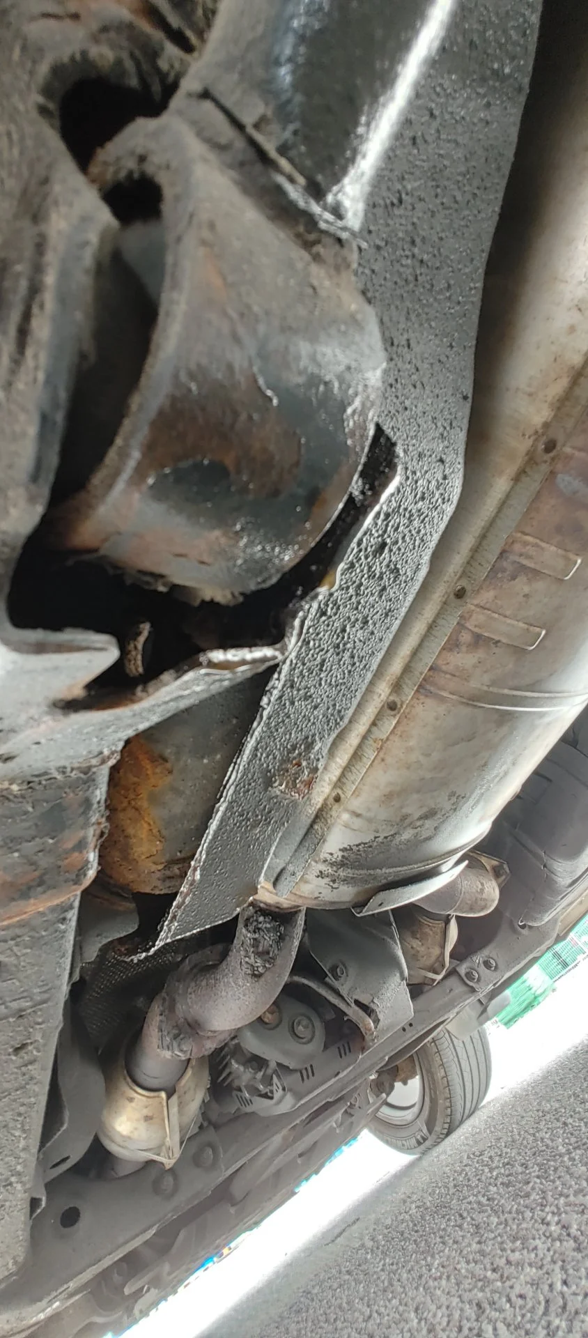

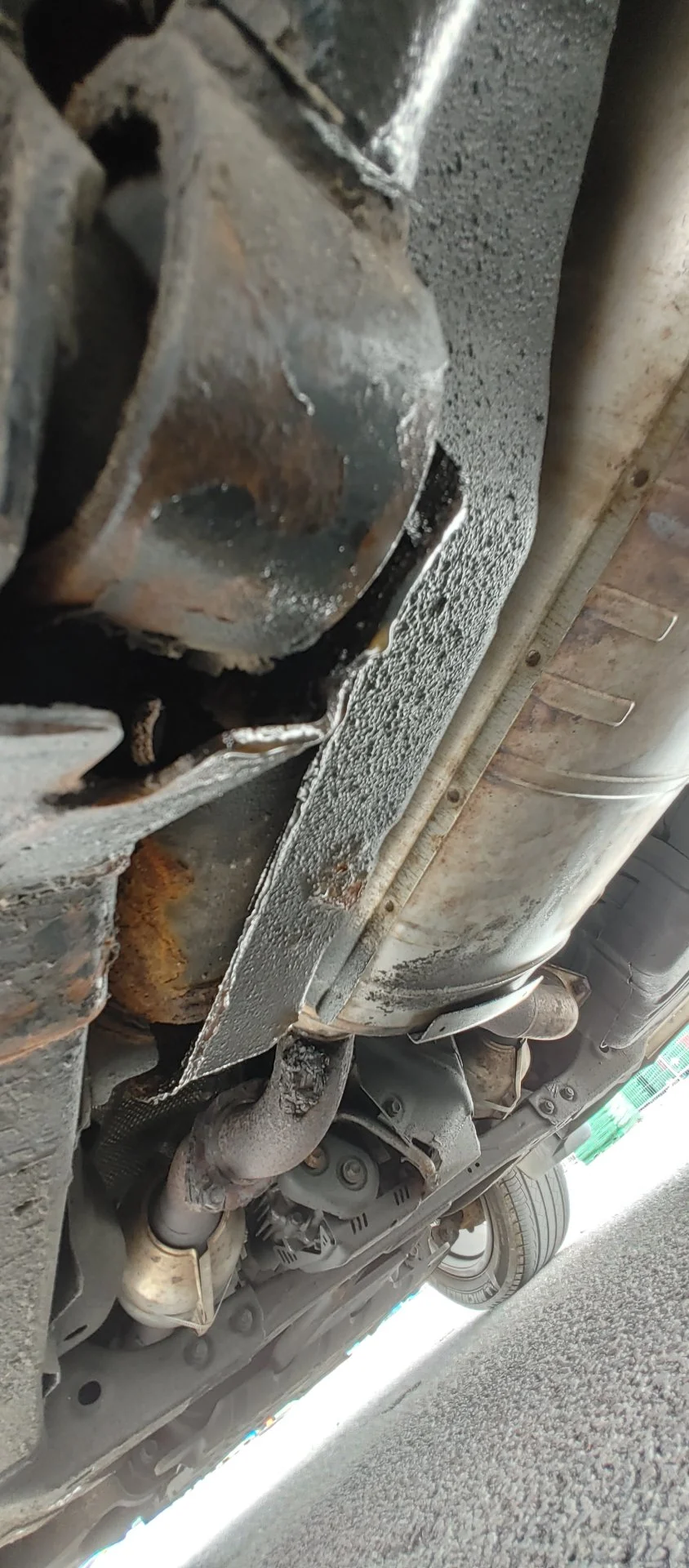

Hello all,
I just joined the forum looking for advice. I searched as many thread as I could find.
I purchased a 2010 lx570 with 219k kms. 1 month ago.
I live in Toronto Canada.
Was planning to do ahc fluid flush as I believe It has not been done. Called Lexus and told me they do not know about flush.
My problem:
I have been seeing drips of fluid coming from my rear drivers side from the plastic ahc lines for about a month after parking it. I did not know what it was until recently.
I took the truck offroad which was great. I raised the suspension and lowered it to N.
A little while later I got the Check 4 wheel ahc and truck drooped.
I drove 100kms home in the Low position and then parked it. Started it up and put it on 4Low to see if it would raise. I heard the pump and little movement then nothing. Went underneath the driver side in front of rear wheel considerable fluid leaking.
HELP!!!
unfortunately you probably have a rusted thru line. The one that has rusted thru most commonly (though it is still a rare occurence) goes across one of the rear frame crossmembers to the other side of the vehicle. Fluid can pool on the cross-member, and the line eventually rusts through.
Grab the FSM from that thread, or use the online parts guide to see the routing, and start following the drips back to the source.
As far as fluid, you'll need to fix the leak before you can repressurize the system.
There have been 3 or 4 of these over the last couple years.
Another option is to replace the AHC system with a basic suspension (springs and shocks). You'll lose automatic height, and the sway bars won't be totally adequate for very sporty driving, but several have done it and are getting along fine.
Thank you for this. I will see my mechanic on Tuesday and I will check the FSM.
Based on what you said, it is a line right? Not the pump or any components. Is that correct?
You’ll have to follow the leak back - it could be at the pump to hardline transition, but I think it’s more likely one of the service lines, and even more likely the cross body line at the back crossmember.
Thank you so much sir! I will update you this coming week once I get the truck in to my mechanic!!!
