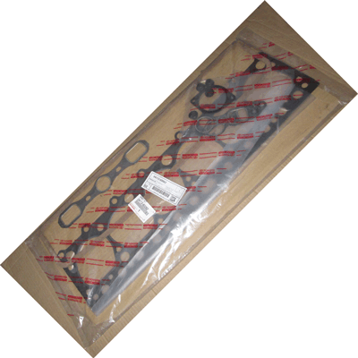

Looks like FJParts still has some 1F gaskets.
@pigvalve were you pleased with the quality? Japanese bearings? American forged pistons?
The pistons are ITM which are cast. The machine shop that I used has used lots of ITM products and has had no complaints, seem to be good quality. The bearings are Mahle Clevite and the gasket set is Felpro. I have not asssembled the engine yet. I am debating sending the cam and lifters to Delta Camshaft to see if they can be refurbished. I would prefer to use as much oem stuff as possible but when it came to pistons I didn't have any other options.
That is for the early F135. When I bought my 70 FJ40 for the original owner he gave me all his old cruiser parts. Pretty sure that had a valve over haul gasket kit for his 63 FJ40 he had previously. Could possibly be OEM. Have a couple kits that could be F145 and early 2F.
