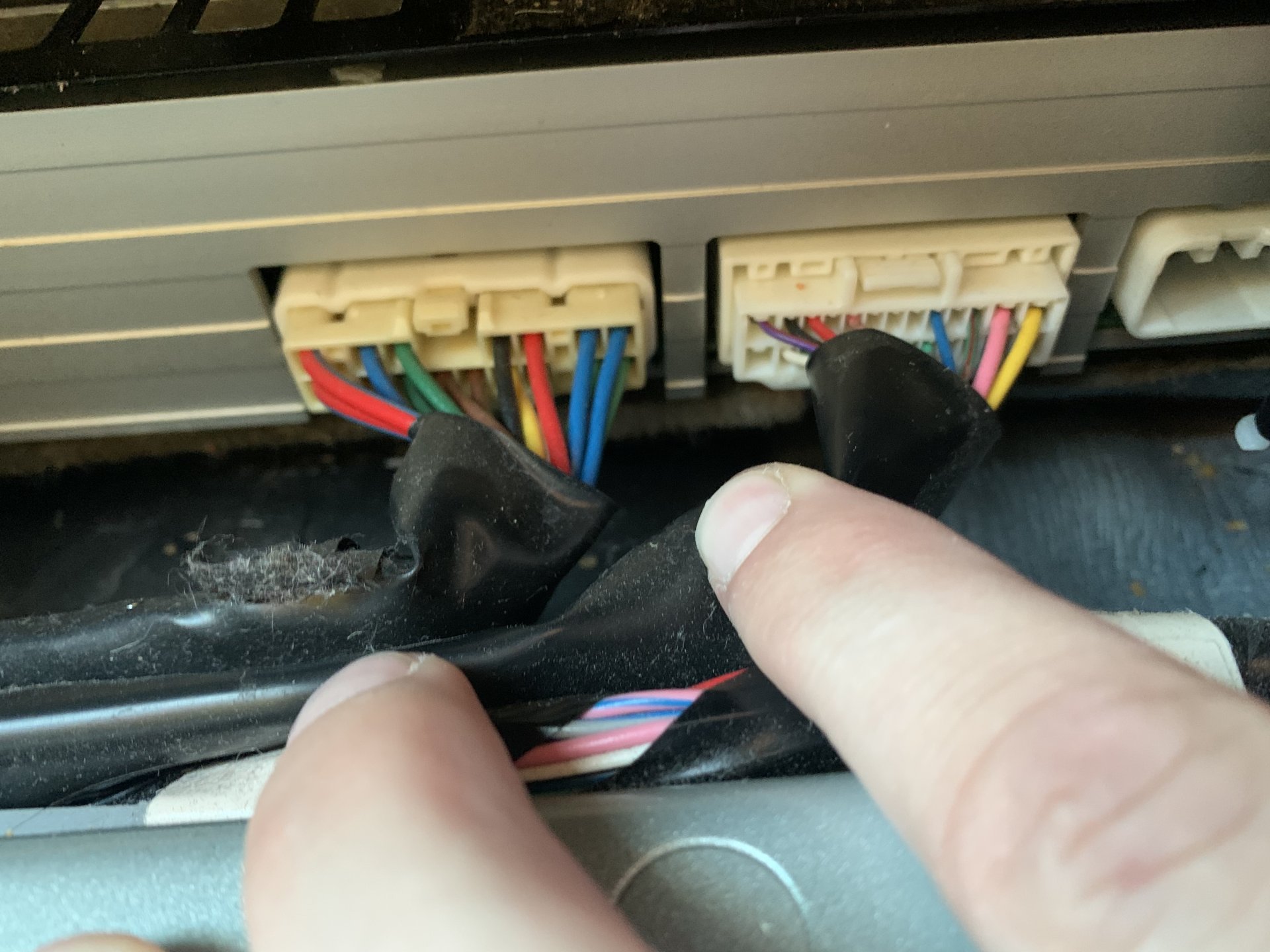

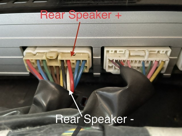

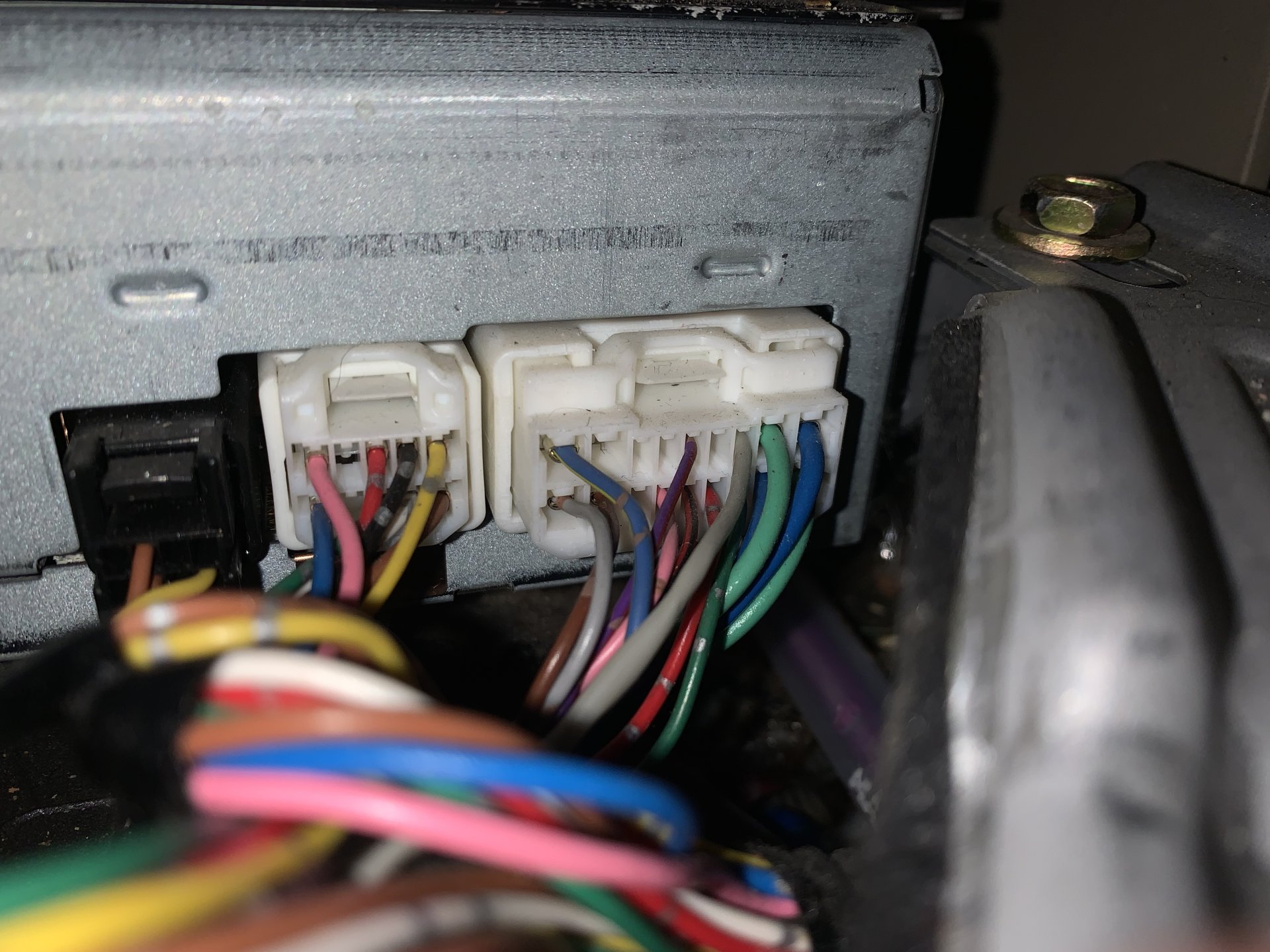

Like the title says I am wondering if anyone can help me figure out the wiring that goes to the rear subwoofer in my 04 GX. It has the drop down DVD player in it. There is a great thread about installing g the sub and I have included those photos. Trying to identify the same wires on the 05 on my 04.
The first two photos are the 05 example and the third photo is my wiring on the 04. Really appreciate any help. Thanks!!

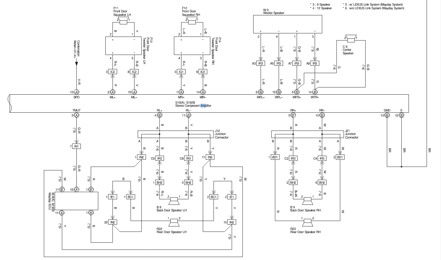

This is for an 03 but its probably the same
UPDATE:
As usual I am a moron. The wiring harness I was looking for was under the drivers seat not the passenger seat as it was in my 05. It makes sense as well with having the rear entertainment system. Should be a breeze hooking up my sub now. This is a great mod for a little extra bass with very little difficulty.
