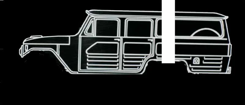

Here is where I would stretch the LV length wise... allowing me to keep the look pretty standard and giving me room for bigger meats on the rear.

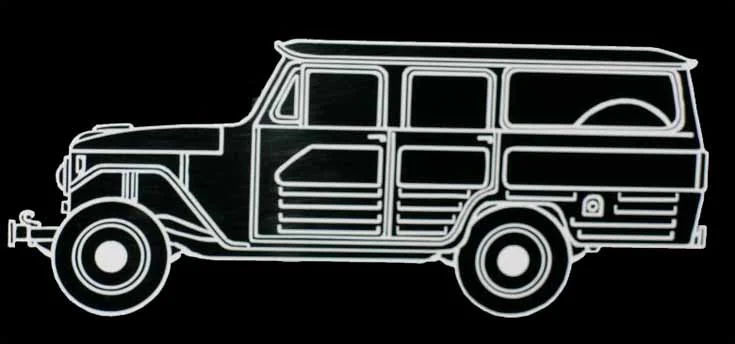

Using Treeroot's sticker (without permission doh!) This is what it will look like.

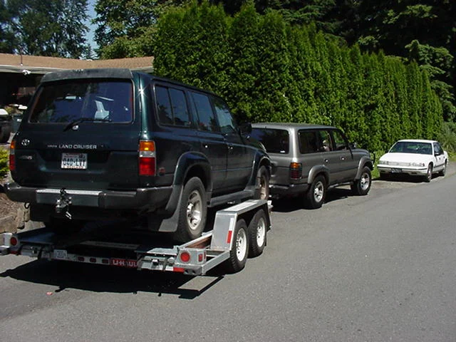

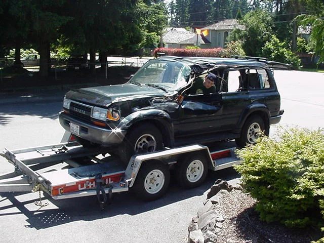

Got some done on this today. Picked up the 80 series. The owner said he couldn't get it started. Upon arrival, a quick swap of batteries did the trick. There was some sputtering at first, but it had been around 4 months sinces it worked last.
It was nice driving it up onto the car trailer. My 19.95 com-a-long (twice broken) takes longer to load. I pulled this 80 with my 80 and it did pretty good. On the steep hills the temp guage would climb and the mph would drop... but 40mph was a minimal speed with 70 being the max. It towed really well.
Once home, I took a few pictures and cleaned the rig out. The drivers side glass was busted out except for the last panel in the rear slider glass. With the purchase of this rig, I also purchased $2.48 worth in change, a 4" pipe wrench, a new tarp, some nice bungee cords, a phillips screwdriver and a few other misc stuff that escapes me.

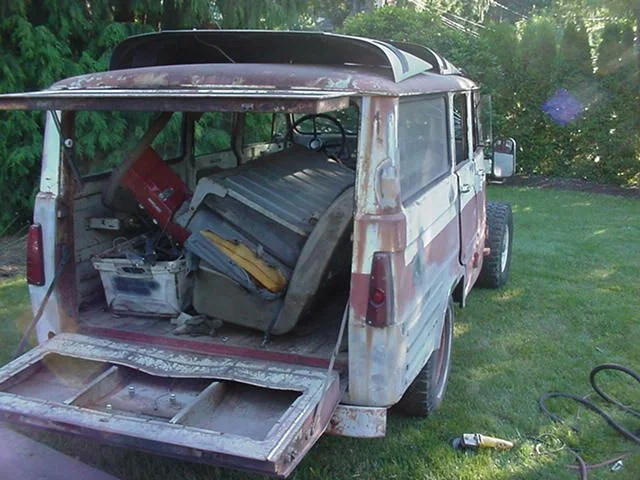

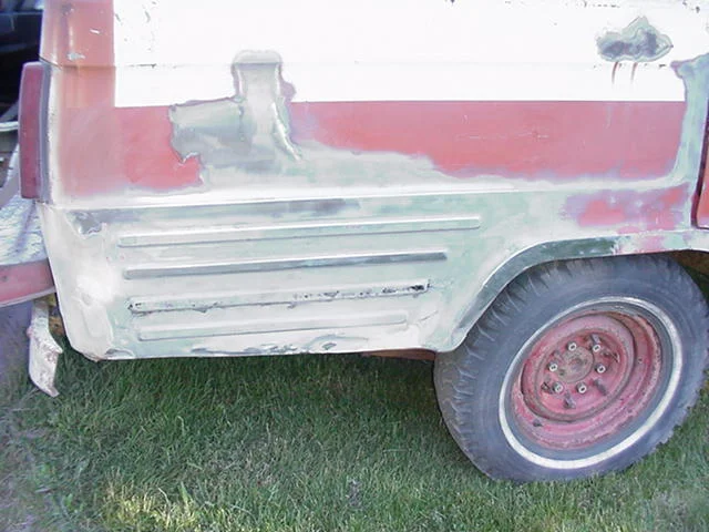

After cleaning the 80 out I posted the body parts for sale and went out to the LV. I've named the LV Brando... which will change once the shell is on the 80. Turned on the compressor and blasted the rear rib quarter on em. There is some rust through and there was about 1/4" of bondo around the rear and under the lowest rib.
The first step in this conversion will be to get brando's body to 95% straight and complete. Then cutting him in quarters, extending and widening the body to fit on the 80.

This was confirmed today. The place that this happened was right by his house and we drove by it. Its perfect for this build. The only damage this truck took was to the roof, left side of the truck... from the wheel well up. If you look at the pictures you will see tree chaff and tree bark in the windshield. The grain is running vertical. There was absolutely no dirt, sand, grass or gravel in the wrecked part of this rig. The rig simply went into a ditch and got stopped by trees (saving it from flipping over). The other part of the guys story (only going 30 mph) is also justifiable. He is 62 and the road was a 35mph zone... and pretty straight. Was real close to his house.
Went around 40mph down my local street... smooth and straight... no wobble, no leaks. The PO had just spent $2k getting the brakes done and knuckles rebuilt.
Overall, very stoked about this truck.
