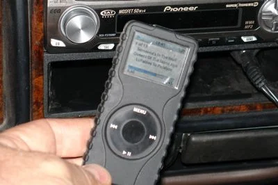

I scrapped the sat radio idea and got a iPod Nano and run a hard line from the AUX input of my deck to the iPod. The line is long enough that I can set the Nano anywhere around the 2 front seats. I download my music at 192kbps rather than the standard 128, for a slightly better quality. I sacrificed quantity in the 4gb iPod though. I got about 700 songs in it.

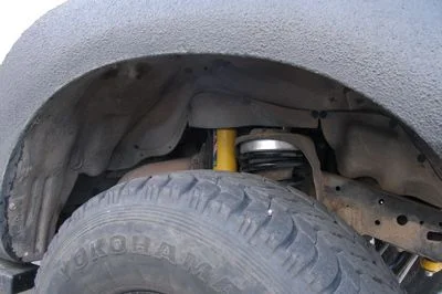

Durabak'ed my rig https://forum.ih8mud.com/showthread.php?t=68942

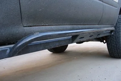

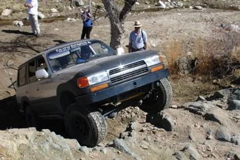

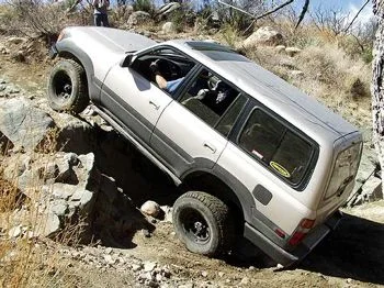

I got some Slee sliders. Easy install, but I kinda wish I had done my own. His sliders are good and stout, but I sacrificed more clearance than I had thought I would. I'm brewing a plan to modify them and my rocker panels to get about 3 more inches of clearance. In the meantime, I have done my best to abuse the sliders by rubbing off lots of powdercoat on the Southern AZ rocks.
