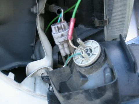

1. Remove the side marker to be working on: Open the hood and remove a single screw that hold the light housing on. Take it off by gently apply pressure evenly on the rear housing pulling forward.

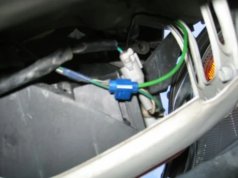

2. Tap 1ft of electrical wire into the (pulsing) positive lead (the green one) on the front signal light using the self-tapping connector - this is easily done laying on the ground looking up.
3. Feed the new wire up the same path as the original wiring.
4. This is the main part: cut the ground feed (white with black stripe) on the side marker wirings (I cut in the middle of the connectors on the light housing since this is a simple part just in case I want to restore the original wirings or replacing it.)
5. Finally, strip and connect the new wire to the white/black end of the side marker light using the butt connector. Shorten the new wire as needed to make it looks neat. You could leave the other end of the white/black wire dangling as it's just a ground.
==> Reinstall the light housing and you're DONE!
