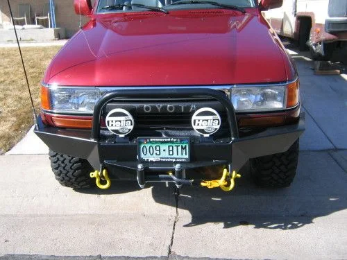

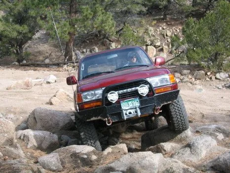

Here are a couple of non Poser Pics
Same color as my 92, i like white and this red the most.
I like how it looks without the flares in the last pic, nice rivetted look

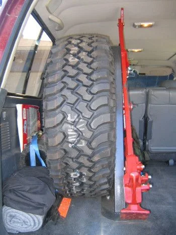

[Custom Interior Tire Carrier / Highlift Mount]
can you post a pic of this? Tell me more about it?
The tire carrier is built out of 2" square tube and some 3/8" plate. I bolted to the floor where the 3rd row seats mounted.

Just make sure you put the tallest passenger that you like the least in the drivers side rear seat. If they are tall enough, one rear end collision and that's that! The end of that hi-lift..yikes!
I'm a fireman, and I see all kinds of crazy stuff that happens as a result of vehicle accidents. If it's possible to reverse the mounting of that jack (base towards the front of the rig, "top" towards the rear), it would be a lot safer for your passengers.
Course, I'm only 5'8", so it would take an act of a higher power for me to hit my head on that thing...:rolleyes:
Nice rig, clean and simple looking. I'm gonna fab up some thing similar for my spare. Been thinking of it for a while, as it would be nice to keep the spare inside after I add an aux gas tank. Probably gonna use the seat bracket holes on the wheel well, and the seat belt mount as my attachment points. Yours looks nice and sturdy.

sethro Just make sure you put the tallest passenger that you like the least in the drivers side rear seat. If they are tall enough, one rear end collision and that's that! The end of that hi-lift..yikes!
sethro the pics dont really do justice to angle that the hilift is at . Looked at the other direction but it did not fit right but point taken.
