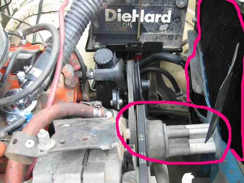

I went from this:
To this:

Worked the first freaken time. :D
Only cost me:
$35 Fan - Local Pick and Pull
$60 Big Relay - ST85 - Napa
$19.95 - "Fan Relay Kit" - Advance Auto Parts
$14.95 - Extra relay - Standard 40A light relay - Advance Auto Parts
$19.99 - Adjustable temp controller and probe. - JC Whitney
$30 - Odd and ends - connectors - tape - cable management
Comes on @ 185, high kicks in @~220. Everything hooked to the battery so no key intervention ect...
Does anyone with a taurus fan notice how little these things come on? It has been cool in Colorado, but it came on 4 times on my way to work. Approx 20 minutes of some highway and lots of stop and go. I was amazed. Puts alot more in the pedal too.
I will try and post up my schematic later.

Couldn't find a good setup with a fan clutch with the length of extention that I needed and I didn't have a fan shroud, so I figured I could kill two birds with one stone and go electric.
Below pic is my schematic.
