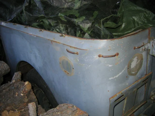

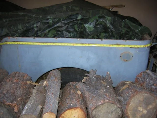

Could someone with a factory soft top from a 1960 "B" type top, with top bows similar to an FJ40 do a lay out of the Twist Snap holes? Perhaps start at the tailgate opening and round the corner foward to the front door opening and jot down the spacing of the Factory holes. I think I have over 100 non factory holes to weld up on this FJ25. My record is 220 holes on a FJ40 tub, so this 25 is in excellent shape! Thanks in advance. John Pardi
I measured the twists this weekend. There are none in the corner and six along the side. First is 18 3/4" second 26 1/2" third 34 1/2" fourth 41 3/4" fifth 49 3/8 sixth 57 1/8. These were measured from the tailgate forward.
John
John
WOW john,
I always love to see a well protected FJ25 like this. :D
By the way soft top holes are same for TYPE-A too.
