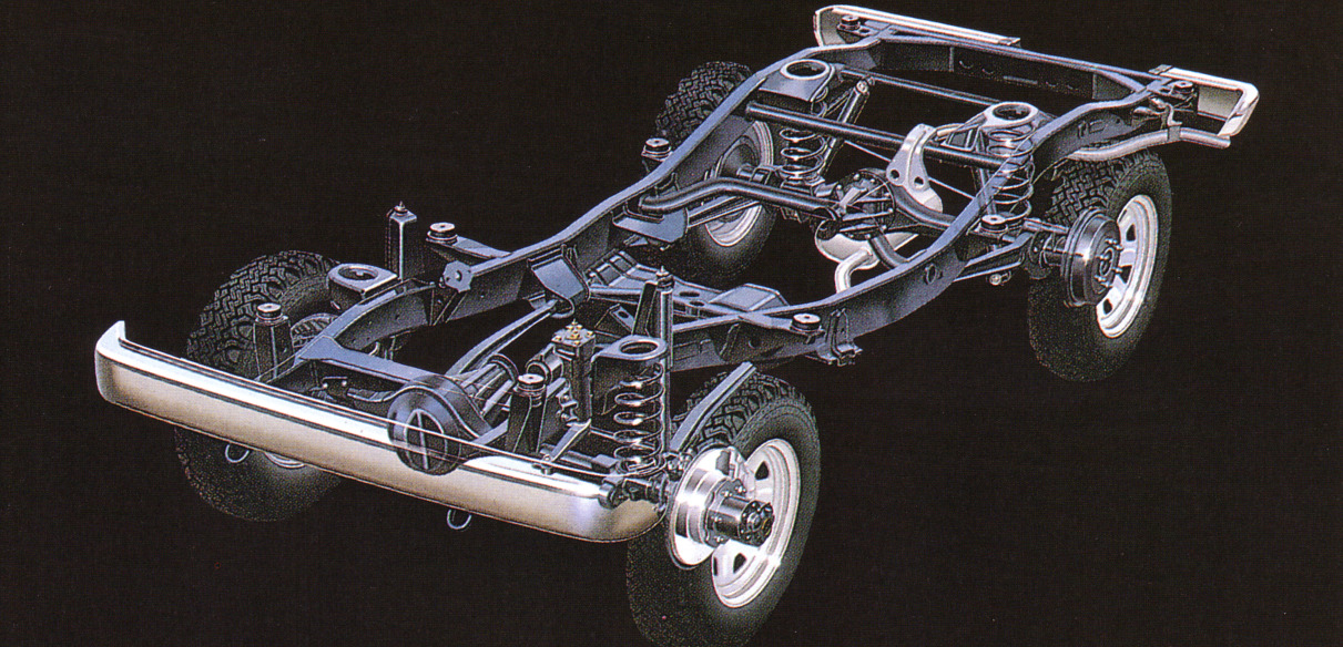

Hi everyone. I'm getting ready to enexpectedly turn my resto project from being mild resto "with attitude" to become a serious project, but it still remain street legal all-terrain category, no extreme off-road. Main thing is that i decided to swap a frame with coil suspension from 70-series Land Cruiser, a 1990 LJ72.
here's frame picture (it is frame of pre-90 rig, but it is the same except few details - front shocks on 90+ are mounted inside coils, trailing arms has eye-type mounts to the frame etc...)
Axles will be swapped too, they came from KZJ78 - 8" housings, 8.5" R&Ps with 4.875 ratio, disc brakes on all 4 corners. Steering setup is taken from 80 (box) and 60 (pump). Engine will remain stock 40's 3liter diesel "B", gearbox will be swapped to the same, but 5-speed unit from BJ60 (60 with 3.4liter "3B" diesel).
