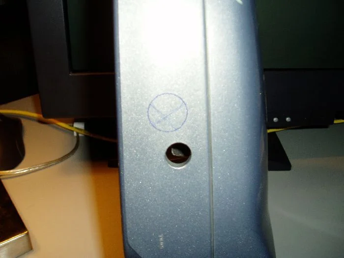

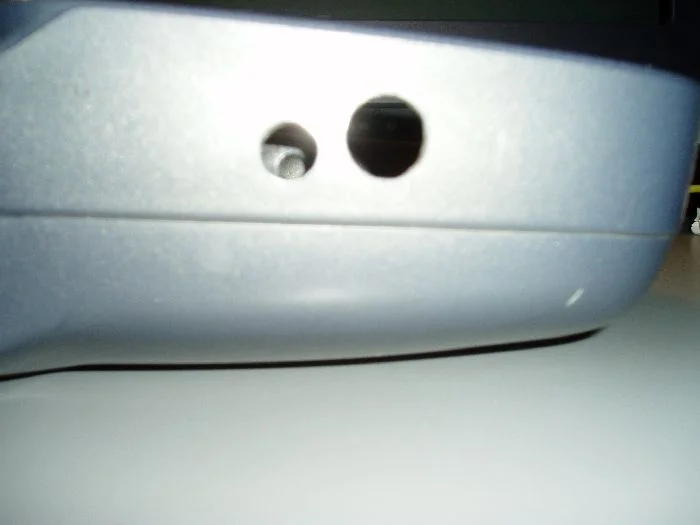

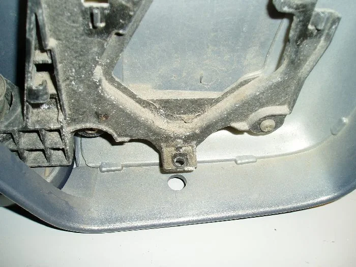

Step-1 : Adding another larger hole on the lower mirror housing
To guide me in hole placement, I took the plastic gasket off the new signal, and placed it on the lower mirror housing. I had a few objectives in mind in regards to hole placement:
1 - Keep the signal as close to mirror centre as possible.
2 - Retain the mirrors highest range of motion.
3 - Allow access thru the signal housing to mirror motor screw.
4 - Placement of signal on a flat portion of the mirror housing.

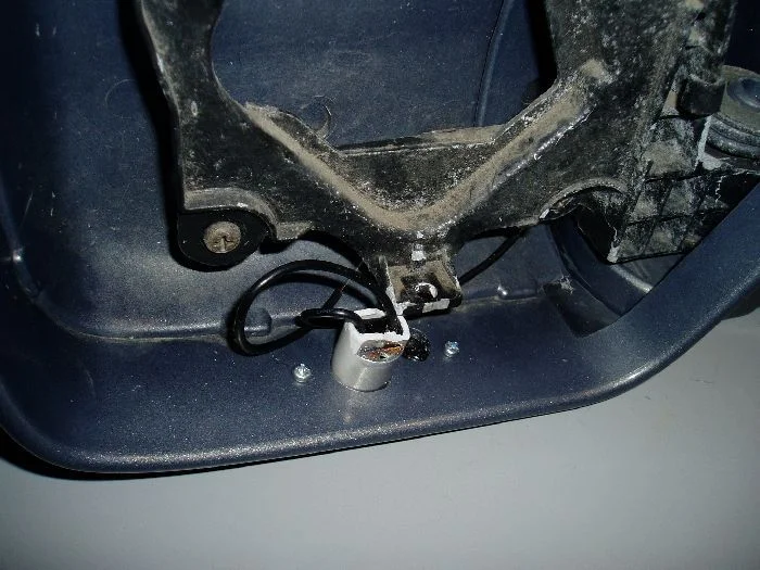

Next I ground down the signal housing to fit in, and beside the motor mounting screw.

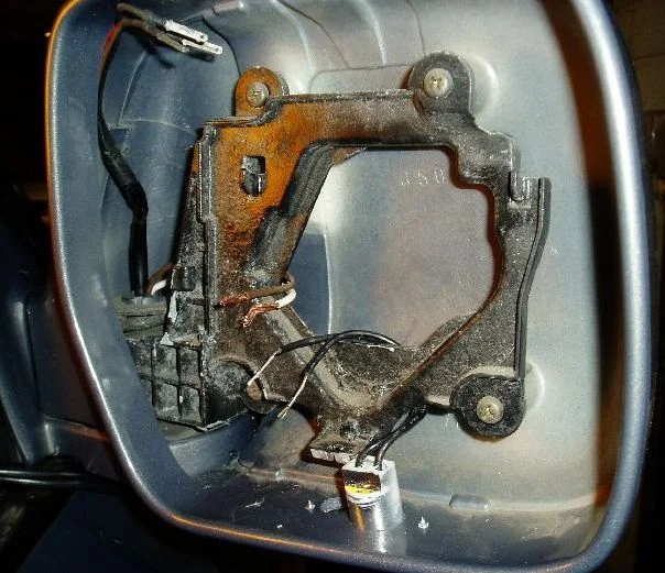

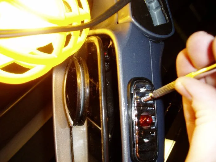

Wiring it was a lil tight, and getting the motor screw into place thru the space between the mirror and the housing was challenging. Once in place I used my largest micro screw driver to drive it in thru a hole I had pre-drilled into the signal's reflector.

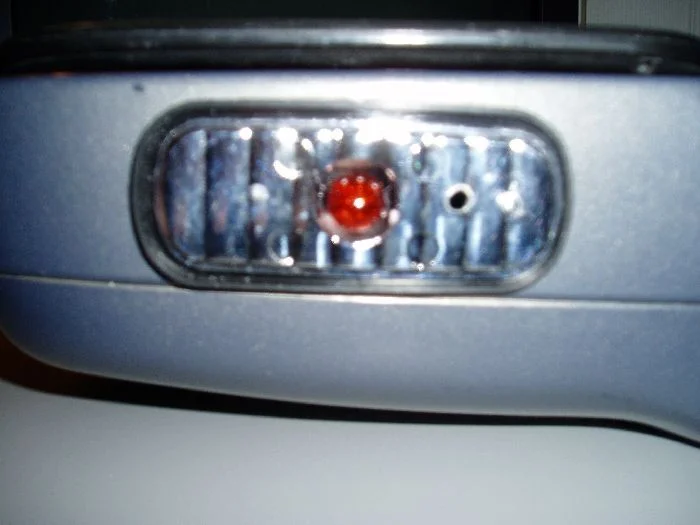

Once the wiring was complete, and the motor secured, it was just a matter of re-attaching the signal lense. Then the mirror housing bolts were tightened and the molding replaced.

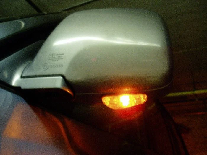

Another pic or two..

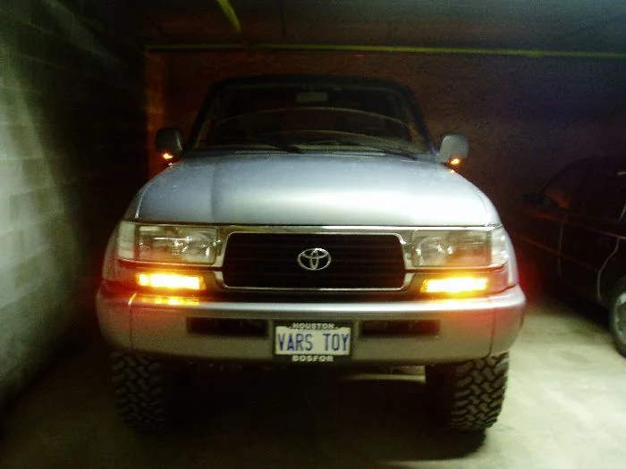

Thanx guys. The clear lense on these signals gives them a bright, clean look that I was looking for.

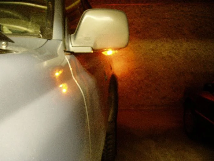

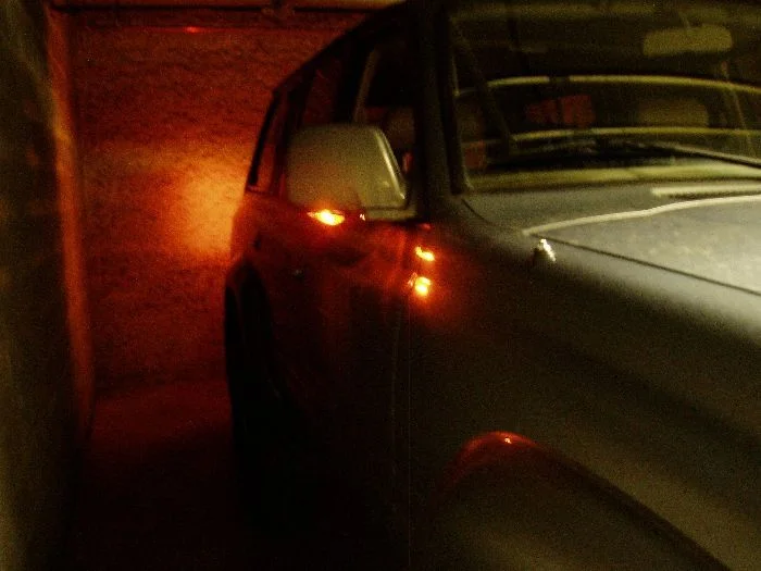

In the pictures, the lenses look rather bright. At nite they are just nice I find...not too garrish, but quite enough to put a smile on my face, and let traffic know my intent. The smile is because my old amber lenses developed a loose connection that kept shorting out the fuse. It was an internal short in the fixture, and the way I had gooped the old ones into the plastic inserts it would have been a lot of work to repair. Hence these clean, bright...clear :D replacements are quite a nice upgrade. And no blown fuses!

A few more pics. One of the 80 in the brighter garage lighting....you can see the signals aren't overpowering. In the other shot are the wires coming from outside the door frame, into the mirror housing. I eventually connected them up behind the mirror mounting frame; out of the way. The black wires in the lower left of that frame are from my utility light off the battery, and are NOT part of the wiring here. I don't want to confuse someone as to where the wiring for the lights are coming from. The signal wiring comes in from the interior side of the door, thru the corner of the triangular mirror bolt cover, and once inserted thru there, follows the same route as the mirror motor wiring.
