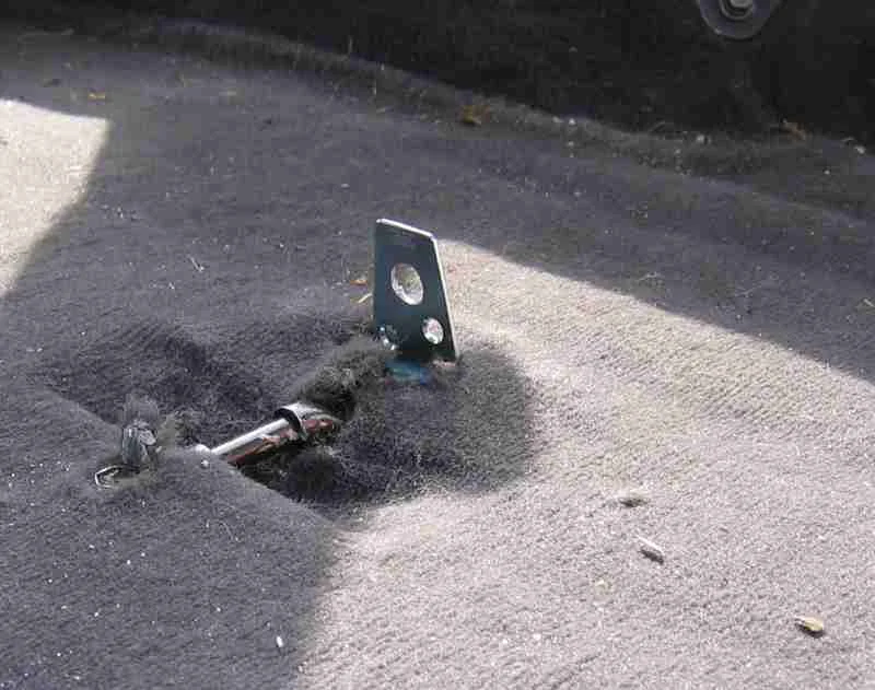

I decided to make use of the OEM cargo hook which flips up and then can be flipped back down out of the way. I added a second hinged flip up point to provide another point at the front of the bracket/stand. I needed to work around the 3rd set of seat belts because those do get used by the family once in a blue moon.

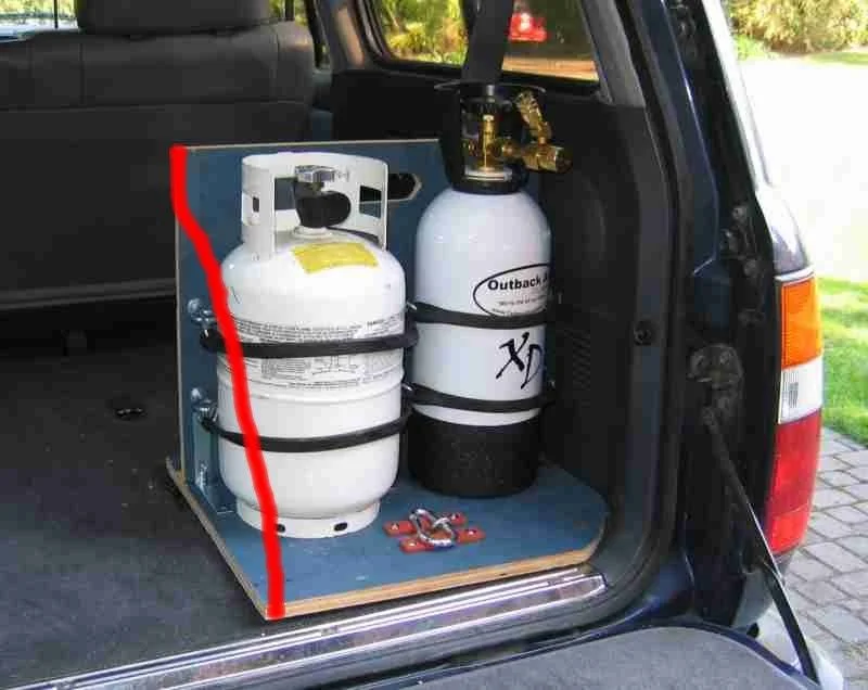

Here’s a pic of the wood base of the bracket stand. You can see the slots cut out for the flip up hinges (cargo ties) and also the notch cut out for the seat belt strap. The hinge is also shown with an a couple of extra large holes and cut down to size.
I made a wood back plate and secured it with a 5 L type braces. For extra strength I should remove the wood screws and use bolts. The wood screws are likely the weak point at the moment.
I used I bolts for the strap points for the tanks. I might modify/improve by removing the cargo straps and I bolts and use standard metal tank brackets when I find some that are the right size and for not too much money.
Here’s the final solution with tanks and straps and all. I know I should beef it up some more and probably supply a few more tie points but that’s it for now. It holds things pretty secure all things considered.
That's a pretty clean setup given the time. As long as the back support and base support is strong enough, I'd say you're in the clear (give it a few kicks).
Riley, Looks like a pretty good set-up but I'm worried about the rubber straps holding the bottles. I've had rubber straps stretch and give in an impact. I would use nylon ratchet straps. I would also think about adding a diagonal support, from each corner. This could be as simple as a small cable atached to eye bolts, or small chain, or even a piece of 1/2" conduit, flattened at each end on a 45 angle, screwed to the boards. A diagonal will add a huge amount of strength. My last sugestion is to have at least two floor mounts.

Thanks Bryan. I was thinking about the diagonal support as well. I'll look into that tomorrow.
And there are two floor mounts, you can only see one of them from the rear. I should probably add another but it means drilling holes in the floor.
I agree I'd like to improve on the straps. On impact there isn't any force on the straps as the force is on the back plate. However in a roll-over situation, they could be a problem. I'm gonna keep looking for a fire ext. bracket or perhaps order Christo's tank bracket and fasten it to my bracket.
I'll take a look at some racket straps too. Good idea.

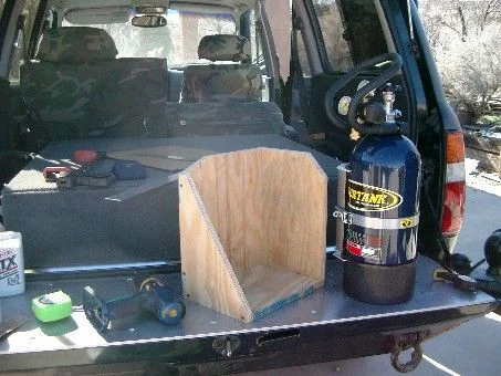

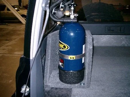

Riley, I understand that even moderate speed collisions can result in G forces from 30 - 50 G's. To test your setup, fasten it to a vertical surface with the "back" horizontal and attempt to place 30 - 50 times the filled weight of the two tanks.
I suggest you take another piece of plywood and make a side panel in the shape of a triangle. Something along the line of the lower photo.

Thanks Dan, again I'm thinking same thing. Nice job BTW. Where does your "box" fasten to the truck?

With the objective of improving the strength, Riley's set up, at a minimum, really should have two side panels.
To maximize the strength, within the constraint of continuing to use plywood, I would suggest for both Riley's and Dan's that metal angle, through bolted, run the length of each joint, both internal and external.
Mine is 3/4 inch and glued and screwed and bolted all over the place. I am OK with it. It does not move and is certainly as strong as the strap that retains the tank to the commercial bracket.
Riley, have you looked to see what it would take to mount metal straps, such as Dan has used, directly to the body side, one tank in each rear corner? From just eyeballing Dan's picture, I would suggest two straps per tank. You would need to see if appropriately strong body structure exists for mounting the straps. Otherwise you still have a fabrication problem to deal with.

Yep 2 side brackets and I was just deciding how to secure them. I was thinking of picking up some angle and flat steel and bolting it through. That should be pretty strong.
Then there's the OEM cargo loop that I'm using as one of the points to fasten it. I'm not sure how strong it is. I've got another tie point at the 3rd row seat bolt as well.

In terms of mounting anything to the floor, you would perhaps be better off directly bolting to the captured nuts of either the tie downs or the seat mounts, than using the cargo tie down loops.

Mine is anchored to the third row mounting captive points on the wheelhouse and to the top of the drawer box (which is bolted to the captive nuts that normally fasten the third row floor anchors.

Don't toss your work out the window yet. The location does not leave much of a place for the bottles to go backwards before they would hit the tail gate. What do you plan to have in front of them? a bunch of other stuff, like tent, sleeping bags, duffles, etc between the rear seat back and the "box" will serve to further restrain it. At what point do you stop protecting yourself? When you have a huge "pillow" surrounding the entire vehicle?
