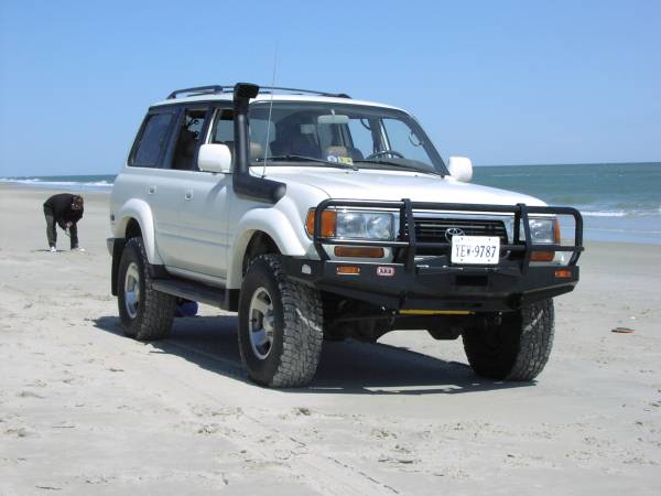

The OME lift was my first modification. I wanted the heavy 850's or the "J" springs at first but after putting together a realistic timeline on future mods such as sliders, ARB front bumper,winch, and slee rear bumper (aprox. $4500 total cost) I realized that it would be years before I would need the heavy springs. So I followed Sleeoffroad's advice and got the 851 medium springs and have been thrilled with my decision. The truck rides firmer than stock but not at all harsh, it did have a slight rake but not bad until I put the front bumper on. After the ARB it became very pronounced so I installed the Mr. Gasket 1" spacers up front and the truck now sits level. Christo's comment on the rake (like all his advice) is dead on. If you look at the attached pic you will notice a slight droop in the rear as I had some gear and coolers in the back, not too bad though as the OME springs have a higher capacity than stock. I just recently went on vacation with the wife and 3 kids and had her loaded to the max including the roof rack, drove 1000 miles at freeway speeds (65-75 mph) with absolutely no problem and even did some offroading in the loaded condition. The suspension worked great even under load. The castor correction will be your biggest obstacle but an absolute must. I drove the truck without it for 3 mos. It felt different at speed but not too bad (tended to wander at times) for the most part. However one day on the Washington beltway during a series of events that required multiple driver actions in rapid succesion to avoid an accident the lack of castor correction became very obvious and dangerous. With it the truck drives like stock. I have 295/75/16 Nitto Terre Grapplers on all 4 corners . After 25K they are holding up well and no rubbing that I have encountered. I am happy with my spring choice for now, instead of heavier springs in the future I am looking into the Slee 6" lift, 4.88's, and running even bigger tires when the truck will not be doing daily driver duties any longer.

Notice I was really tail low with the rear bumper on the 170K original springs. Now I am a *little* nose high if anything, but that should change with my front bumper and winch :D (whenever THAT happens :rolleyes: )
