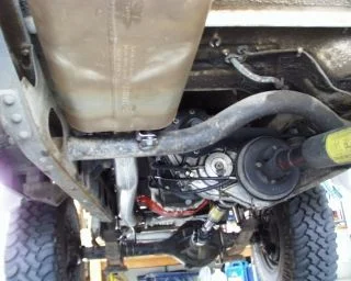

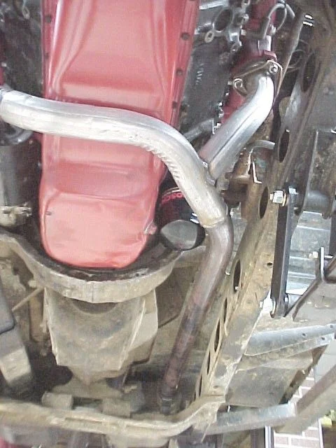

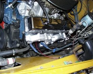

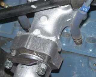

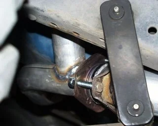

Here's what lots of 40's have, mine included: Cheers! (1st pic is not mine...rest are)
Few more shots..... These may work for you....system is 2" from Ramshorns to crossover joint, then 2.5" the rest of the way out. For most situations, this is sufficient, I don't mud bog or need high rpm acceleration, just good midrange and low end. I like it very much for my needs. YMMV. :)

Not headers, just good old cast iron manifolds from the boneyard...I installed two passenger side units so I wouldn't have interference with my PS pump mount. You can also find them on ebay for cheap if you don't want the 2.5" units.. Cheers

Your really not going to see much advantage over 2.o with 2.5, the only difference is that the 2.5 has that bracket that gets in the way.
