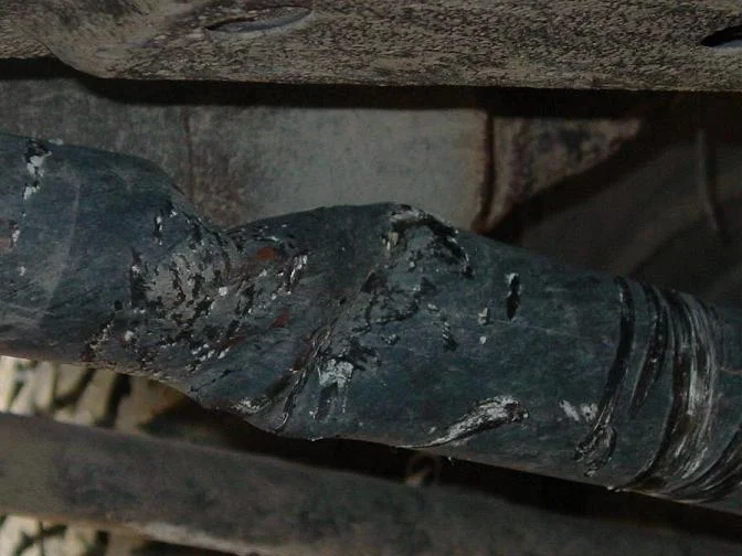

Oh...and BTW. If you see that the diagnosis was correct and need a new/used driveline. I'm more than likely going to be upgrading mine to one built with a CV joint. I retubed mine less than 1k miles ago to a thicker wall and would be perfect if you're going to start wheeling your junk. You don't want this to happen to you.
