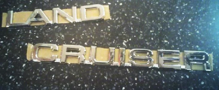

I'm replacing the black "Toyota Land Cruiser" liftgate emblem with chrome "Land Cruiser" lettering from a 100.
I posted in the 100 section a few days ago to find out where to get the emblems... Someone named "pint" pointed me to SOR. Nice guy.
Scored both emblems for $61, including S&H. Even came with a complimentary FJ Cruiser magazine and catalogue on CD. Sweet.
Now to make this tech, I'm
wondering how the hell I should get the old emblem off *without* breaking it. I've read a few threads that suggest dental floss or fishing line for the smaller emblems (4WD, etc...), but I'm doubtful that this will work for the big black 2-foot-wide emblem. Anyone had success with this?
Now for you nay-sayers, I'm doing this tomorrow. Your feeble attempts at persuading me otherwise are futile. :flipoff2:
Thoughts? comments? flame? I'll post 'before', 'during', and 'after' pics, just for you pic-whores out there, m-kay? Cool.
Emblems:
attachment.php
