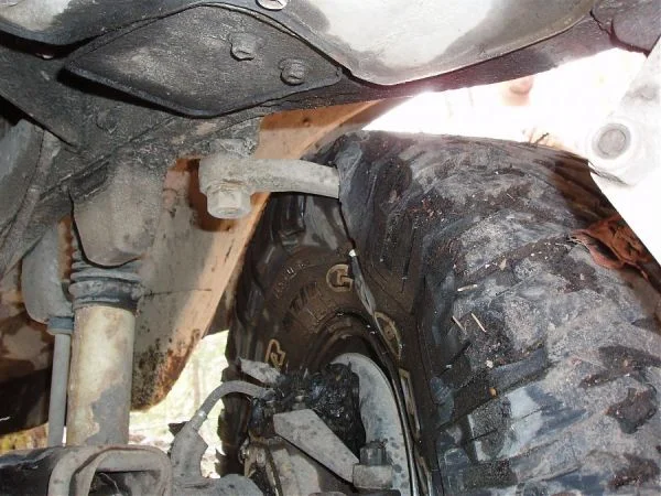

That steering mod got me home 9 hours away.Wasn't the most relaxing trip I have been on.That and the rear end went out on me also.By the time I got home there was about 3/8 inches of play in the pinion bearings.But she never left me yet.Heck, none of my cruisers have left me any where, knockin on wood.
What in the world happend with the steering? Did the TRE let go or was it the pitman or the box??? Man that looks rough. Any story behind the cruiser? How you got it, what got you into cruisers etc. ?

The steering mod: First trip out this april with the front locker.Wheeled all friday.Then towards the end of the day Saturday, I was backin up with the wheels turned and POOSH.Hopped on the cb and said to hold up I think I popped a bead.As you can see from the pic, it wasn't a bead.The rod had pulled out of the cup it rides in and let the pitman arm swing over into the tire and cuz I was backing up with the wheels turned, you see what happened.Limped off the trail useing bailing wire and 1 hose clamp.Drove to the hardware store doing like 5mph the whole way.This all happened up on Drummond island at Turtle Ridge offraod park.The traffic up there is almost non existence so it was all that.Walked around the store lookin for a way to fix it and this is what I came up with.It held up really well.Didn't make any sharp corners on the way home and stopped and checked on it alot.After I made it into town and was close to the barn and did jack it up and turned the wheels just to see what I did have available.I wasn't really that bad.More or less full turn.Needless to say, I still carry that chain as part of my spares.
How'd that fail?
When I took it apart, the cups inside, the corners had busted off.They are part #53 in the pic.
I'm sure it was years of use and abuse and neglect.
