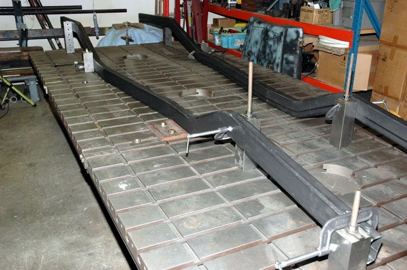

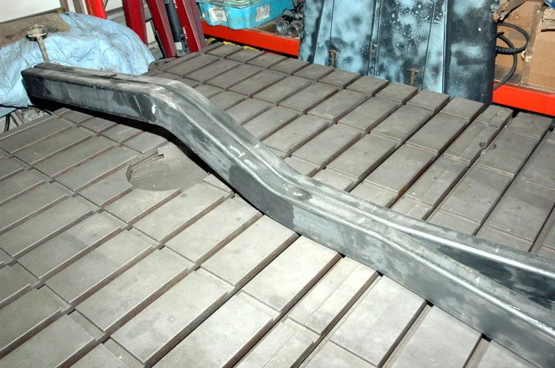

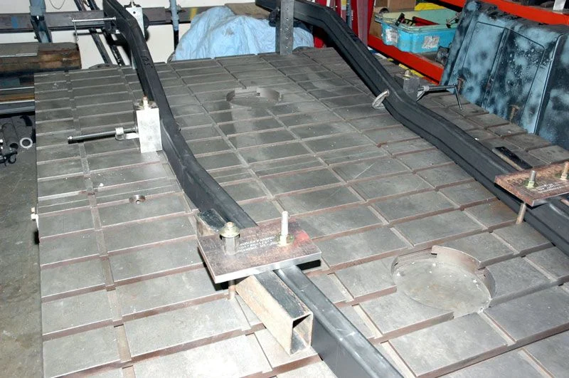

Jeremy at 'Throttle Down Kustoms' built mandrel-bent frame rails per my dimensions. He is a stand up guy and great to work with. The rails were spot on perfect:).

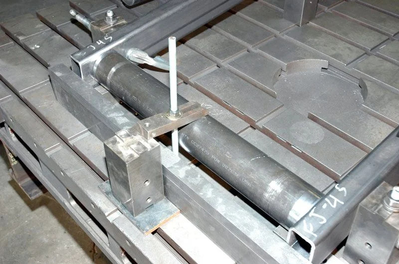

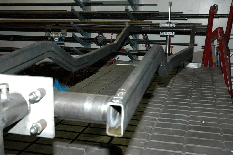

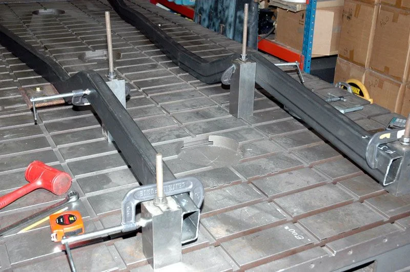

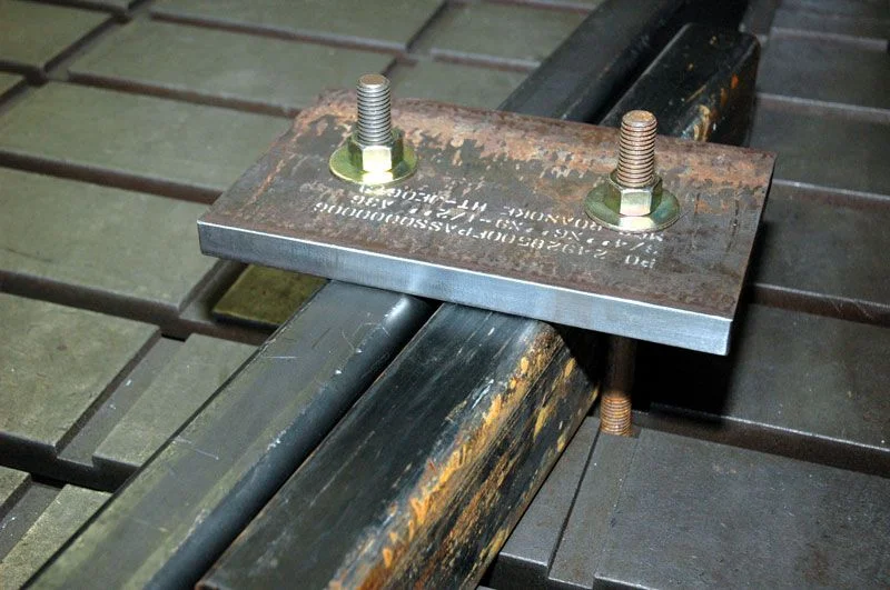

We are starting mockup now. We built the frame table it is on...it weighs 12K lbs, laser leveled and is 13.5' long. We are using tie-down blocks to square the rails to each other and make sure they are true. Everything gets clamped and triple checked. When it was finished, we were within 1/16" as far as we could tell in all directions of being pefectly square.
more
again
The rails are 2" X 4" X .188" in case ayone was wondering.

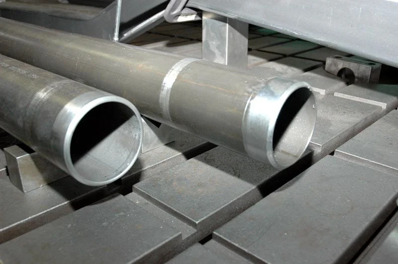

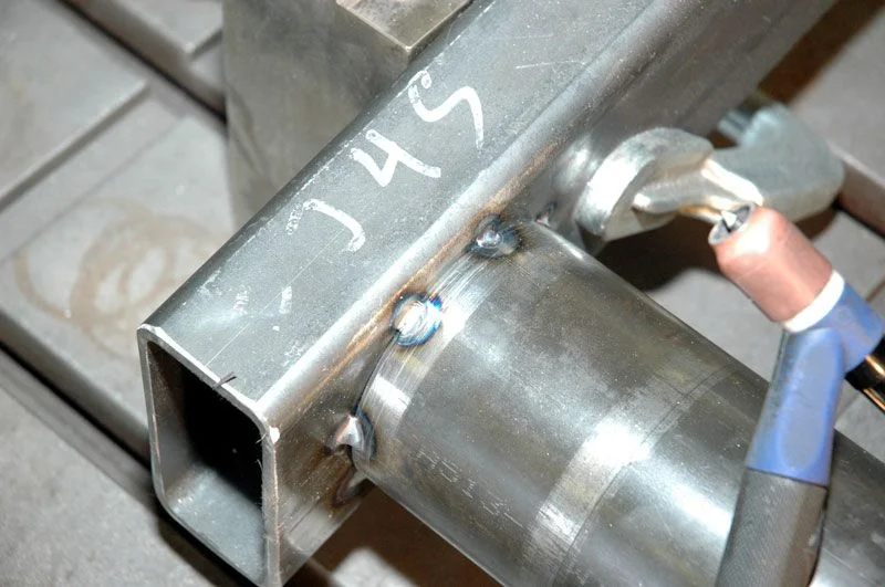

These are the front and rear crossmembers, 3.5" x .188" wall DOM...machined square and beveled for welding.
Larry
this is gonna be fun..............
Jigged up
Another jig shot of front crossmember.
More:)
Looks fun!!! What are the goals and intended uses of this truck? It is already looking heavy, so I am thinking that you are not building a hard-core trail rig.

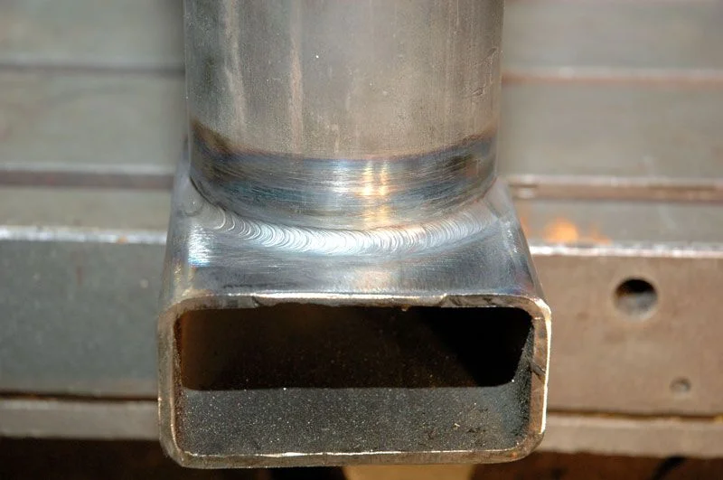

Fully TIG'd crossmembers.......
Frame mounted on rotisserie that we made for chassis table. It spins with 2 fingers:)... Should make welding a lot easier for me...I am too old to be laying on my back on a steel plate...hehehe
