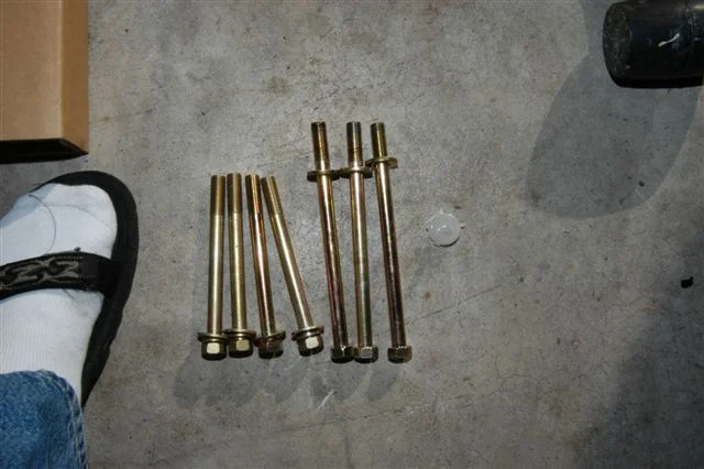

Gulf nailed it above, and Kevin clarified count and position.
To recap:
Use bolts from a post 5/85 FJ60
or
Order Toyota:
4 #90119-12047 & 3 #90119-12235
or
Aftermarket:
4 @ 12mm x 1.25 x 125mm & 3 @ 12mm x 1.25 x 170mm
Mitch
Pic for clarification, bolts are arranged as they would be in the case.
Short long bolts are 5" to the underside of the head.
Long long bolts are 6 3/4" to the underside of the head.
