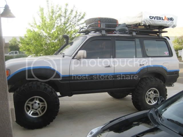

I almost like the terrible colors... :grinpimp:

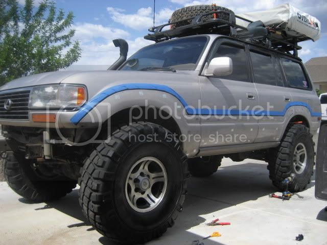

The metal tape makes life a lot easier...
The brackets on the back doors were a huge PITA even trying to drill them out.
What are you going to use? Durabak?
Does the metal tape help the liner adhere?
thanks.
The metal tape covers the holes after the flares are removed.
There are like 50 oval, round, and square holes left after all the mounting tabs are removed.

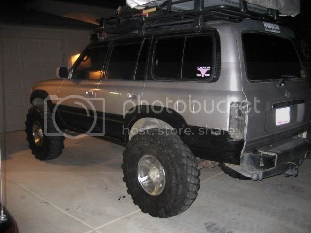

Coat #1.....weeeeeeee
(Sidenote: Why did I not wear gloves? :crybaby: )
Are those black spots all over the driveway? If so, consider doing the next phase in the front yard. :D
-Spike
haha, no drip spots... I do have a lot of tire marks on the driveway, but they always disappear when it rains or I spray down the driveway with the pressure washer.

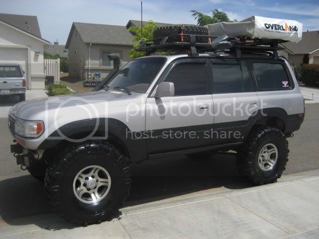

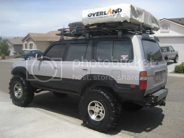

Just finished 3 coats and removed the tape. A few tiny places to clean up in the corners but I like the look so far.
I like it. I would love to see a picture in the daytime from the angle of post #10.
TR
ps Can't wait to put on my Lexus Trail Team sticker as well:grinpimp:

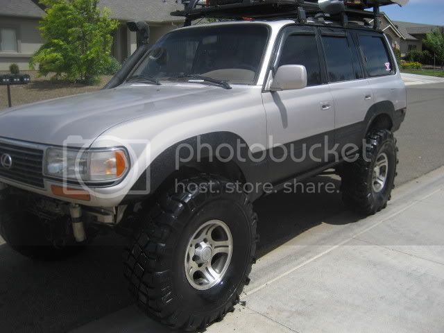

I let it all dry overnight.
I was a little worried since we are having some "Winds of DOOM!" out here in Northern AZ that there might be junk stuck in the liner. It was tacky like tar last night, but only 1 mosquito sized green bug that easily fell off.
The stuff is like rough sandpaper now, so I can just file down the bushes on the trails. :P
